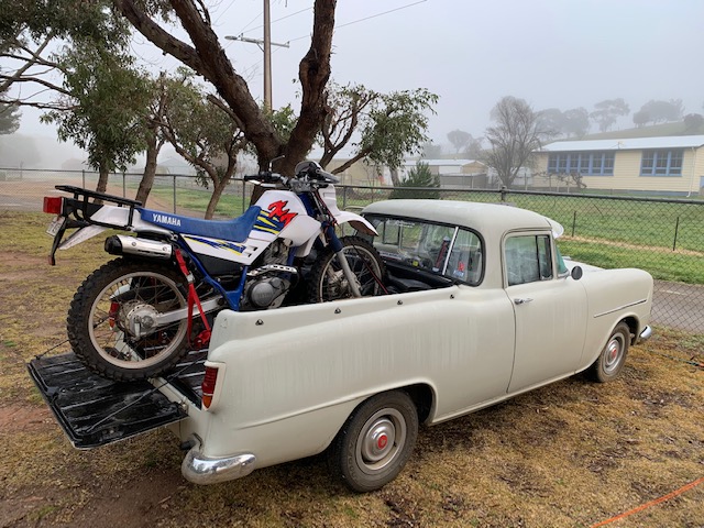

Evidence of life - an update pic for anyone wondering what me and the Ute have been up to lately

Good to see you have the ute out and about. These Utes come in handy for hauling bikes!
Are the two Trumpys built up specials or originals (54 pre unit) and the later one unit construction? Got any pics? What is the bike in the back of your ute, looks like a Yamaha 250 tank?

Yeah I do wish the EK tray was a bit longer... Police take a very dim view of the tailgate being down here in Sydney. It’s all about speed cameras not seeing the number plate (read: revenue raising)
That bike is just an old DT250 that I’m learning speedway on, owes me next to nothing. Hollowed out pipe & carb/jetting swap is all I’ve done performance wise, but that’s providing plenty of poke for this novice!
