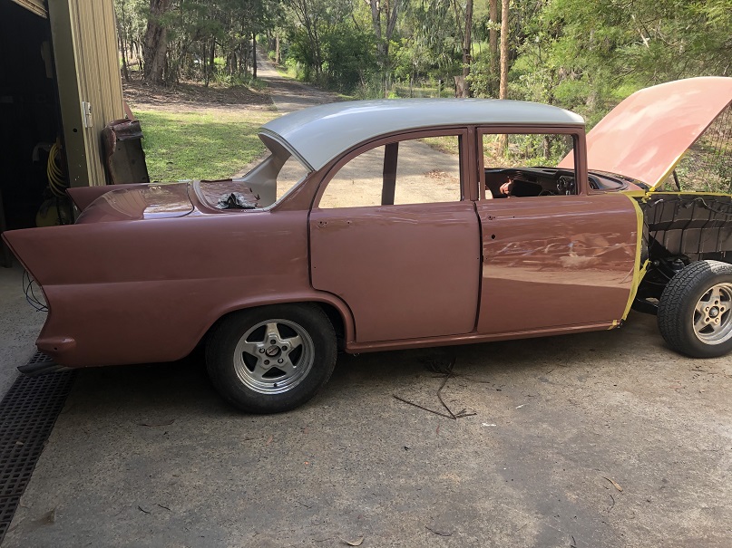

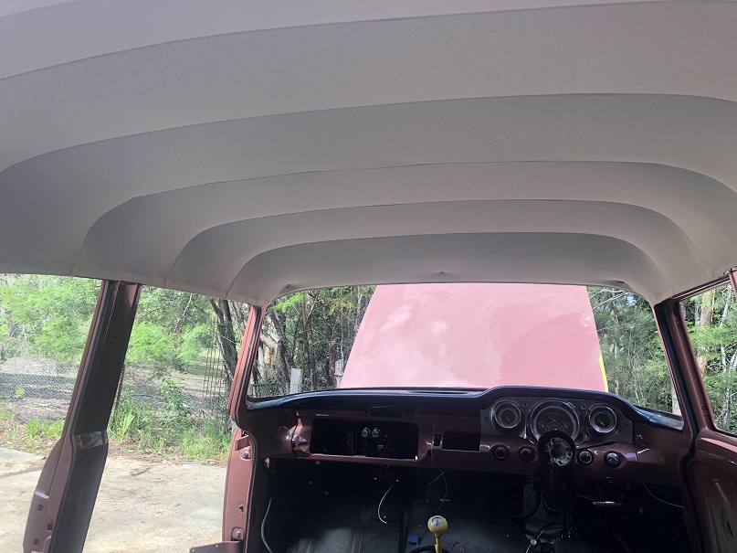

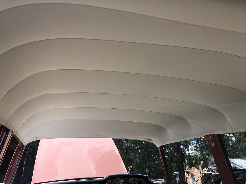

Busted a nut the last few days and am starting to see a bit of a result, car looking like a car again sort of.

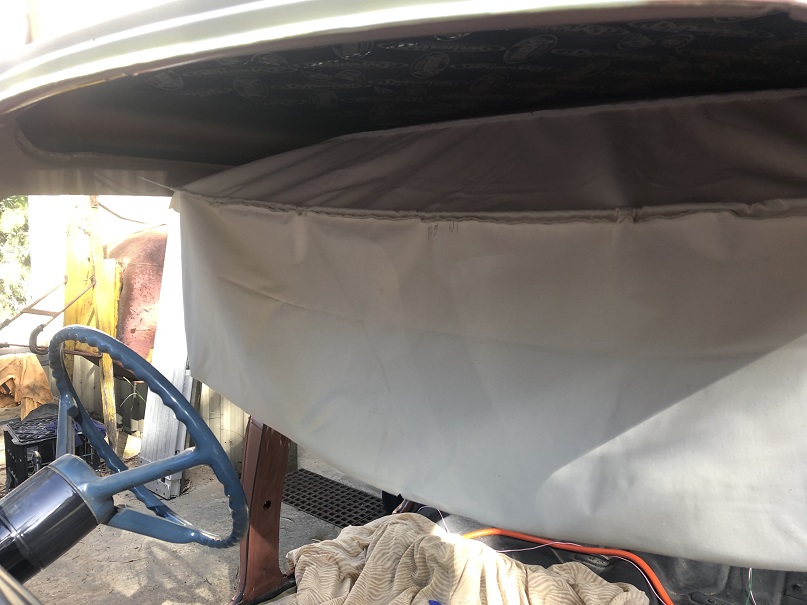

Headlining in, bugger of a job !!! A couple of wrinkles which should come out in time and its the best I could do considering.
Started wet sanding for a couple of hours, more door and guard work tomorrow !!!

Good progress. Those pipes look badass!

Looks great to me.. and yes, looking more and more like a car you can drive.
Don't fret about those wrinkles... you haven't fitted the trim yet - they will pull a bit more out of them....
I have been led to believe that using a hair-dryer carefully will "shrink" the material..... there have been posts on this somewhere in this forum, fair while back, from memory.
Agree with those pipes - the bumper of an FB/EK really lends itself well to having them where you have fitted them... they will look even greater with the bumper fitted.... make sure they extend beyond the open face of the bumper (looks like they will)... the over-riders will allow you to go at least that far back. From memory, the bumper has to be the rear most point of the vehicle.. may be different in each state, though...
Keep going - we are all going to have plenty of time on our hands before much longer... guess, we are the fortunate ones - we have something to keep us occupied... pity those who go to the footy as a hobby... oh well, at least they are playing... so far...

by FJWALLY
Get yourself a little karcher steamer - they are perfect for that - some clothes irons can be used the same as well - it really makes a big difference to go over the lot with a steamer - it relaxes and sets the fabric if that makes sense - we use them al the time in textiles retailing.

Thanks for the comments guys, will try the steaming on the headlining if it doesn't settle in the next week or two.

let the headliner hang where it is for now, heat gun only on a headliner, nothing else.

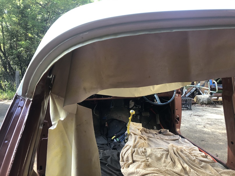

More done,
Headliner is coming good !!
Put some of the interior trim in looks ok.

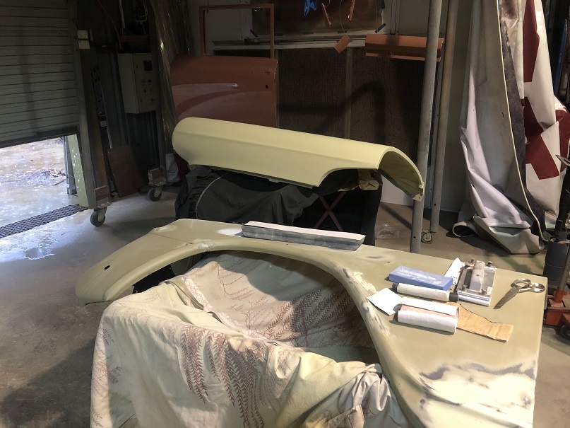

Painted the front passenger door and its got shit in it everywhere, Just had one of those days !!! All the wind has blown all sorts of stuff onto the roof of my spray area, as soon as i turn it on dust gets sucked in and across the paint. I'll have to clean it before anymore painting goes on. The door is straight but I'll have to do it again, oh well what can you do !!!

Has to be done, Greg.... that would drive me nuts if I didn't rub it back and respray it.... nuisance, yes - but it won't happen again.
If it is of any help, if I'm spraying on a concrete floor - I sweep out, blow out and then throw a couple of buckets of water across the surface of the floor... just before I spray. The water tends to attract and hold heavy airborne dust that gets thrown up with the air from the gun... it comes out of anywhere... unless you have a sealed booth - there is never a guarantee that you won't get dust in the air.
We're a bit lucky with acrylic - it dries pretty darned quickly..... 2K is a nightmare - seems to take yonks before the paint stops being a magnet for anything attracted to it...
The openings in the apex of your roof are a trap for crap like that too.. one gust of wind and stuff which has been up there for years can break away...
I fitted rolled up insect screen to the openings under the metal cover sheet in my shed.... stops a lot of tree crap getting into the shed...
Door, glovebox, quarter vent covers and ashtray all look pretty darned good to me.. but, I'm not 2' away from them... I feel your pain, but - it's just a nuisance - not a biggie...... like dropping a door onto the ground....

Two forward and one back Greg. It’s practically a given formula as you know. Progress!
Professional panel beater advised me to do final coats outside in the carport with a light breeze to avoid fall out in my shed. When the wind is blowing away from the neighbours of course.

Hmmmm, Clay - not what I have done. I have left about 1' off the "lee" side roller door open and 2' of the windward one open...
This prevents a rush of air coming into the garage, but seems to vent out the paint mist effectively from the exit....
You can never get enough dust out of a garage - it's a case of trying to avoid upsetting what is already in there.... feet on the floor are probably the biggest offenders.... floor clean and "just" wet = best chance to avoid that...... as for the rest - good luck... there are dust "mines" waiting everywhere.
Issue I see with spraying outdoors is insects.... the pesky little critters just love sitting on, then into fresh paint.. and they squirm around until they can no longer move, or die.....

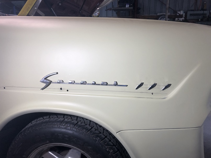

So after some investigation I have found that the stuff in my paint is not dust at all but a problem with the humidity and the way iso's in the paint react with moisture.
Its called iso clumping and its the hardener setting in mid flight due to moisture in the air. Bloody hell ???
So no more painting in high humidity.

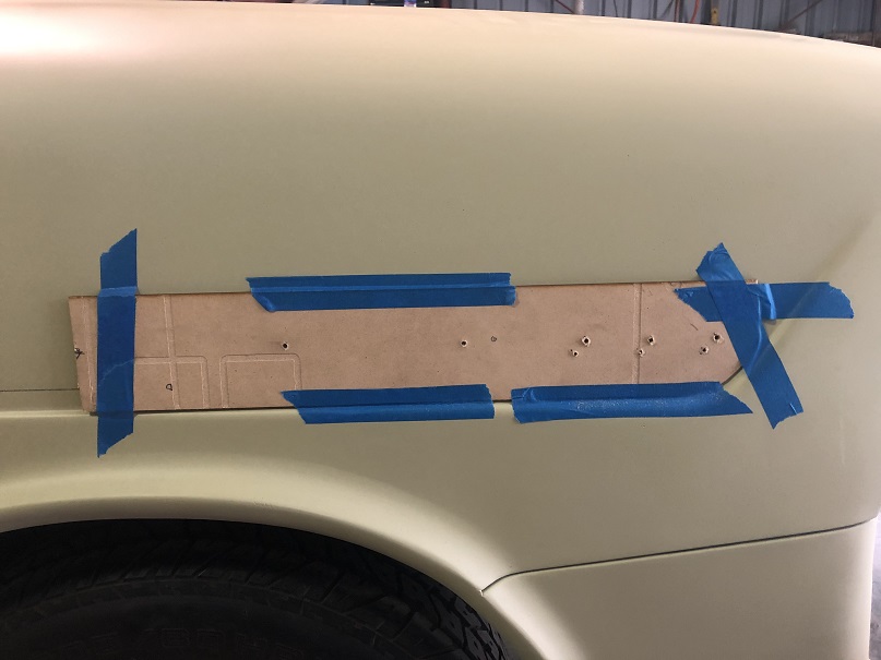

So on to some trivial jobs. Tip number 967 Its a good idea to remember the holes in the front guards are different between sedans and commercials especially when your mint guard is off a ute and your putting in on a sedan!!!!!
If I can get any mouldings for the front guards they will hide the holes from the commercial type strips !!!!! I don't want to start welding at this stage.

Specials, the more common cars, Greg. My first EK was a 215 standard sedan which has the same spears as the commercials. FB are different again, and you know all this of course.

I was not aware that the mount holes for the two different spears also differ... grrrr - and no, I wouldn't want to go down the path of welding up the holes.... reo-filler is your friend... and seal it out on both sides.... hopefully, where it is applied will be behind the special spears.
