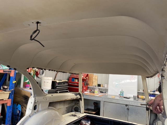

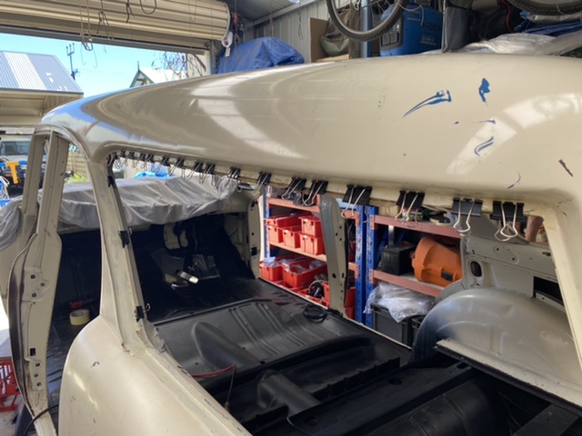

Bit of a good morning today, got the old hood lining fitted ina finished state.
I love it when people me it can’t be done haha!
Drew

nice work Drew - a few bulldog clips there :thumbsup:

Mate it looks the goods. Re-ftting a good used one and installing a new one are two different stories I'm told.

Installing a new wagon or ute one from Rares is painful. Another inch or so of fabric and it would be easy... there is enough there on the wagon (just) but the ute one was short across the bottom of the rear window.

Looks good Drew. I have to revisit Wilma's one day to get rid of some wrinkles.

Harv wrote: Thu Jan 13, 2022 3:59 pm Installing a new wagon or ute one from Rares is painful. Another inch or so of fabric and it would be easy... there is enough there on the wagon (just) but the ute one was short across the bottom of the rear window.
Why do they skimp on a little bit? The extra inch of fabric would add 2% to the cost and relieve 98% of frustration by the installer!

I think the pros stretch them a lot, get them very tight.

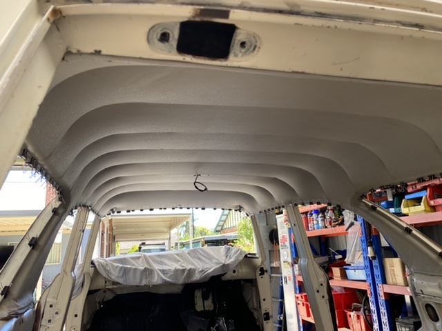

Installing this one was a long process, had the lining hanging for the last week though the heat and just gradually stretched it further each day hence all the bulldog clips.
To be honest some area were short but instead of wrapping the lining around the edges I glued the inside and made sure it was stuck good.
Either way it’s not coming off haha.

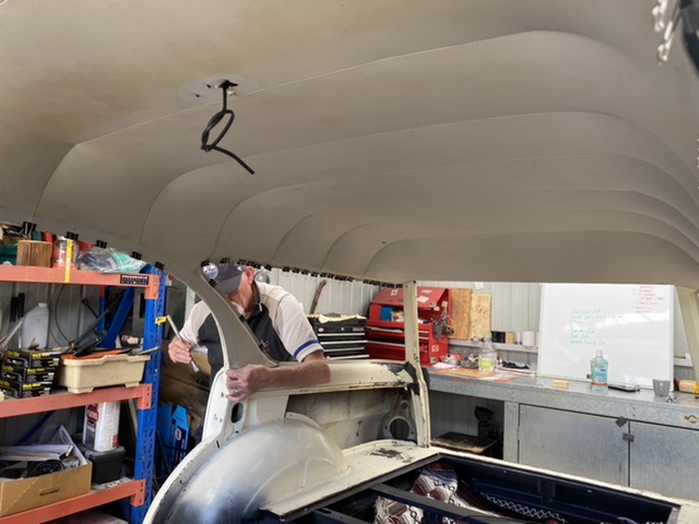

My mate helping me with the final bit is a retired trimmer so he managed to work the hair dryer in the places that didn’t want to play ball and it worked out even better than he even expected.
Drew

Can’t beat the random star pattern, specially in a wagon. You can look forward to sleeping “under the stars”.

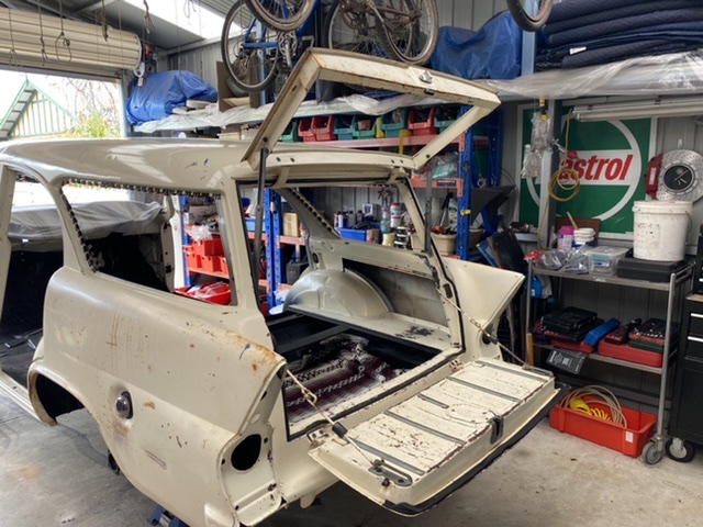

Here is a shout out to ‘In the Shed’ Stephen who helped me solder up my broken top tailgate struts.
The ends needed reinforcements and a mig was deemed too aggressive for the job.
Tailgate rubber and both tailgates now fitted, even managed to get the teenager in the shed for the arvo which was good!
A step in the right direction to get windows fitted on the weekend.
