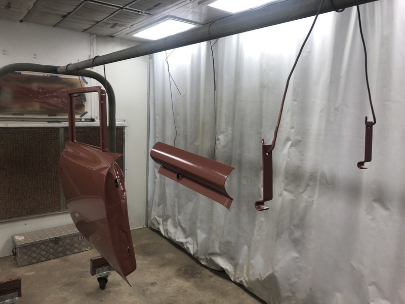

Headlight buckets have been blasted bare ready for some paint soon.
Got the colour on some bits and will continue tomorrow,
I experimented with some reducer today and it has really flattened out the orange peel, it will make polishing a little easier.

Posted: Thu Mar 12, 2020 1:45 pm
Yum. I’ve been using 10-20% reducer in my etch prime because that is what paint man and tds say to do.
Your hanging rig for the doors looks nice and sturdy.
