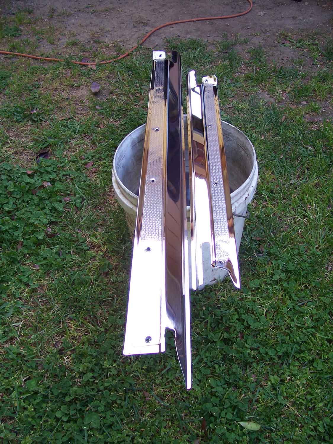

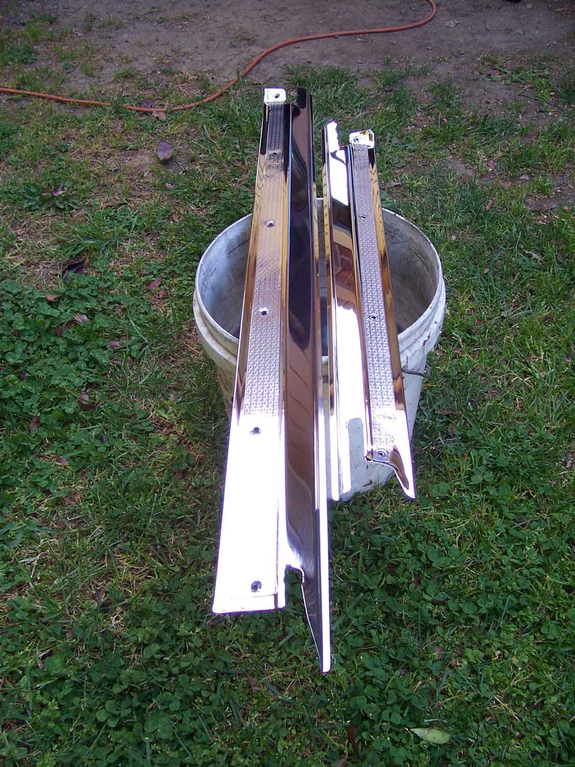

with the kind assistance of gpi.. I'm back - now can access my files.
Just to make sure this will work - I'll add a couple of pix below of my Crupi home polished scuff plates... with POR Glisten PC coated factory inserts (with the painted periwinkles ((sic))...)
scuff plates rhs 002 mail.jpg (203.56 KiB) Viewed 868 times

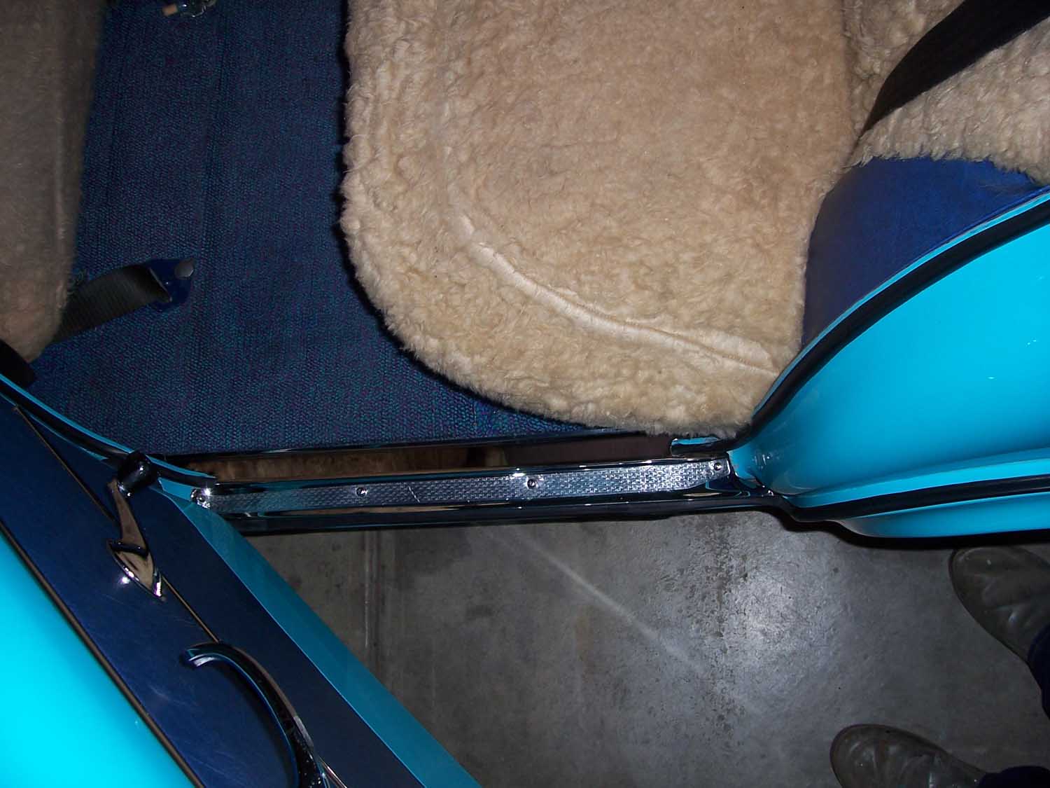

scuff rear lhs 001 mail.jpg (128.36 KiB) Viewed 868 times

Ooh, err..... bottom lip tremblingly pleasing to the eye. The inserts are precious indeed. This is inspiring Rosco.

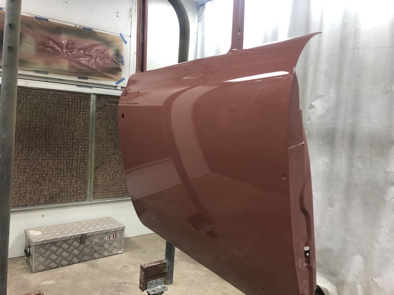

Re: Chev EK

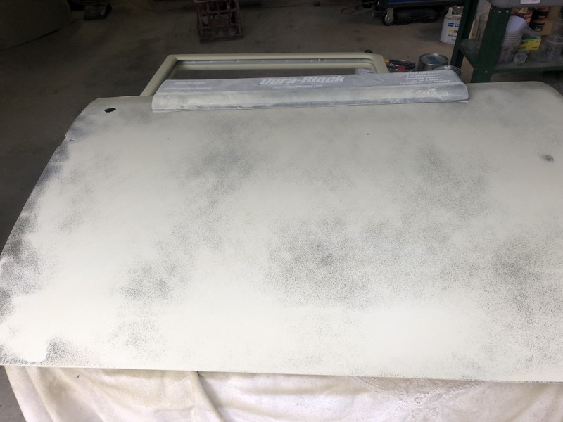

Stage 2 and much better this time around, in fact I rubbed the whole door and avoided any rub throughs.
This means some colour possibly tomorrow !!!

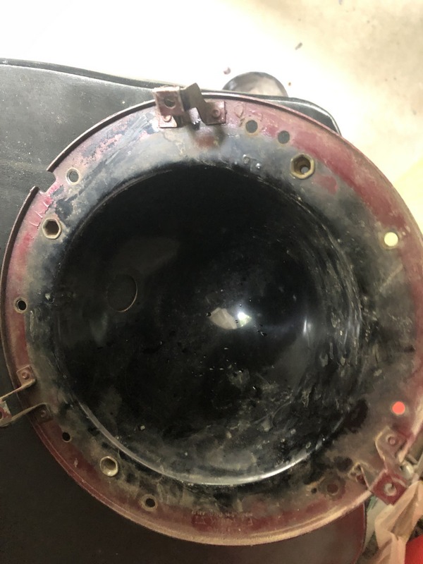

Guru question, I went to sandblast the headlight buckets and noticed the surface is quite hard, I was thinking they are ceramic coated due to heat from the light globes ?? Anyone have any ideas on that ????

Mine didn't like the wire wheel either. Agree they are pretty hard. Not sure about ceramic, but perhaps just well-cooked paint.
I settled for a good scuff-up and some epoxy enamel.

Further investigation has revealed its more than likely enamel, baked on the inside from the light heat most likely.
Bloody hard going even with the sand blaster !!! Inside is harder than the outside.

An old timer once told me - "if paint is stuck on that damned hard - why are you trying to take it off?..... you won't get a better undercoat than paint which is extremely difficult to move."
He suggested I just "key" it up and paint over the top... I did this with my headlamp bowls... used an enamel undercoat then Pacific Blue hammered metal epoxy enamel... probably won't see the light of day again...

Headlight buckets have been blasted bare ready for some paint soon.

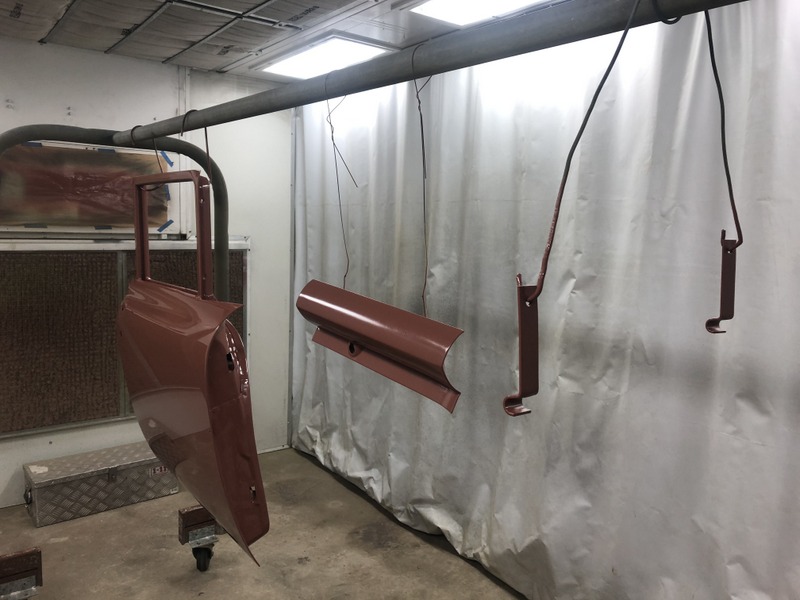

Got the colour on some bits and will continue tomorrow,
I experimented with some reducer today and it has really flattened out the orange peel, it will make polishing a little easier.

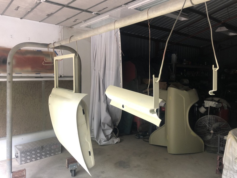

Posts: 11670
Re: Chev EK
Yum. I’ve been using 10-20% reducer in my etch prime because that is what paint man and tds say to do.
Your hanging rig for the doors looks nice and sturdy.
