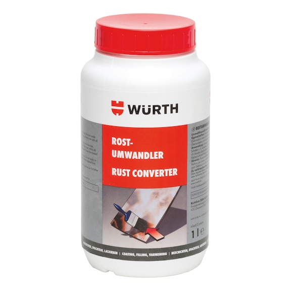

For those looking for a rust converter that you don't have to wash off and can paint over with 2k and acrylic, this Wurth product might be useful for you. It dries in about 3 hours and because it doesn't have to be washed off to neutralise, it is suitable for inside enclosed sections such as kframes, roof channels and pillars etc. Particularly useful for Project2. It's not cheap at $90 a litre, but that will do a lot of spots. I use it in a spray bottle and spray gun with long tube nozzle for box sections. POR15 sticks to it too. Metal goes dark blue and so does your skin if you get it on. Washes out in water.

Love the product endorsement Brett. Good to know when someone has had great success with a product. There was a K Frame painted with this too recently - Drew's build?

Thanks Brett. Sounds good.

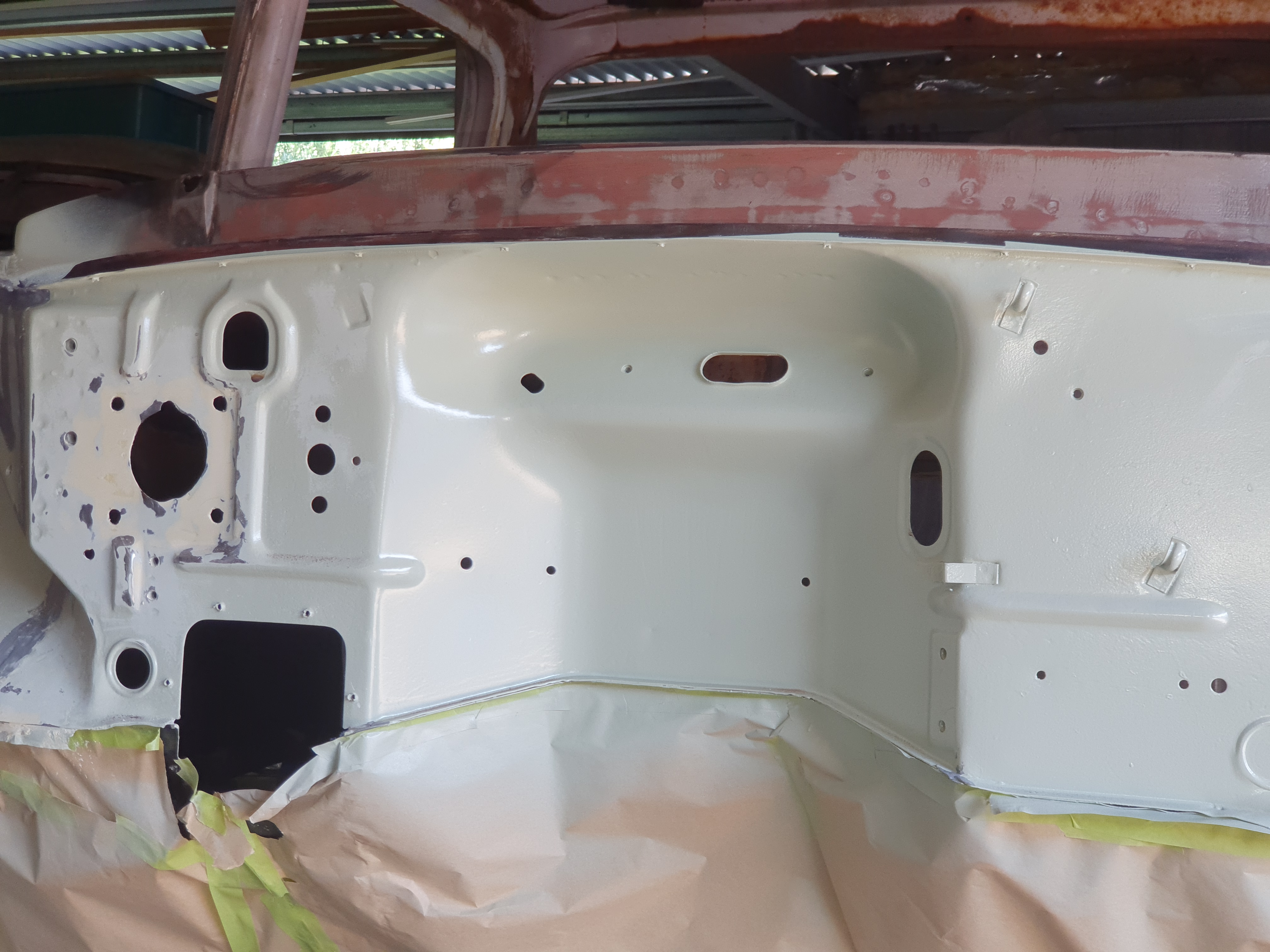

Another bit of rust bites the dust. Smoko in progressImageImageImage

Very neat Brett 👍

Thanks Stephen. Knock off nowImage. Firewall rust is now behind us. ImageImage

Posts: 2519
Re: Project 2.
Thanks Mark. Always feels good getting some primer on. If I was a professional I would wait and do it all in one go, but I'm not😁
Posts: 11633
Re: Project 2.
Good to seal it up. Bit too humid to paint here, with epoxy anyway.
funkyscooter
Posts: 708
Re: Project 2.
Post by funkyscooter »
Sure you've probably mentioned it, but what are you priming it with Brett?
Scott
Posts: 11633
Re: Project 2.
Looks like Epotec 408 green grey 2k epoxy etch to me
