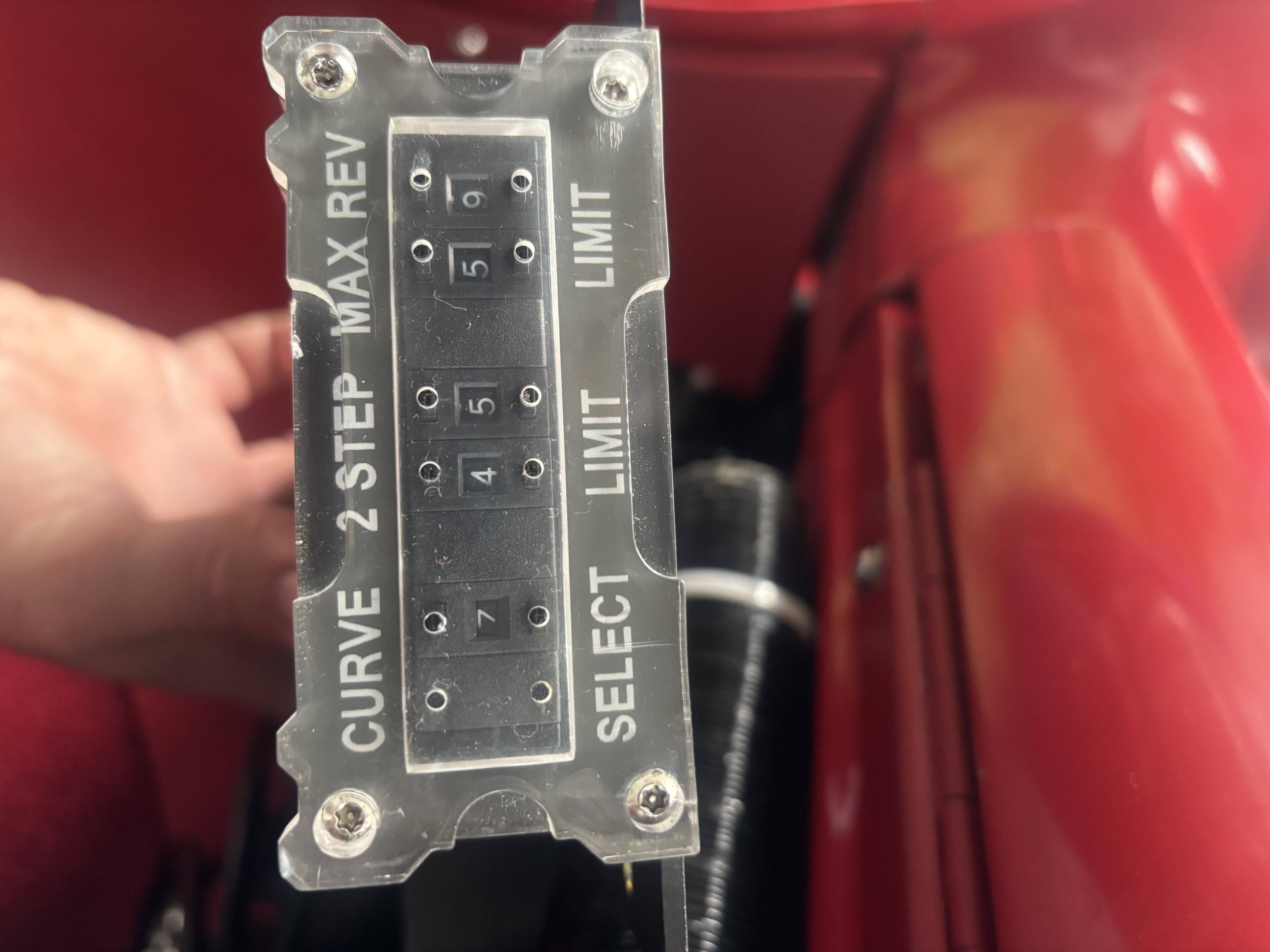

Managed to get the wagon out to the track last night. Bit of a trial run with the new ICE ignition, though it had been running ok around town. Good shakedown test for Day of the Drags Saturday.
Got three passes in. Was hoping for more, but a blue oval ute dropped coolant the whole length of the track, and a Bavarian taxi lost it off the start line, crossed lanes and love tapped the wall. Lots of down time for cleanup.
First pass was about 14.2, one second slow. Rev limiter kicking in at the top end. I forget where it was set, but I left it wherever ICE had it. Can’t get at the limiter adjuster without a socket, and stupid me did not bring one. Did not fancy fiddling under the dash by braille, especially with the most ignition curve adjuster next to it.
Second pass was better - hit the limiter, threw to third and ran better. Only 1/2 second off where it should be.
Third pass was slower. Anticipated the limiter, threw to third and it slumped off revs.

There’s the problem… 5900rpm limit. Two-step is not connected, so the 4500rpm limit is inactive.
Some adjustment for more spinny spinny…
