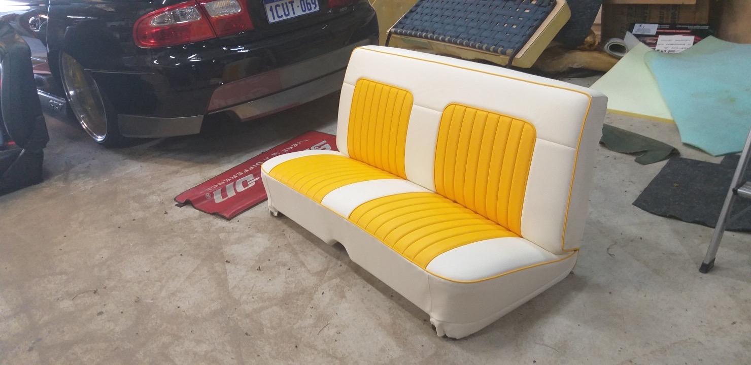

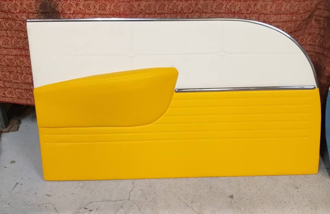

Ordered carpet the other day from Knox carpets on eBay.
Also Drew the trimmer sent me a couple of photos of my bench seat and door trim will pick them up later next week.
Re: Neils Frankenstein Ute
Posted: Sun Sep 01, 2019 11:39 am
I'm waaay too grotty to ever own white trim, but those door cards look stunning. Very neat job :thumbsup:
Posted: Sun Sep 01, 2019 11:59 am
by WesternWagon
Trim looks great, some tidy stitches there
Can’t wait to see her on the rd mate
Gazza
Posted: Sun Sep 01, 2019 12:53 pm
by 59wagon
Looks schmicko Neil
So you didn’t need a cutout for the gearstick - cool.
Cheers, John
Posted: Sun Sep 01, 2019 1:07 pm
Very nice Neil. Love the yellow piping. Don’t forget to take the scanners out of the back pocket of your greasy overalls before you get in the car mate.
