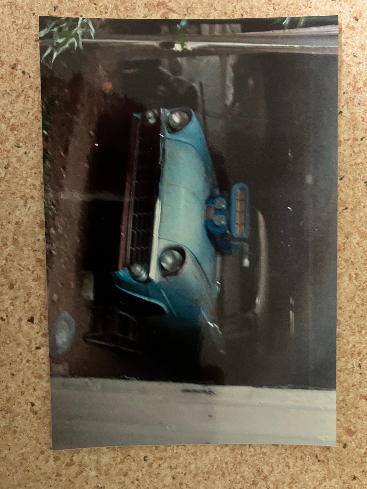

Dominator 2500. Nice for grocery getting, but about 1700rpm short of where it should be on the strip.
Mebbe it needs this put back on it again :mrgreen:
