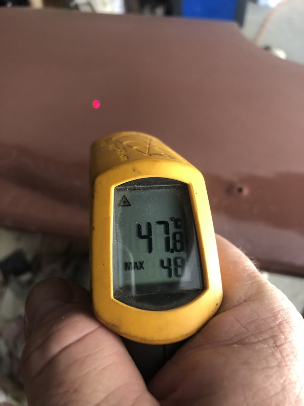

I cannot achieve greatness today its to hot !!!!!!!!!! Shed is trying to roast me.
I may try a night shift otherwise early start tomorrow.

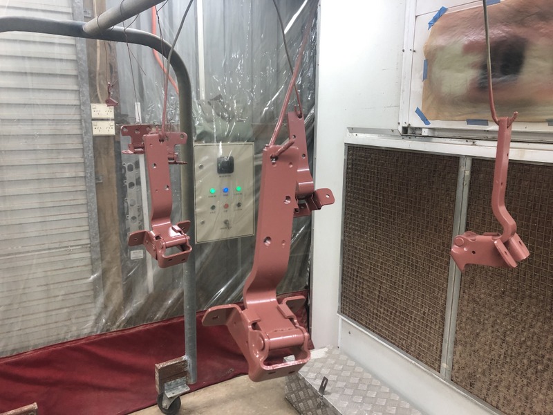

Well it all hinges on this !!!! A night shift done, cleaned and sandblasted all the door hinges.
Got up early to beat the heat and 2 hours later hinges done.
I cheated with the paint a little today, just a trick from a spray painter mate.
First epoxy
Then base coat with a touch of hardener, the base coat is urethane but normally no hardener is used because its sole purpose is colour with no strength. The hardener ties it into the epoxy
Last 3 coats of clear, with no sanding or mucking around and the hinges are done ready for install tomorrow.
So this is all done wet on wet meaning before the hardener fully cures, its a bit tricky because you have to let the solvents out between coats, this is referred to as flash off. Now I can put a door on and free up the panel stand for the next one.

Thanks Greg,
the hinges look amazing.
I have heard mention of this "wet on wet" between tradies when at a commercial supplier picking up paint.. I never knew what it meant, and the exchange was so quick between them that it was all I got... they obviously knew the process... and that simple exchange of just three words was enough.....
I now understand the process, thank you... it will save a lot of sanding and keying up... keeping the coats "fresh" so that they will bond - and possibly "fuse" for an almost solid "one coat" result, even though there are five or six wet coats of differing materials.

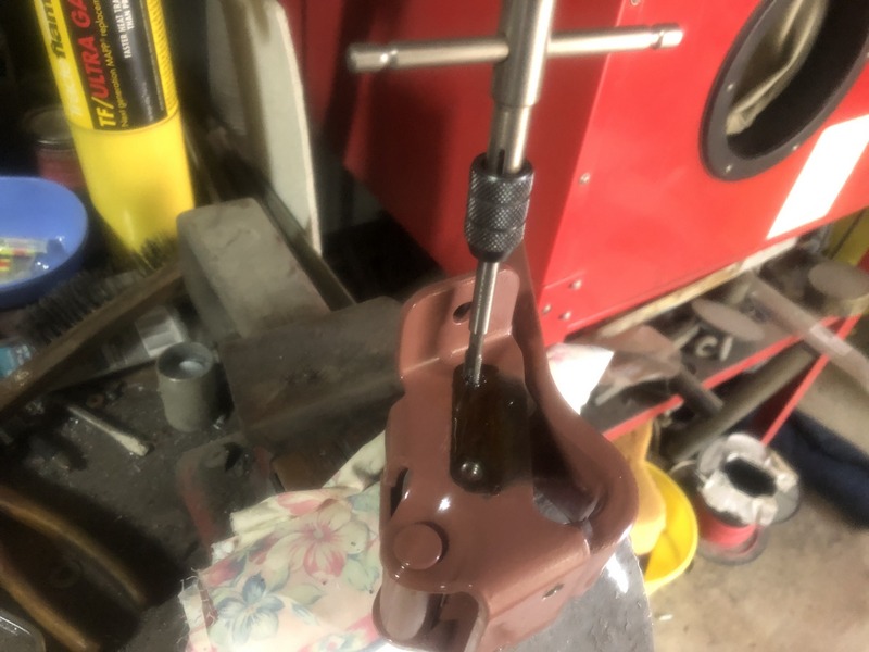

Crappy weekend, spent Saturday changing rear control arms and swaybar links on my Patrol with the intention of a big Sunday on the EK.
Ahhhhh no, lost power most of the day and had to watch the pelting rain from inside the house !!!!
All I could manage was a hinge repair / replacement of the spring clip, only found it when I went to install it of course !!!
Rivets from factory so I ground and punched them out and tapped the holes and used small head screws with locktite.
A bit boring really.

I think you get rivets with the kit which has put me off a bit. Looks easier with screws the way you’ve done it there. It is a pain when the door won’t stay open so console yourself.

I wouldn't say "boring" Greg......
Everything you post up is a gem in its own right.... might seem boring to you, but there is an audience out here who watch development with baited breath for the next episode....
Good work, are you going to etch and coat those screws to match?
