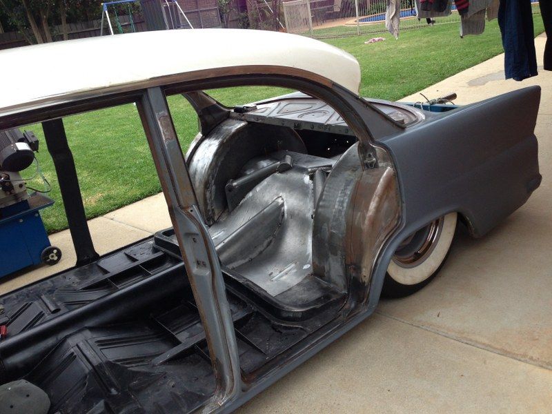

Cheers Marty!.. Yep, will have a rear seat. We've worked the floor & 4link specially. Took some figuring out but should have around 80% of a back rest on factor and plenty of ass pad. I'm also moving the parcel shelf fwd a couple of inches. Once it's all finished it shouldn't be too noticeable. The tubs look ginormous in the pic but they aren't too huge. I'm only running 255's on the rear, maybe 285's.

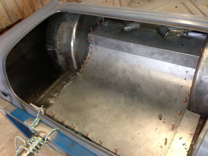

Only finicky type stuff man, I'll try get something up over the next few weeks. I've just been messing around fitting seat belt brackets, getting the rear floor ready (bought a cleco kit to hold it in temporarily - Worth their weight in gold those things) etc etc. I had to unstitch & remove the boot hinges to get the rear belts in, so a new set of those will need to be made now :roll: .... It doesn't end. There isn't much ek left.

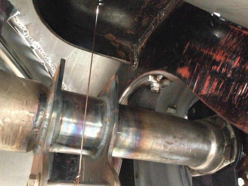

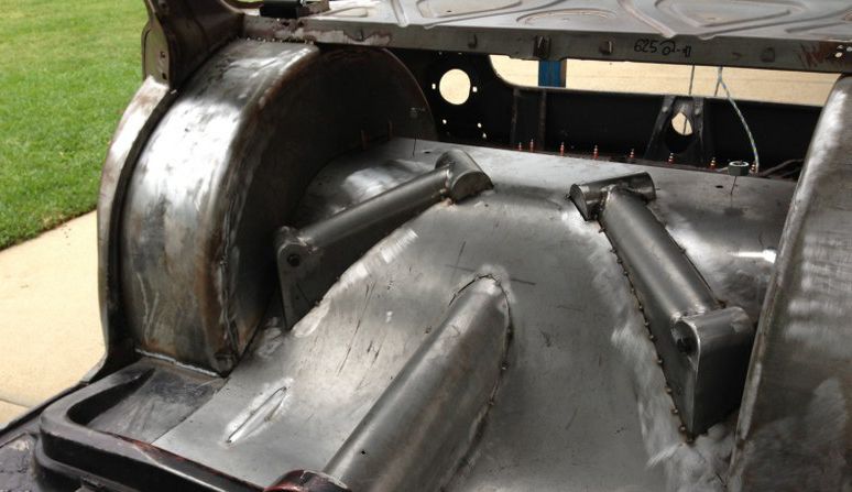

FInally got a bit more interesting stuff done over the last few days :wink:
We finished off the covers/notch pieces for the 4link and rear shaft & tacked em in.
The bump stop brackets are 6mm and 3mm plate. The 6mm plate will be welded to the rails - I didnt want to thread through them because I'm going to be running air & power in there. The bump stops I modifed and welded to the 3mm plate.
The exhaust was also going to run up through the floor & over the diff, but there is more than enough room so I think I'll run it under the diff now. It'll flow ace too - should be able to make it all from one straight length without having it look like crap, may have to notch the fuel tank to suit though :roll:
I've also just about finished making all the buckets and anchor points for the seat belts, but I forgot to take pics. Next time.
