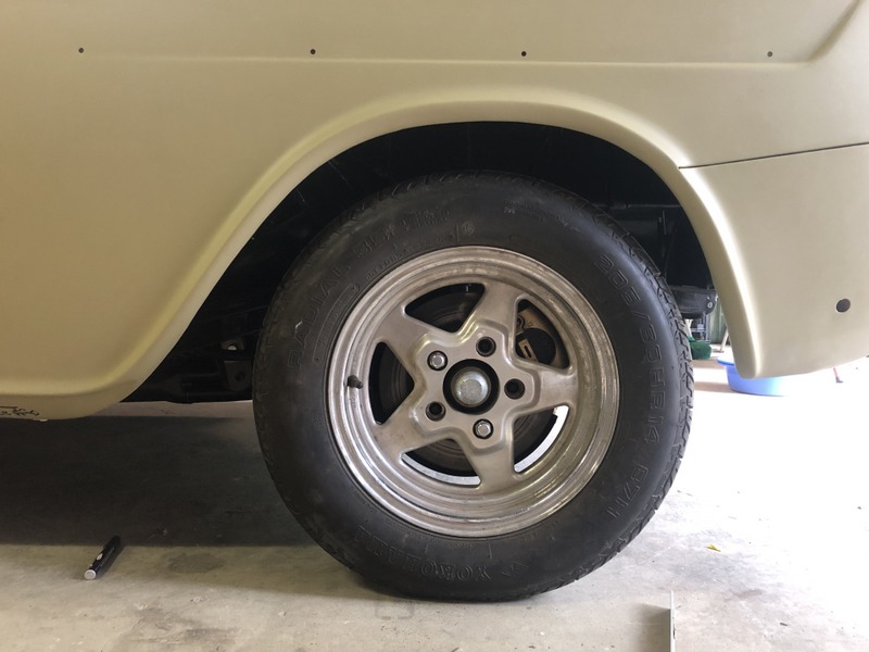

Bit more done in the last few days,
Painted some small bits and trialed fit the guard one more time before paint. Did the lip modification as well although I still have plenty of height.
Got the gasser look going although there is still lots to go back on. The back might need raising as I can't go much lower without rubbing something, we will see.
Starting to finally get some results, Car drives and is finished mechanically, been tempted to give it a power run but no I will resist Ha Ha Ha !!!!
