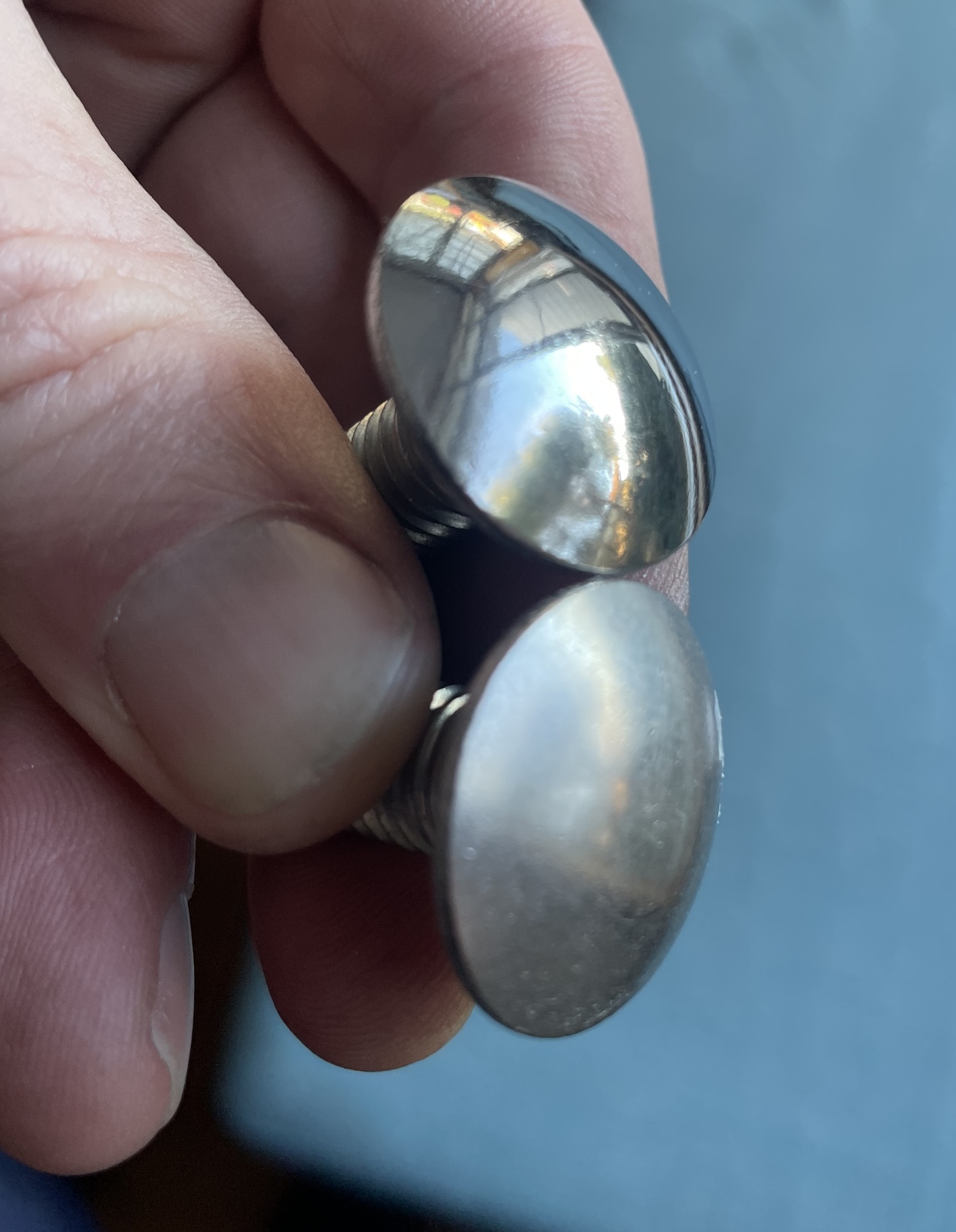

Been a minute. Tinkering away but not much going on. Just making stuff shiny with a new bench top polisher that I got to complemnt/replace the angle polisher set up I made which was pretty loud when running.
Bought some stainless coach bolts to replace the chrome ones in the bumpers. Getting imperial in stainless is next to impossible from where I have searched on the internet, so metric it is. M8 and M10 for the rears.
First polish - straight out of the packet at the bottom and polished holding the bolt precariously by hand
Second Attempt. Got smart and put the bolt in a drill. Results and pretty good, initial polish on the left, drill on the right. Take a couple of minutes per bolt.

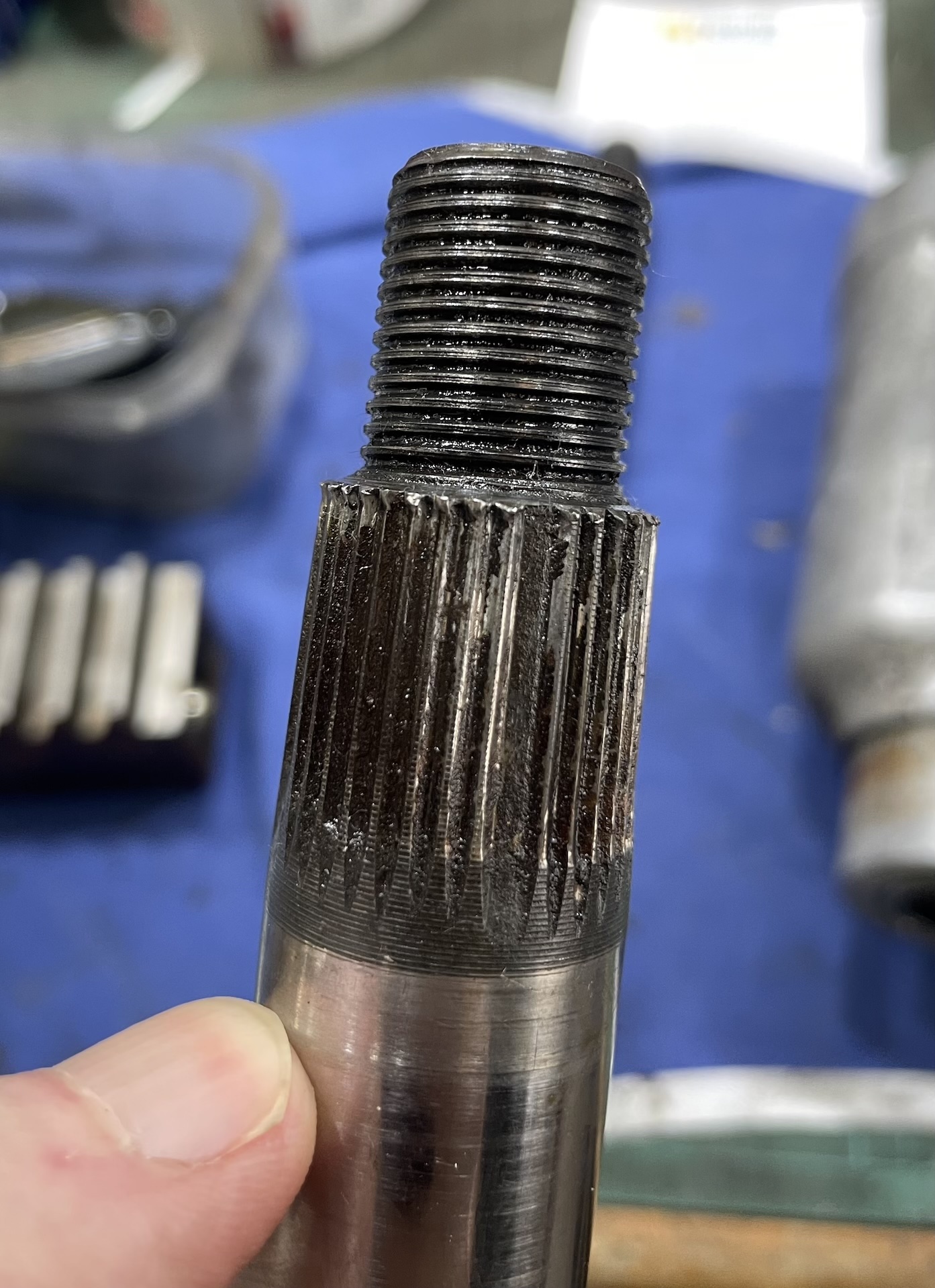

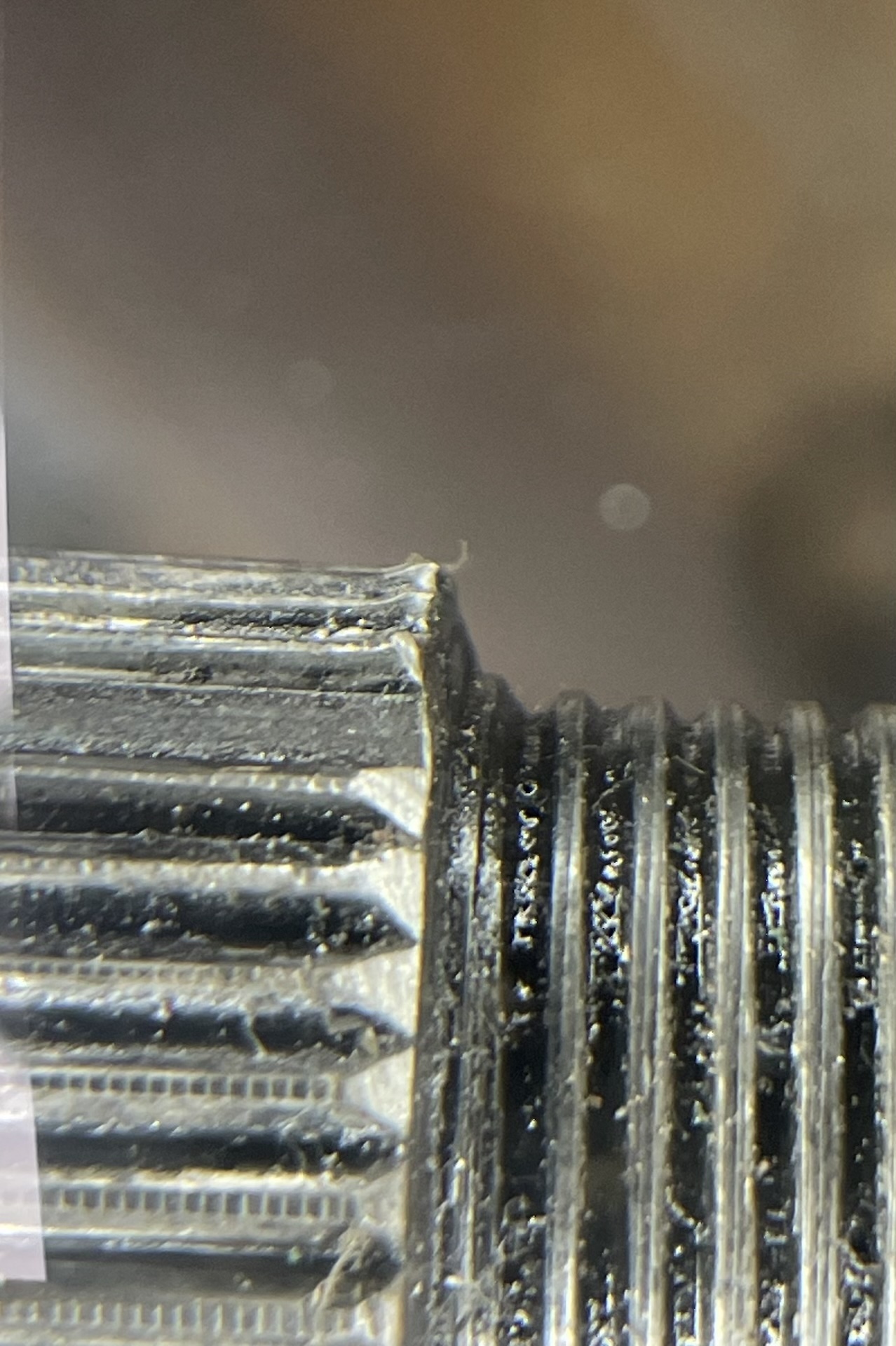

The ends of the splines on the shaft have been mashed a bit and are preventing the my pitman arm from fitting very well.
So out with the file for a quick chamfer.

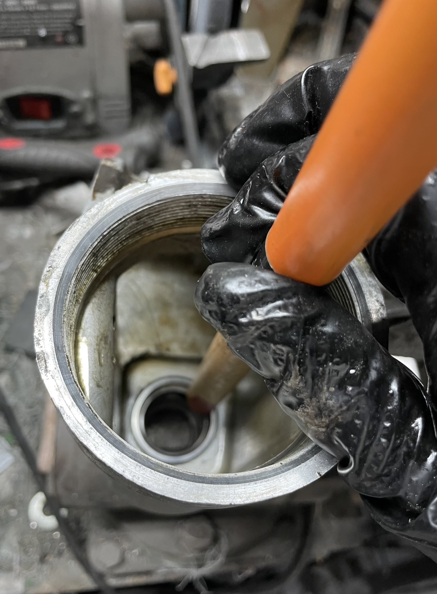

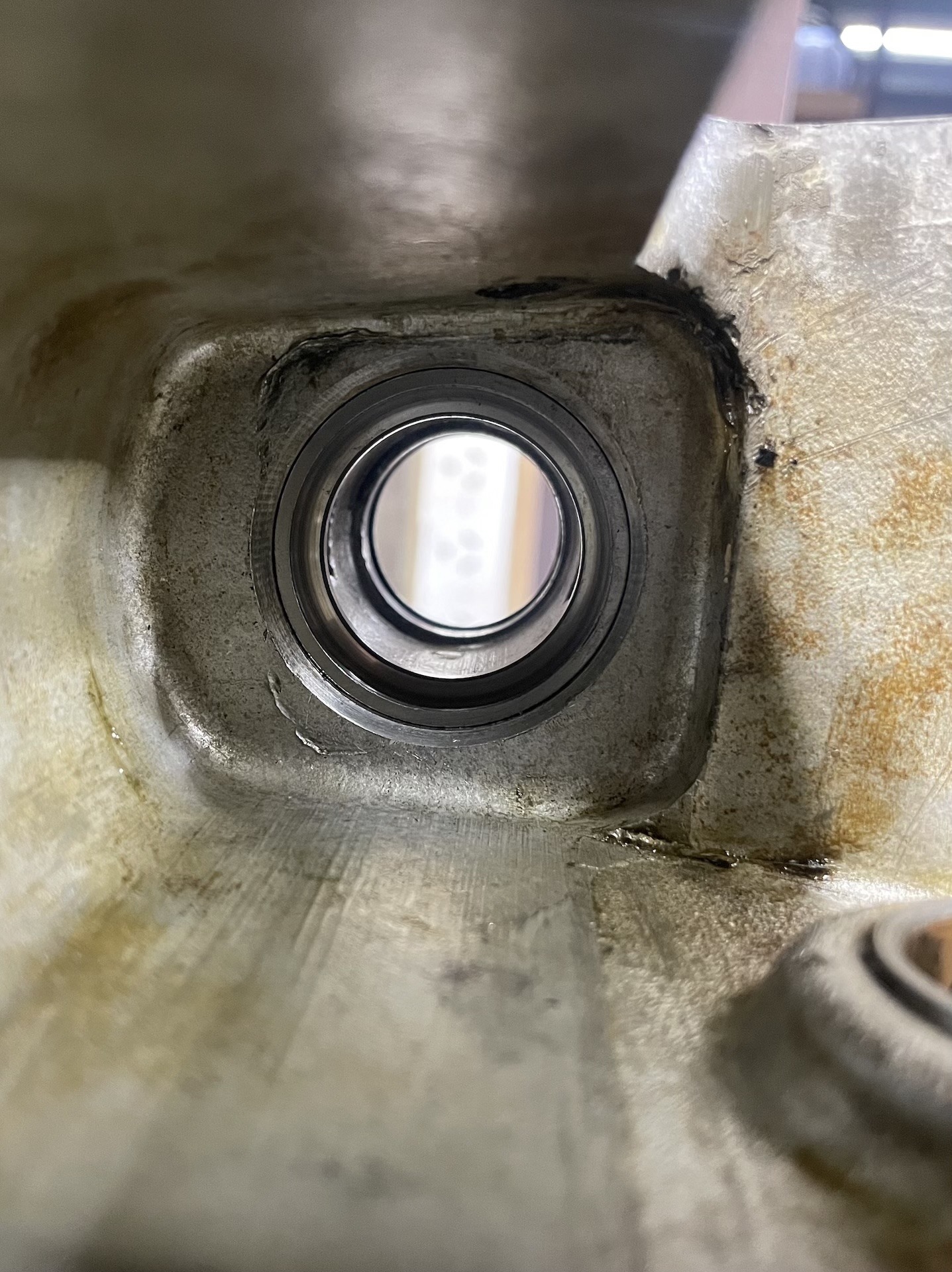

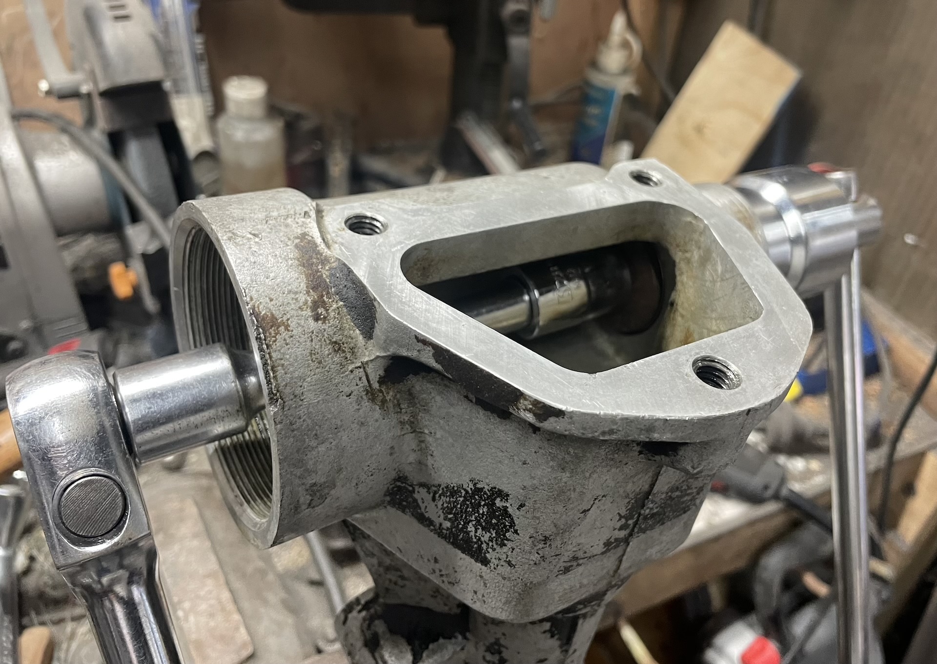

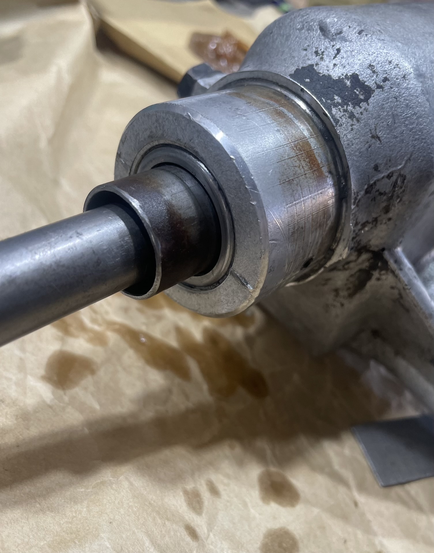

Used a flat bladed screwdriver to tap out the HR bearing cup. These two recesses in the steering box are your friend when removing.

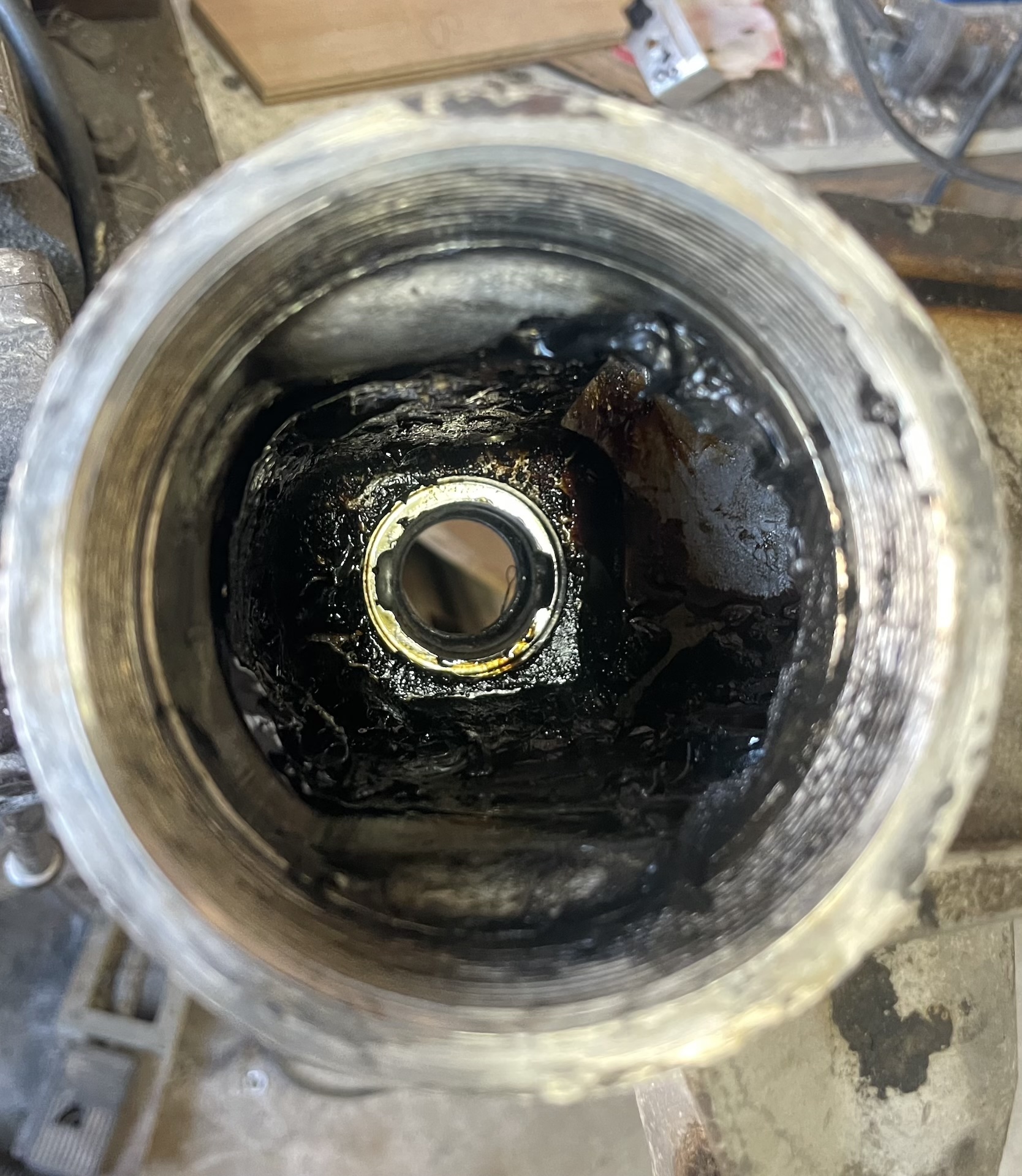

Everything into an ultrasonic kero bath. Monitored temperature so as not to let it get too hot (google says flash point of kero is between 37-65C). I stop when it gets to 35 C. Clearly not a risk taker!
Initial fitting of the bearing cup into EH box.
In my ‘lathe’ I turned a washer down to the OD of the bearing cup.
Final fitment with bolt/washer/socket combo pulling the bearing cup into place.
Result

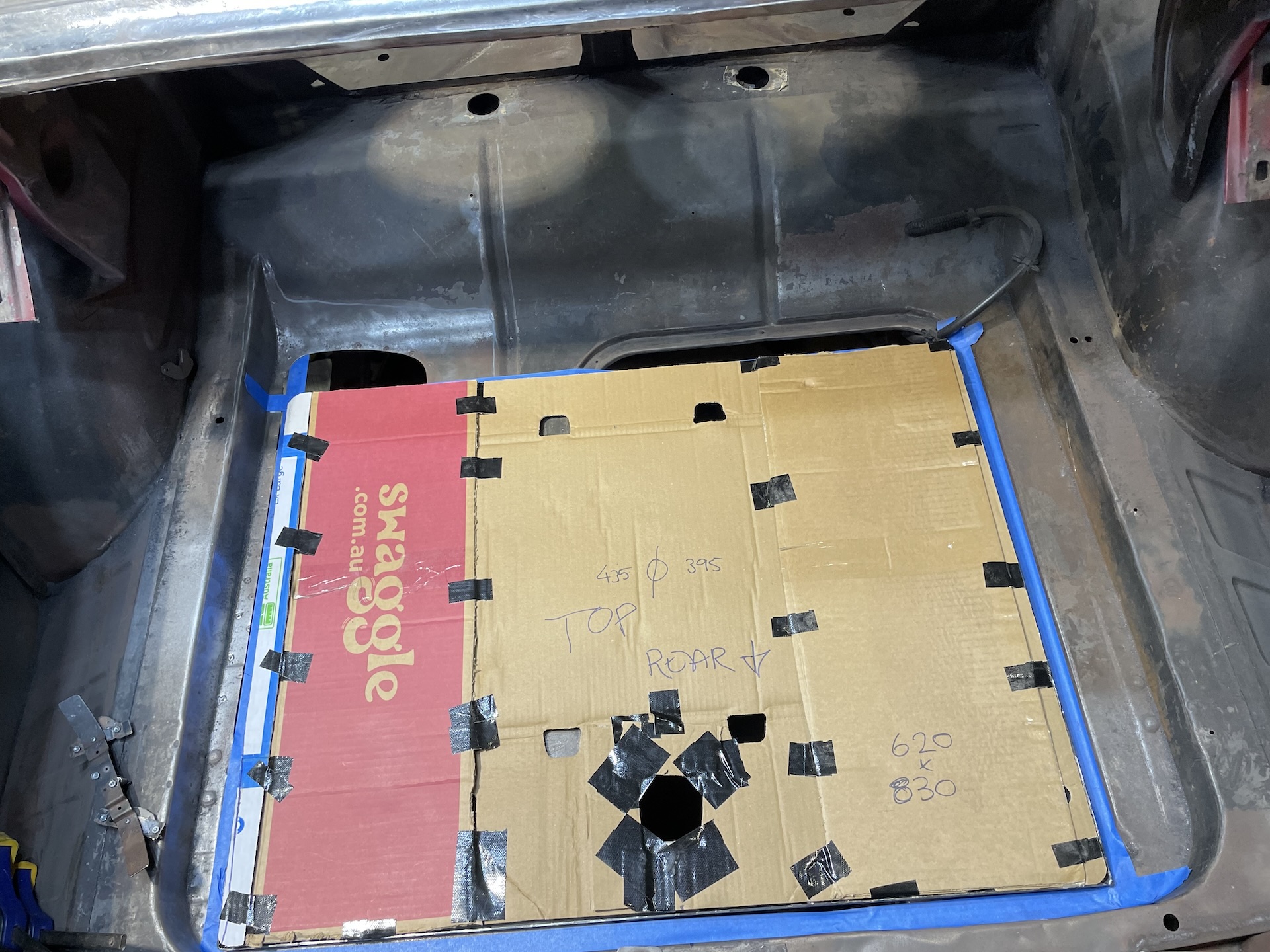

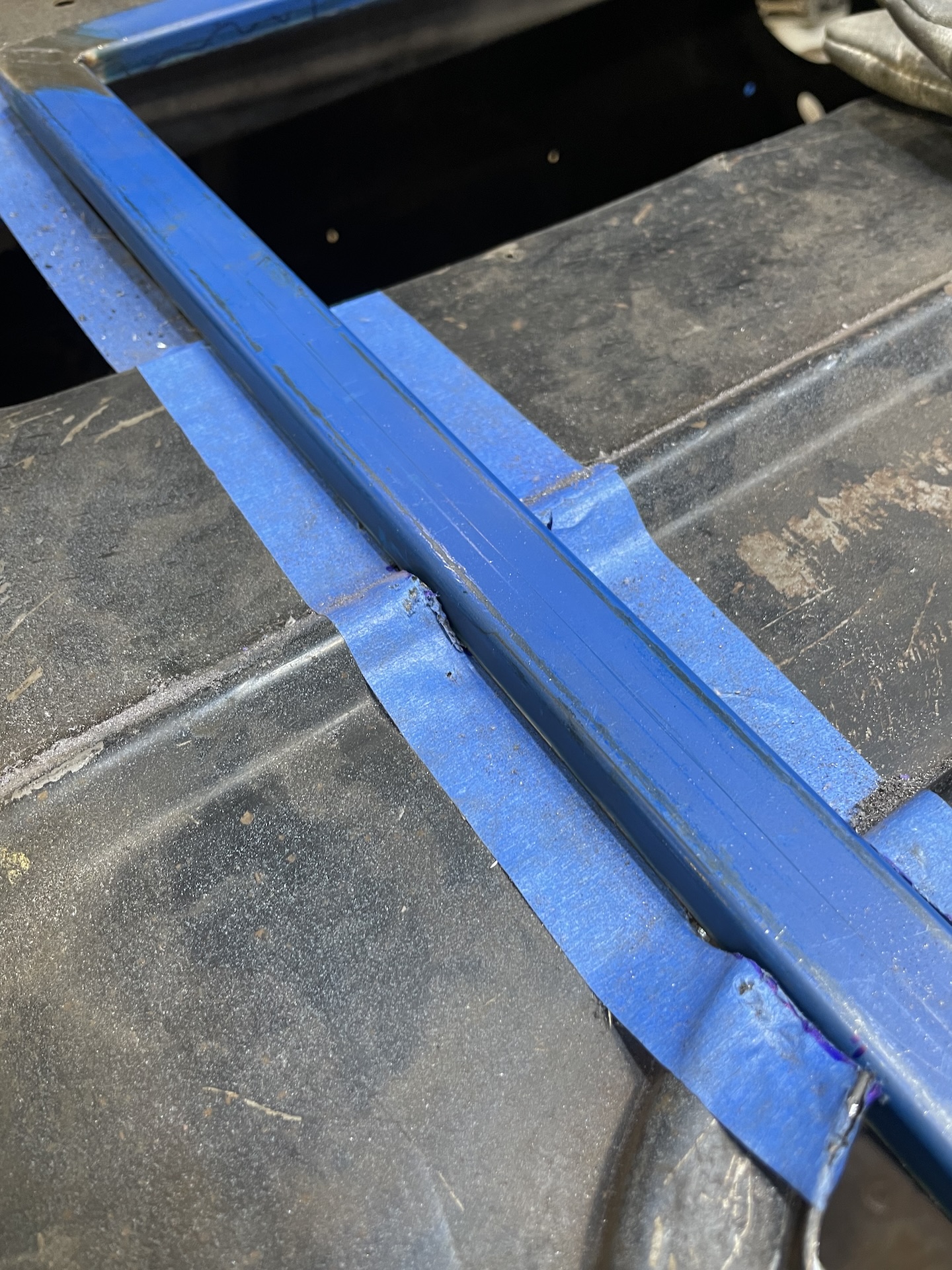

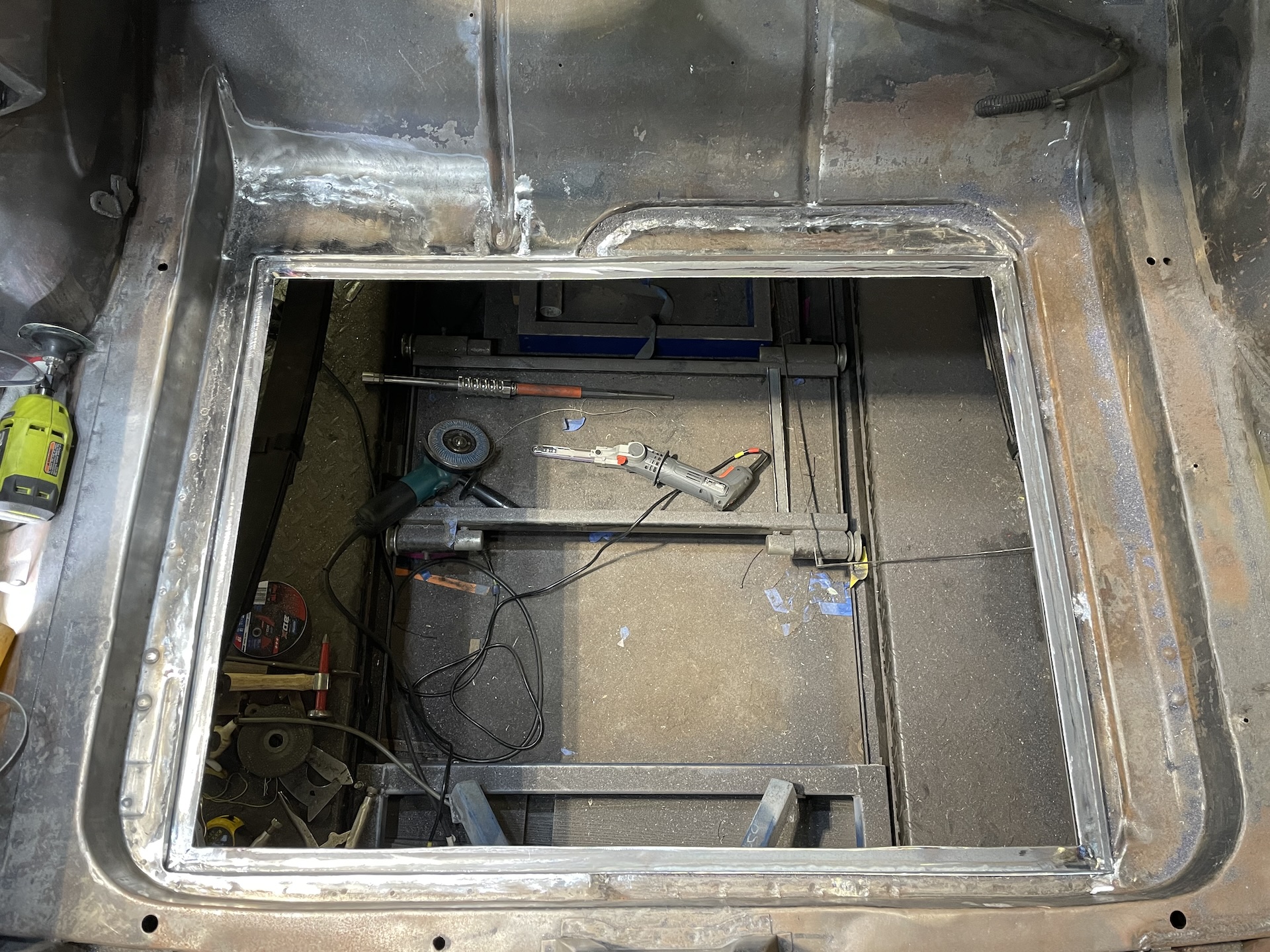

Started off with a measuring tape and some CAD. Inlet pipe is slightly offset from centre by 20mm to the right, so tank has to be offset to the left.

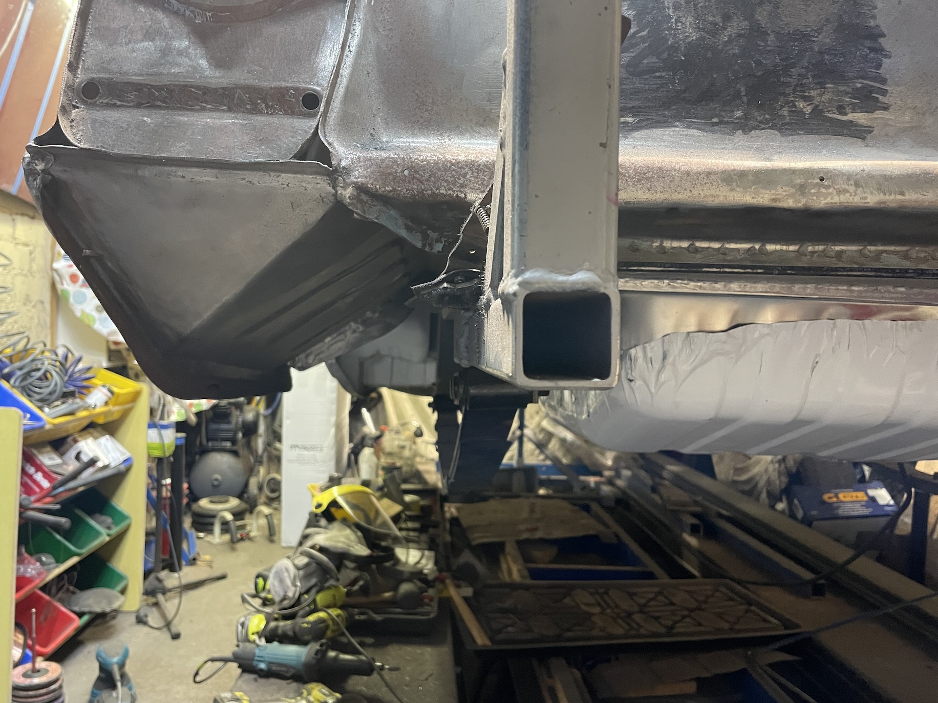

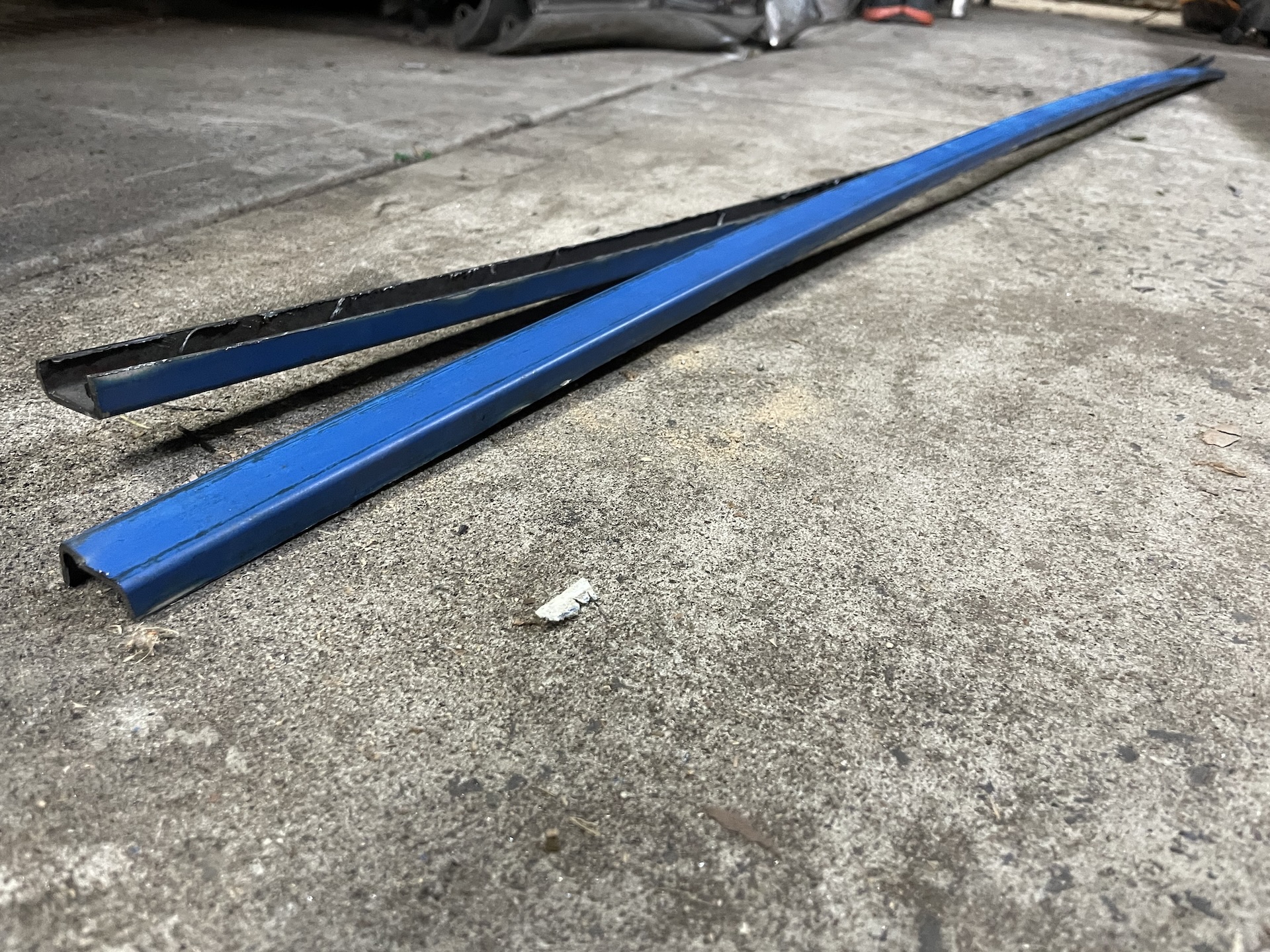

Plan was to build a frame out of 90 degree bent sheetmetal. As I don’t have a brake I got creative with a bit of scrap 25 x 25 x 1.6mm SHS to build a frame. Figured I could split the tube I had with a cutting disk in the angle grinder using the guard as a guide, and the result would be nice and thick and straight.
Not quite - 3 cutting disks later I had these 2 bananas.
Bent over my knee to straighten, then cut out a notch and bent to create a 90 degree corner, repeat and clamp the two lengths to the tank and mark, ready for final cut and weld.

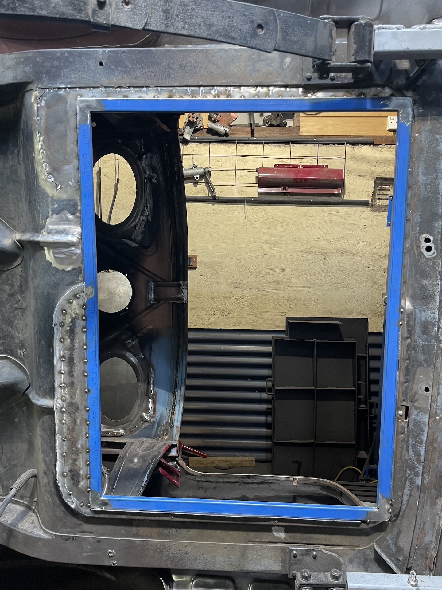

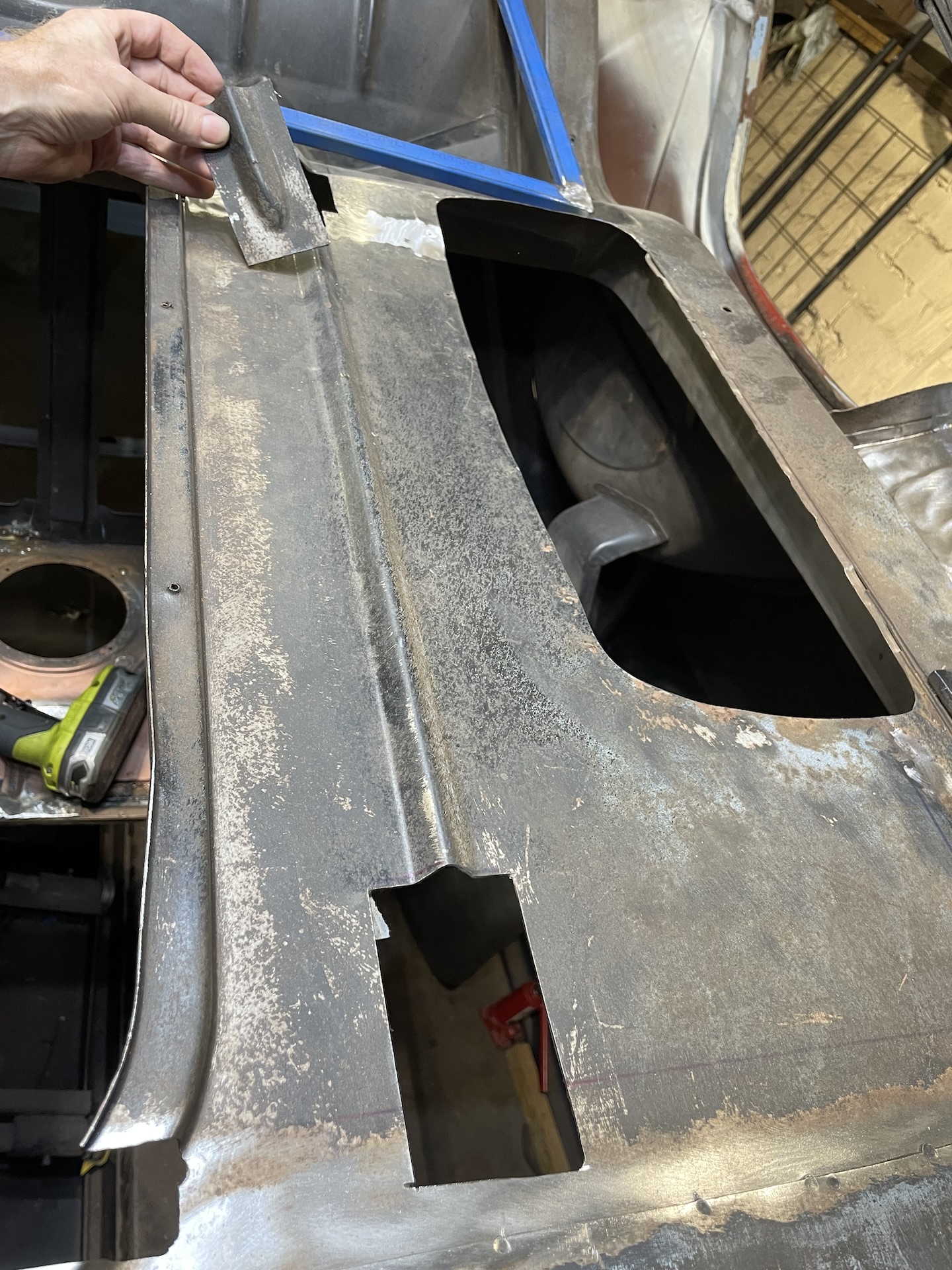

Flip the car onto its belly, marked and notched out the bits where the lip of the old tank and and the bead roll were preventing the frame from lying flush.
Side tracked as I decided to take the end of the bead and move it to the back behind the tank.
Frame tacked in prior to cutting out the old metal.

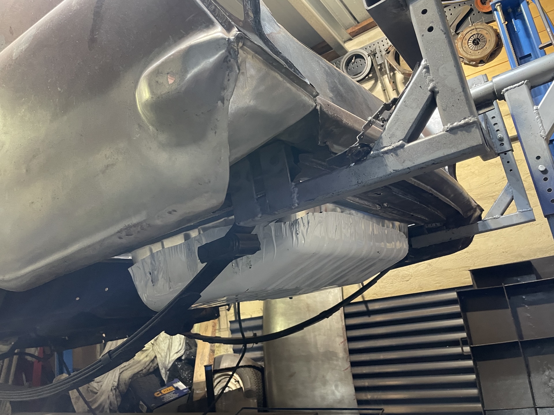

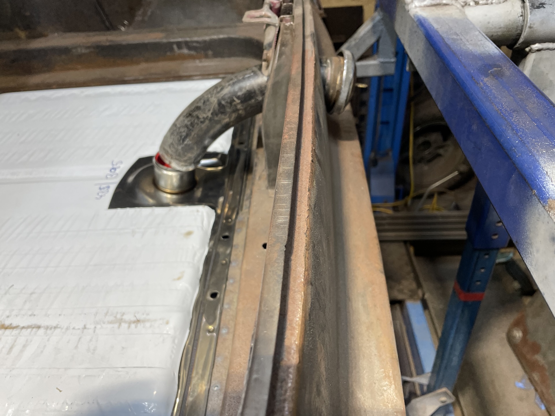

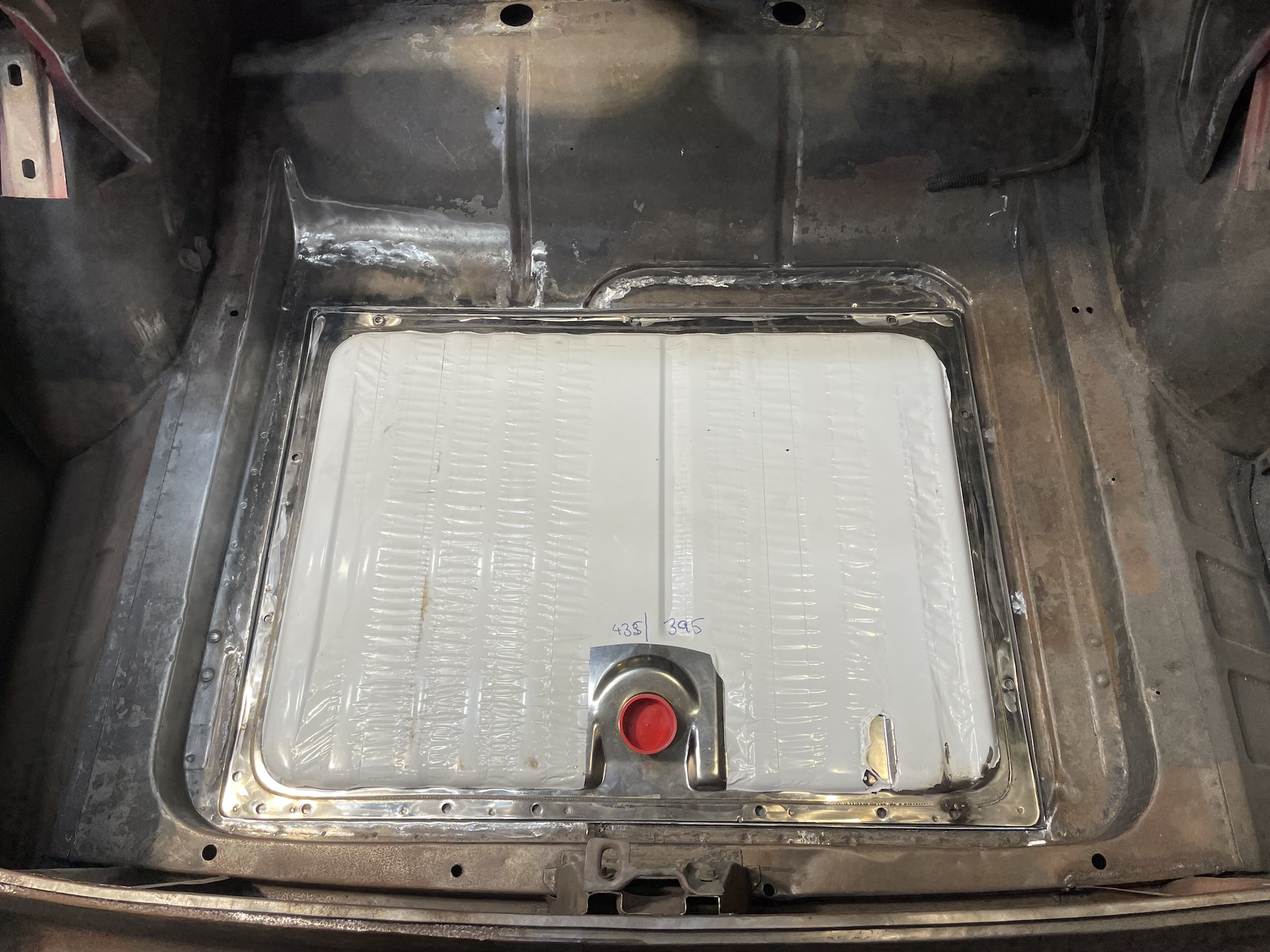

Quick test fit.
Kept the filler neck off the old tank thinking I could re use it. Not quite! Ideas anyone? I thought of pie cutting the neck but if there is a simpler solution let me know.
Cut out the metal from the floor and re used it to patch the gaps left by the spare wheel and old tank.
A day of welding and grinding later, frame is installed. There is a bit of a bend in it but overall the floor is much stronger than before.

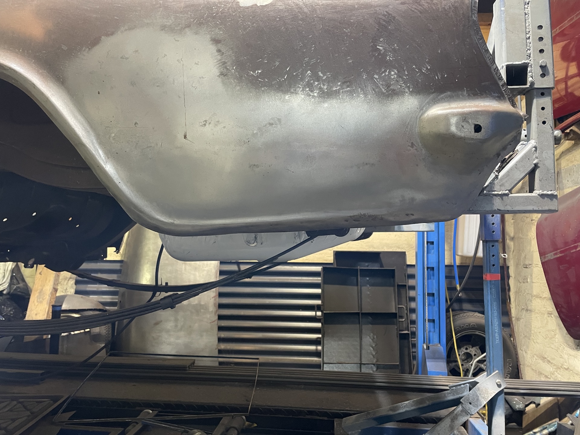

Another test fit.
Does my arse look big in this?
Is it too low?
Re: Ol' Rusty - FB/EK Sedan
Posted: Thu Apr 24, 2025 7:40 pm
Very tidy work as usual mate , looks like a bought one. Can you use rubber fuel hose to make the filler line up rather than try to fettle the original filler pipe ?
Posted: Fri Apr 25, 2025 12:00 am
funkyscooter wrote: Thu Apr 24, 2025 6:26 pm Quick test fit.
Is it too low?
Need the diff and wheels on, and three fat mates in the back to check. Piece of string under a rear tyre, then lift it upwards from the back of the car. If the string hits the tank before the body, then too low. Can always pack it upwards, especially if the filler neck has a length of hose joining it.

Thanks Blacky. I have a short straight hose, ID 57mm, to connect between the tank and the filler pipe. Think I’ll have to ditch that for a 45 degree one and adjust from there. Yeah mucking around with the original pipe is probably a bit of overkill as its a long way off at the moment
Thanks Harv - thought I’d read that but couldn’t find it. What I might try for now is to put the diff under and sit it on the bump stops with wheels on. Not sure if I will be sticking with the 13” dragways but it will give me an idea at least.

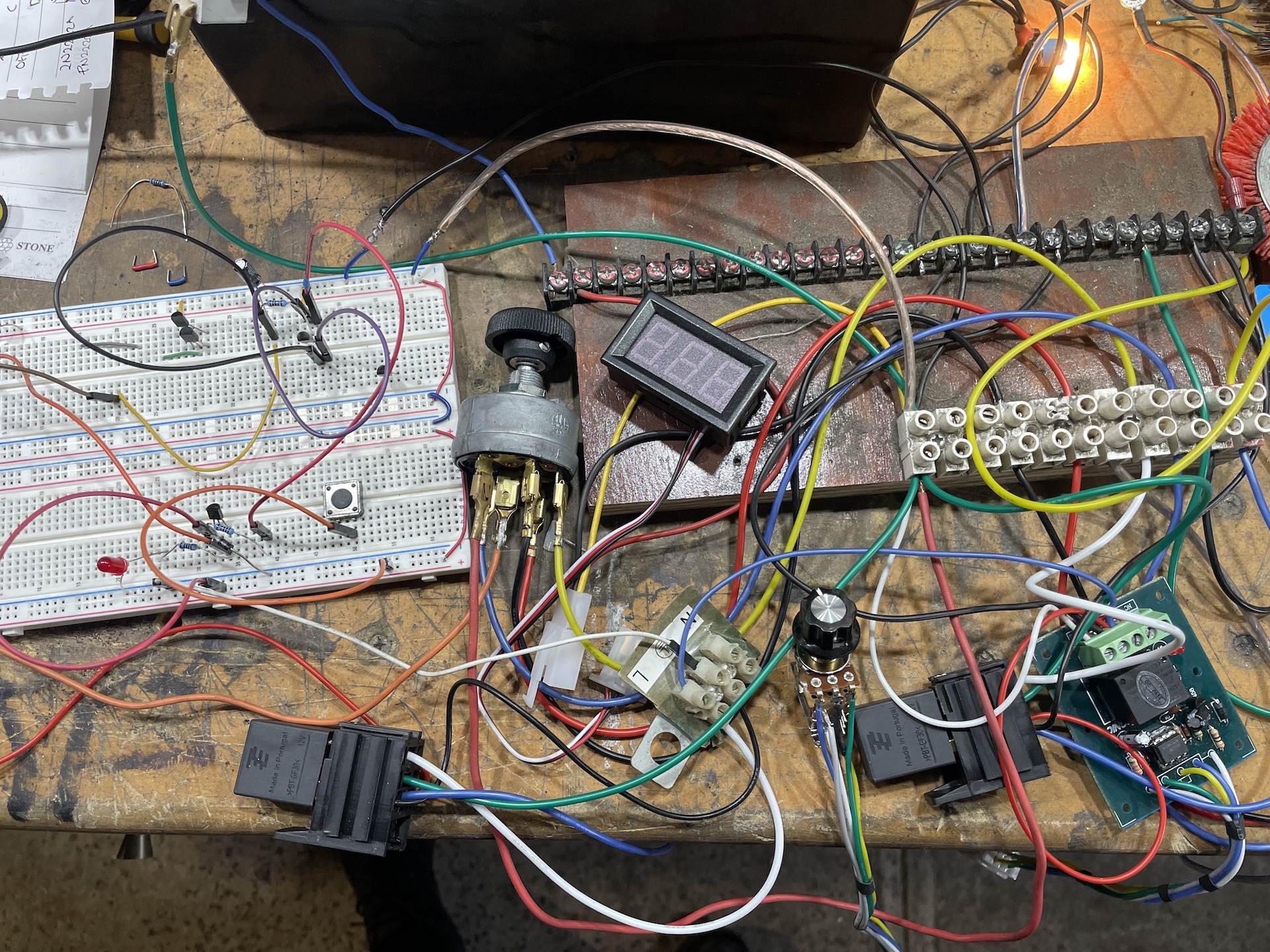

Wiper set up fun and games.
So inspired by the intermittent wiper set up on Blacky’s FB Ute https://www.fbekholden.com/forum/viewto ... 76#p273876, I purchased a couple of MaxTronic intermittent wiper controllers.
Things have progressed a bit since I posted in Re: Neil's FB Station Wagon
https://www.fbekholden.com/forum/viewto ... 32#p274032, and I figured I should finish up what I started.
So I got 2 of these
Did a couple mods to one of them. The circle is around a capacitor which I swapped from 100uF to 47uF to halve the intermittent time. Also removed the onboard Pot/Switch and replaced it with a 500K linear Push/Push pot so I can mount it remotely. The push switch also allows you to turn it on/off without losing the intermittent delay which you do with the on board. Didn’t need to wire the blue wire as it is tied to the yellow one on the board but only realised that after it was all soldered up
Grand plan was to enable/disable the Maxtronic when you switch on the wipers. But there is much witchcraft in the wiper setup, and running all my testing without a fuse like an idiot, there was a bit blue smoke along the way. Only managed to melt the traces running from the relay to the outputs so tied them up and everything is still working.
Much time later, I have ended up with this mess.
What I have achieved? Not the original goal - I have wasted too much time on this already. So press the remote push button to turn intermittent function on/off, as before. But now, press and hold the washer button to squirt water AND wipe the wipers, and the wipers continue for approx 3 seconds after the wash button is released. If you tap the washer button, it will wipe for 3 seconds without any water being squirted.
Here is the little delay circuit.
