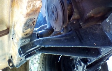

here's a pic of mine before I did any work in that area (probably not touched in 40 odd years)

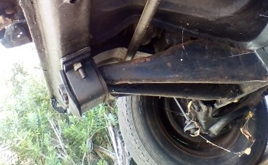

and a pic with the new section welded in. I was thinking that when I got to working on the front end, I would check out changing spacer lengths like Rob has said - but in the meantime put in a slab of metal to save the rubber a bit

Patrick
