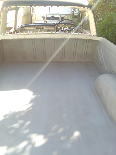

and here's mine - waterproof so it can be hosed out after a tip run :thumbsup:

Hey Patrick what have you done there? Is it a mat with boards underneath? Sorry I missed your post before😒

Re: Project 2.
Post by 62ekute »
Hi Brett. I cut in a sheet of 12mm ply then painted over everything with a couple of coats of Crommelin Water Based Waterproofing Compound. Patrick

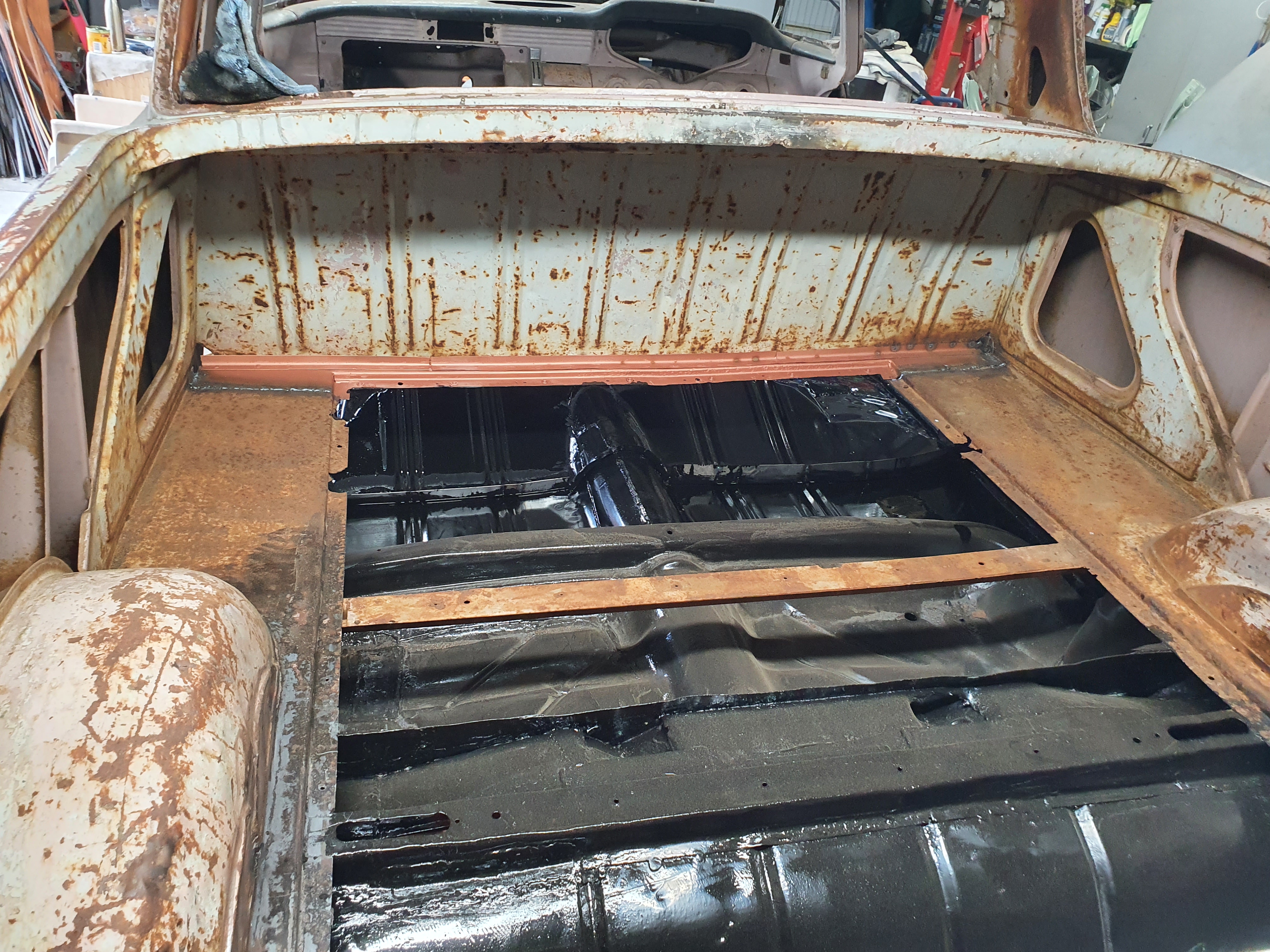

Bit more stitched together.Image
Posts: 11630
Re: Project 2.
Gee you made that look easy Brett. On mine I replaced the bottom three inches on one side and it was s pain.
Posts: 2518
Re: Project 2.
It wasn't easy at all Clay. It took 3 days to get it sorted. Lots of metal bending and plug welds. Concours not. Glad to have it behind me.
Sound deadener to go on under the floor and then off the rotisserie. Much happier working with the car on the cradle.

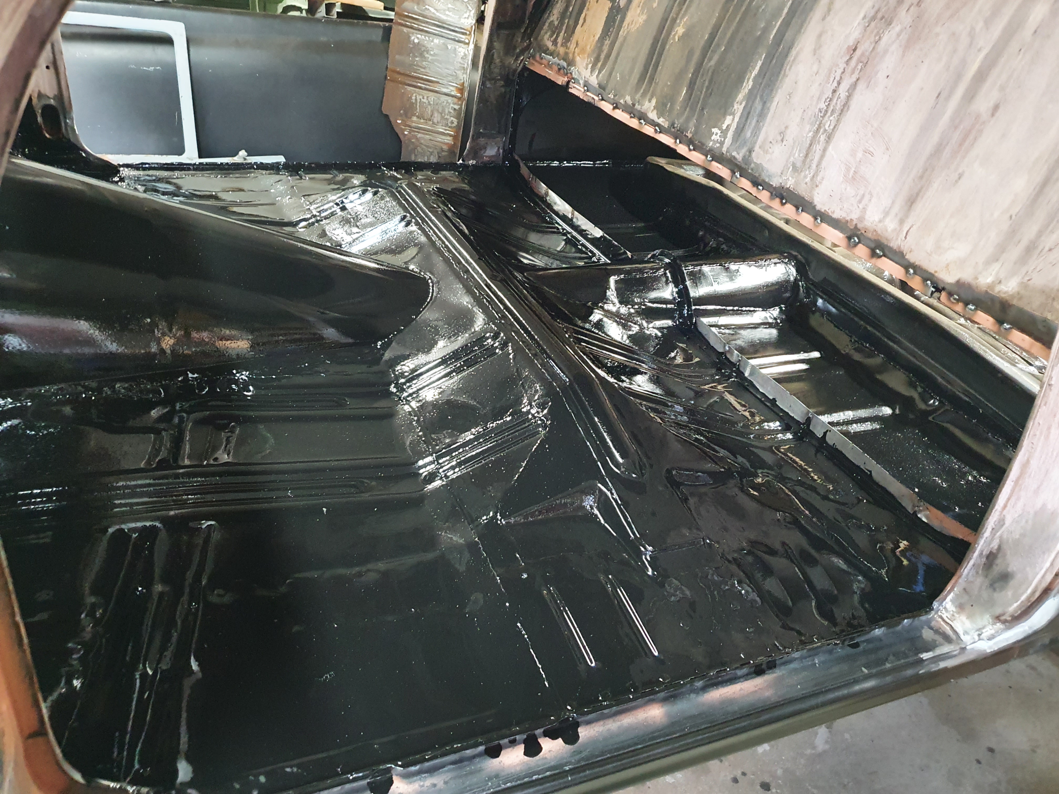

Posts: 2518
Re: Project 2.

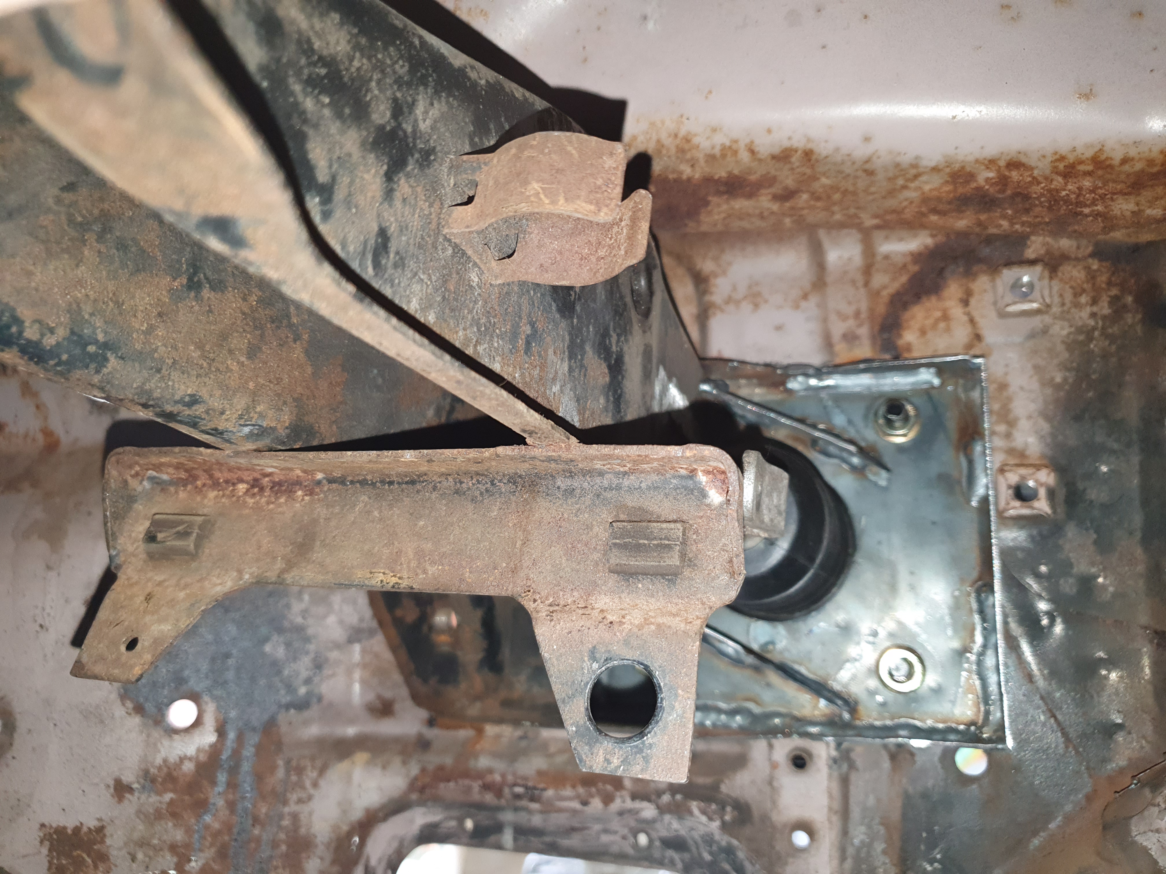

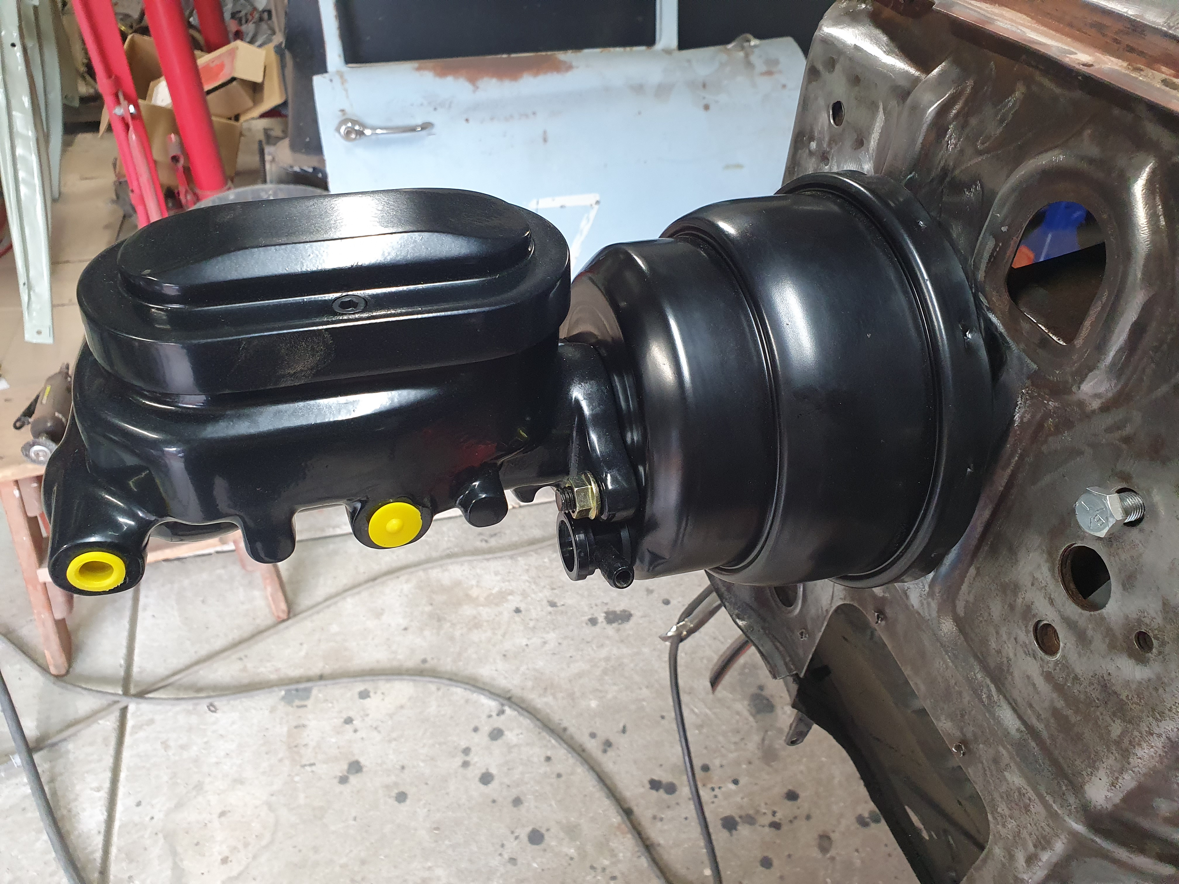

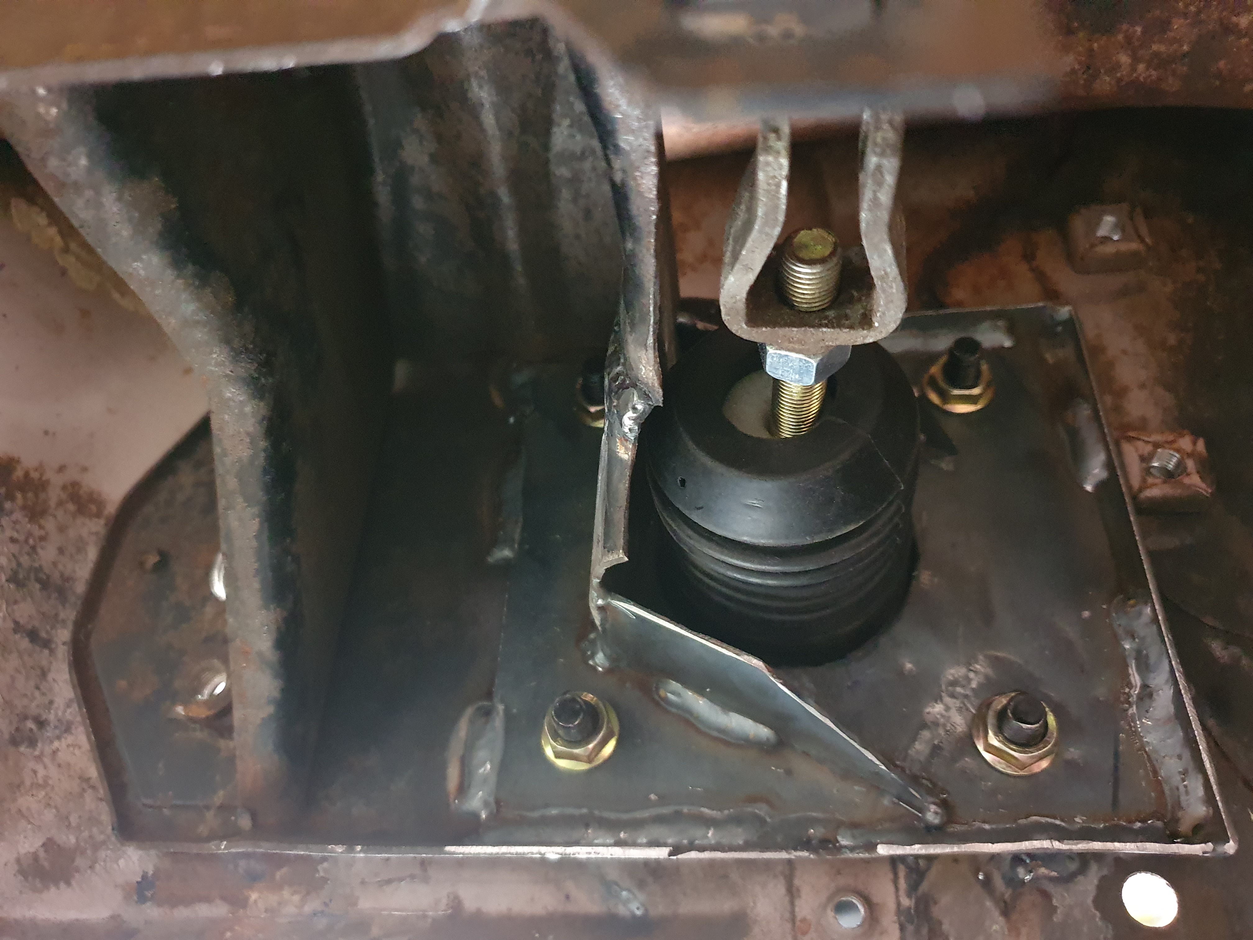

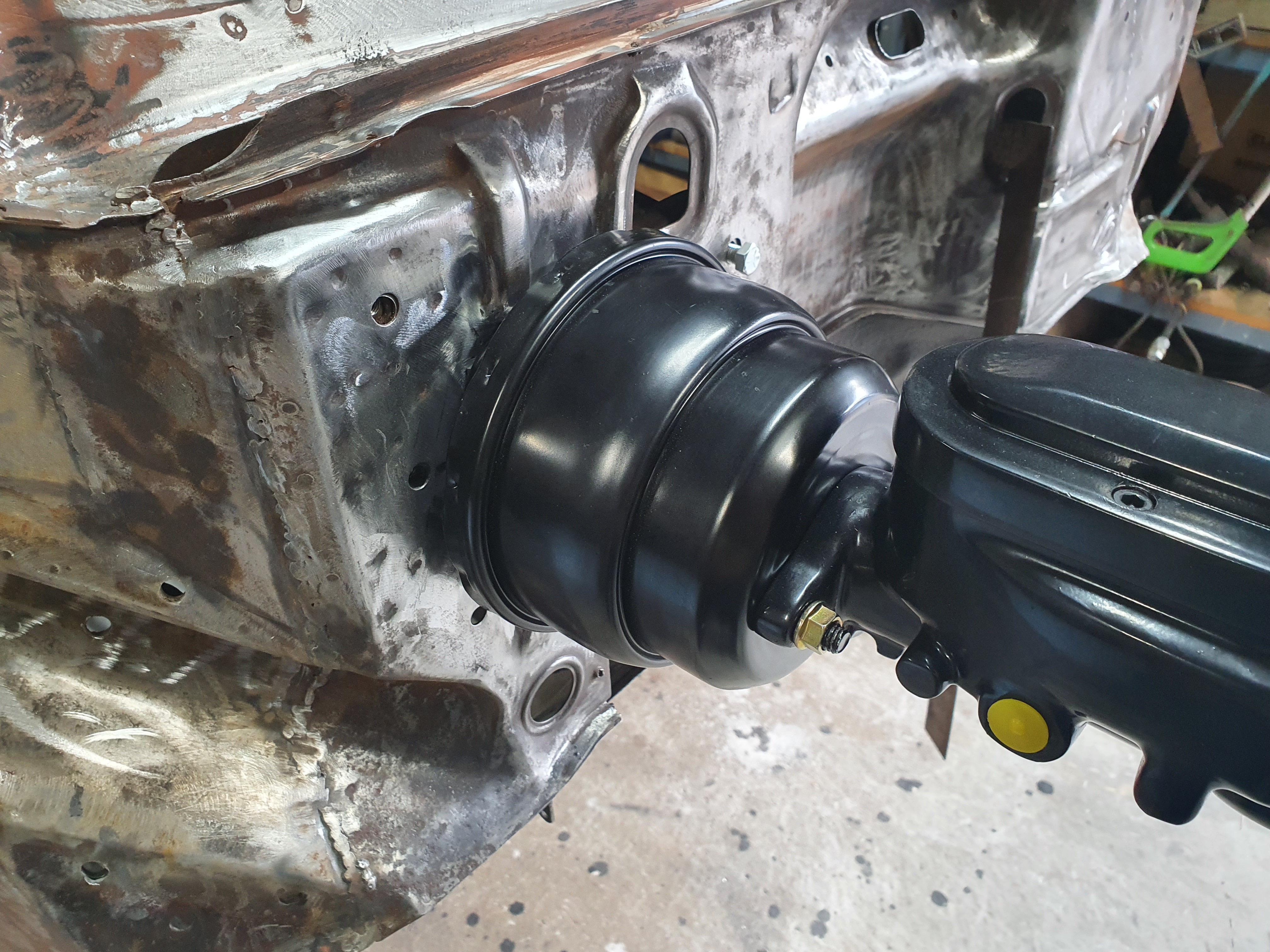

Body now back on the cradle as the floor and underfloor coatings are now finished.
The last couple of days spent getting booster fitment sorted. Modified firewall to make it flat where the booster sits and added a section to the pedal box to keep the alignment with the brake pedal right and hopefully make it as strong as needed.
Seat mounts next on agenda.
Posts: 14238
Re: Project 2.
Good job. Thats a sexy looking master cylinder , where is it from ????
