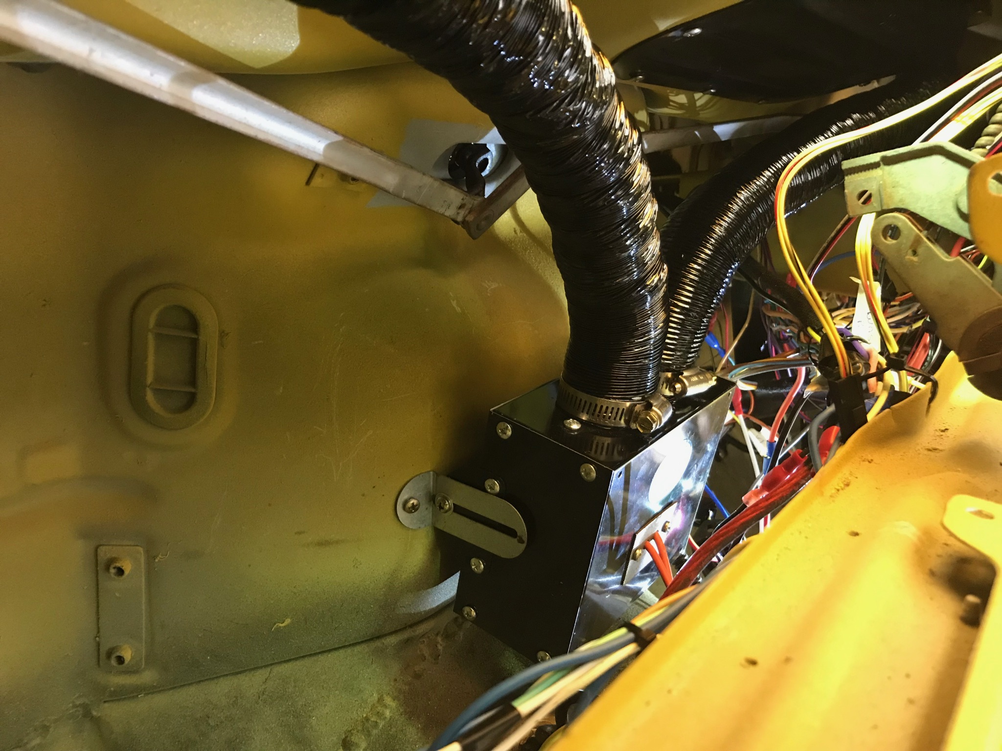

One step forwards 3 steps back at the moment, I'd noticed a small coolant leak at the corner of the radiator, thought it was the lower hose clamp so repositioned the clamp but each time I ran the car and the system got pressurised the leak would come back, pulled the radiator and found the bottom of both of the plastic tanks was leaking, yes it was an original commodore tank that came out of the donor car so I'm now going to replace with an alloy tank
On the up side I fitted my little cheap Chinese demister, it all works and I actually get warm air to the screen
so should satisfy inspection, I hadn't checked amps but when I first tested it it blew the 10amp fuse
so fitted a 25amp fuse and all good.
Also going to have to loss some of my glove box or rethink it as I need room behind the dash for the computer etc.

Search heater/demister my heater setup is there. it's on the 3rd page.
BILLY BLACKARROW
Re: Neils Frankenstein Ute
So based on the 600 watts and 24v makes the resistive element 0.96 ohms. With 13.8 volts that would equal current flow of 14.375 amps and power of 200 watts which works out with your fuse value. Few assumptions here but I wouldn't leave it on for long without motor running. Where did you source the power from?
