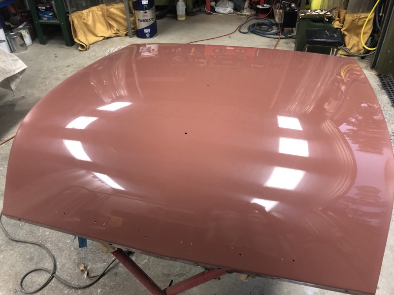

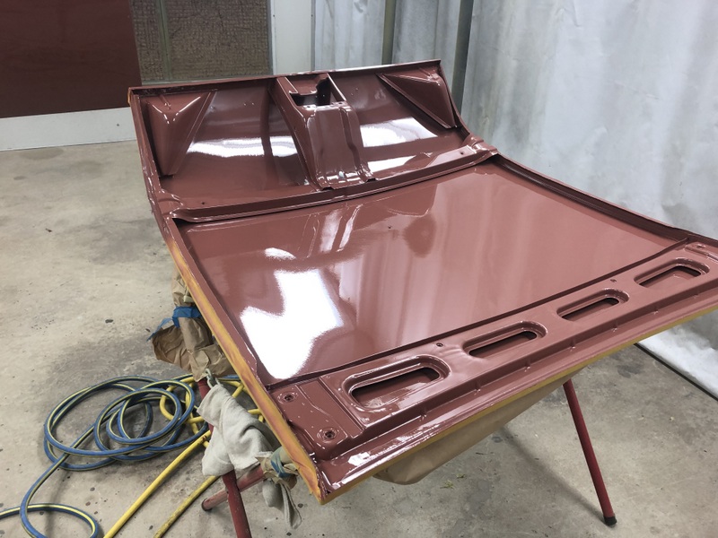

Hey don’t forget stone tray and cowl vent cover. Fantastic wetness mate. 1 or 2k?
Posts: 2710
Re: Chev EK
Errol62 wrote: Sat Nov 30, 2019 4:17 pm Hey don’t forget stone tray and cowl vent cover. Fantastic wetness mate. 1 or 2k?
No Mate cowl and stone tray are done !!!
Its 2 pack clear over base, still learning a bit but it comes out great if you get it right !!!

Wow that's the finish then. Looks brilliant! Fingers crossed for the rest.
Posts: 5741
Re: Chev EK
I really like that colour. You've done well under that bonnet... all the nooks and crannies makes them a nightmare to cover without runs or waves.

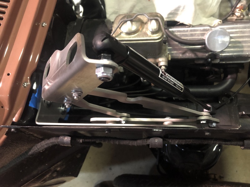

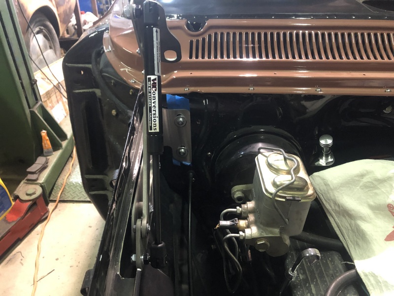

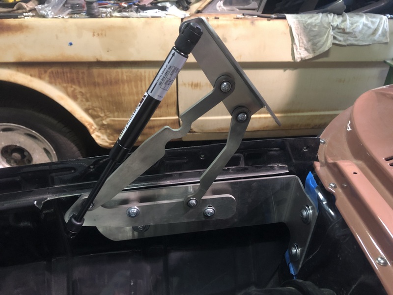

Couldn't fit the original spring on the bonnet hinges so I lashed out and got some up to date gas strut hinges.
Gives me heaps more clearance for a bigger booster if the need should arise.
I had to relieve the water channel to fit them but that's ok I needed to touch up the paint in this area anyway.
Will paint the bonnet tomorrow and chuck it on !!!!
Posts: 11670
Re: Chev EK
Very interesting. They look well put together. They would be lighter than originals by the look.

Re: Chev EK
Post by WesternWagon »
Looking the goods Greg, under the bonnet is a tricky are, it came up a treat.
those hinges look interesting

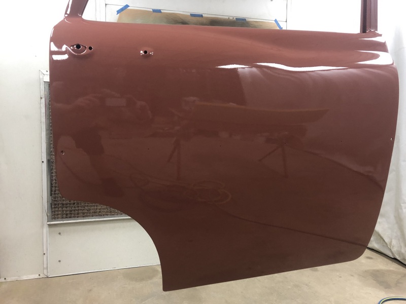

Started some rubbing back and buffing, got a couple of spots you can hardly see that I will leave until I see how the rest of the car turns out. Its addictive and I have become obsessed to have everything perfect !!
GRRRRRRR ! Just a driver !!!!!
Needs a fine polish to get the swirls out, more time to spend later on.
Two guards and 3 doors to go !!!!!!

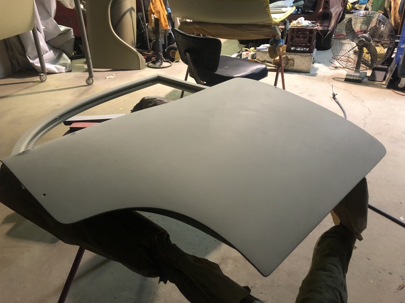

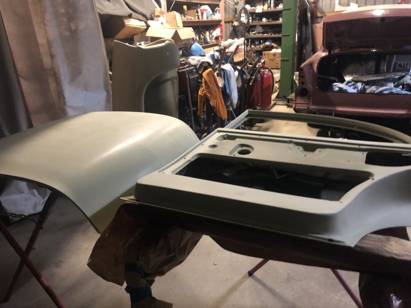

Bit more done in the last few days,
Painted some small bits and trialed fit the guard one more time before paint. Did the lip modification as well although I still have plenty of height.
Got the gasser look going although there is still lots to go back on. The back might need raising as I can't go much lower without rubbing something, we will see.
