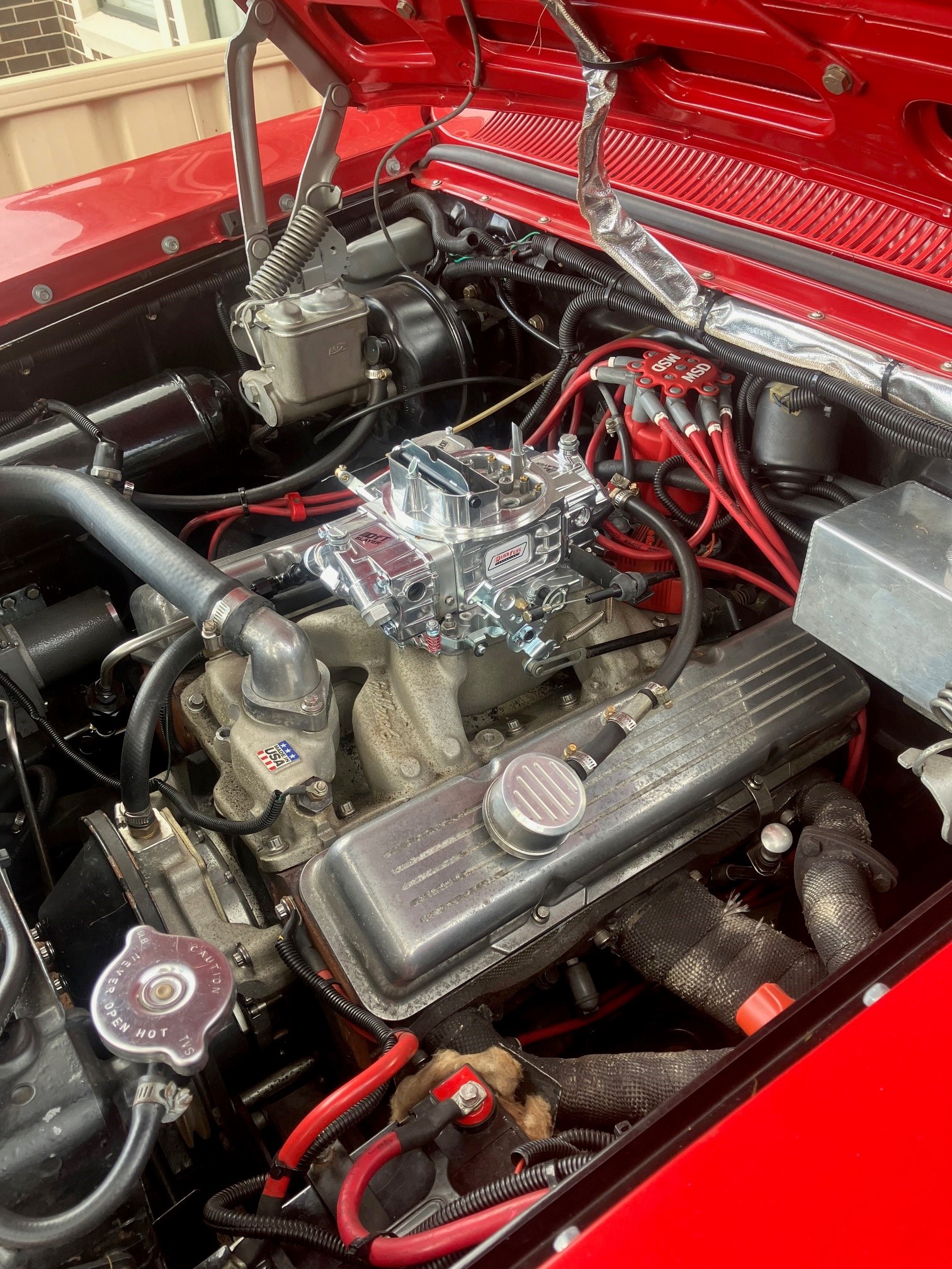

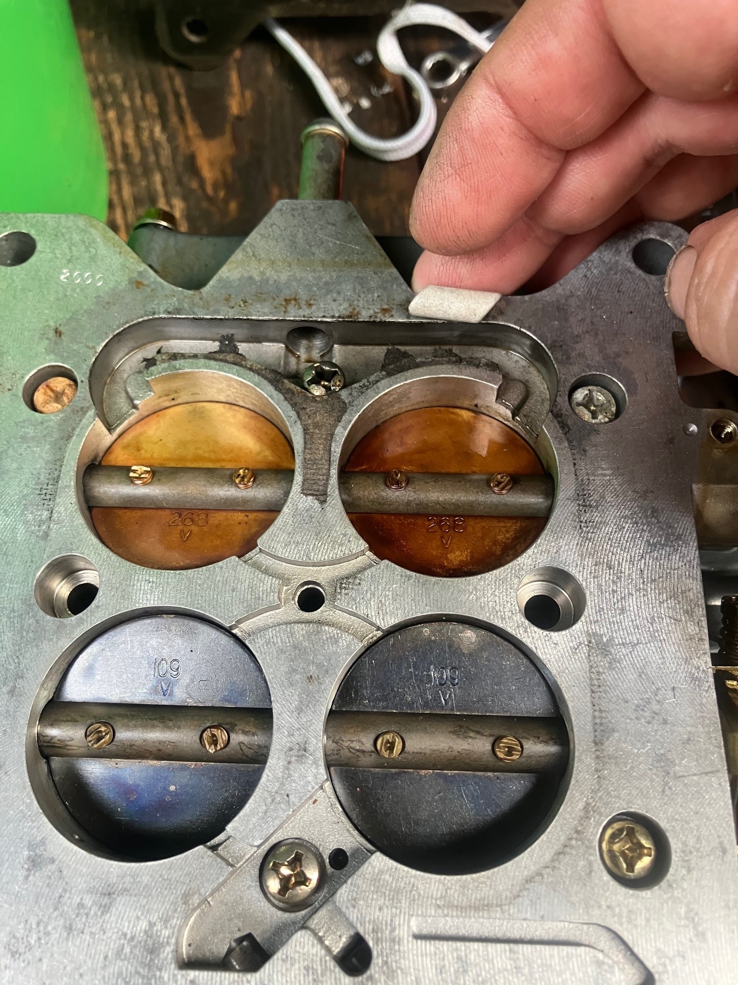

Converted the QuickFuel from electric to manual choke, split the fuel line for the dual fuel bowls. Old carb off, and slight mystery found. Looks like a short piece of round plastic, tapered each end, was present in back vacuum channel. Manifold vacuum is taken from under BOTH butterflies, goes out via two channels cut in the carb base, and exits the carb in a neat pipe at the carb rear. The plastic bit was in only one channel. The gasket marks show it was jammed in one spot. Its not big enough to fully seal the channel (and why the hell would you want to anyway)? Anyone ever seen something like this? It's been there since the engine was built, but no idea what it is. Pretty confident it is not the source of my woes, but got me curious.
New carb on and plumbed up. Fired up first attempt, lovely and crisp. Responds like a fuel altered, like it did when first built. Will tootle it around a few days, get it dyno tuned again then take it to Eastern Creek for some leaning-on.

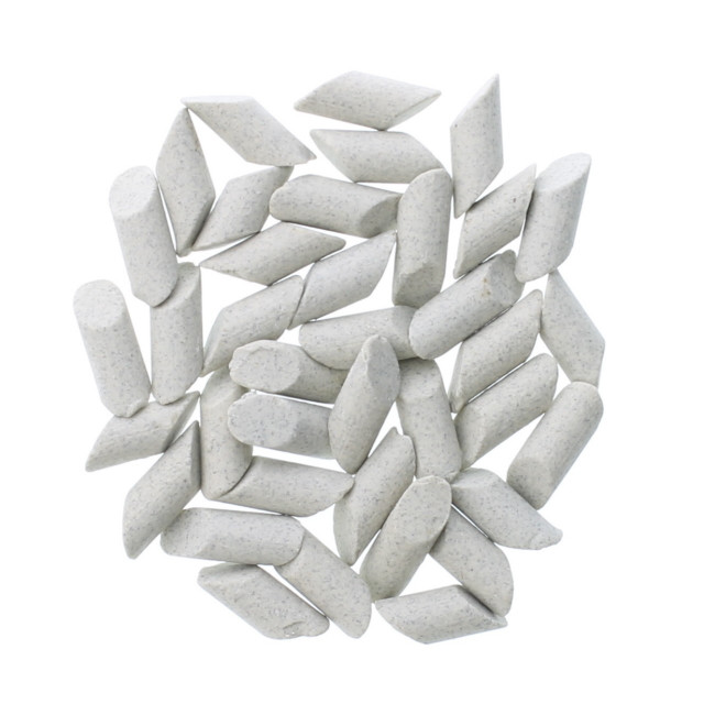

The source of that bit of plastic has been bugging me, so I asked a question over on the HAMB. Some good feedback - it is likely that the item is not plastic, but ceramic. It is probably a piece of ceramic media used in a vibratory bowl to deburr and polish diecast parts.
ceramic media.jpg (58.22 KiB) Viewed 8985 times
Pretty good chance that the carb parts were polished by Holley, the ceramic piece got lodged in the channel in the carb, and never noticed when it was packaged then sold. Kinda reinforces that Holley's QA/QC was patchy in the 2010's. The engine builder missing it is not out of the question either given some of the other issues I had, like the early main bearing failure and stuck-on oil filter.
