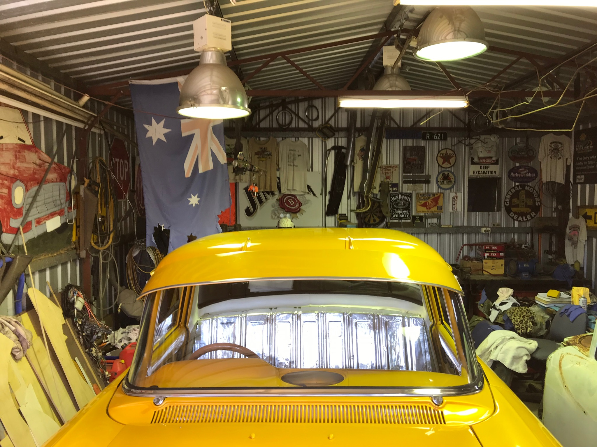

Fitted the sunvisor today
Posts: 11679
Re: Neils Frankenstein Ute
Going to be one pokey grandad car! I hope it’s on tight with that lumpy v6 under the bonnet. 8) 8)

Great looking visor.
I had one with the big block 186 and it split the roof mounts, needless to say I don't have one now !
On the ute though it looks great and probably really needs to be there.
regards Greg

Put the rest of the bolts into the visor and fitted the sun shades.

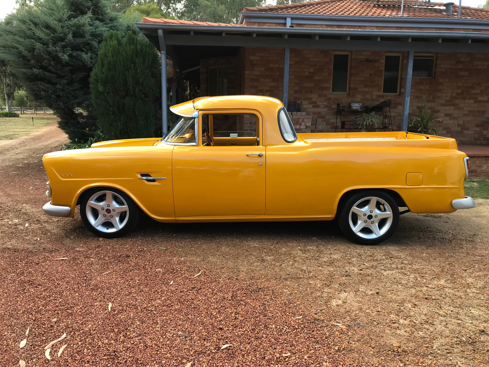

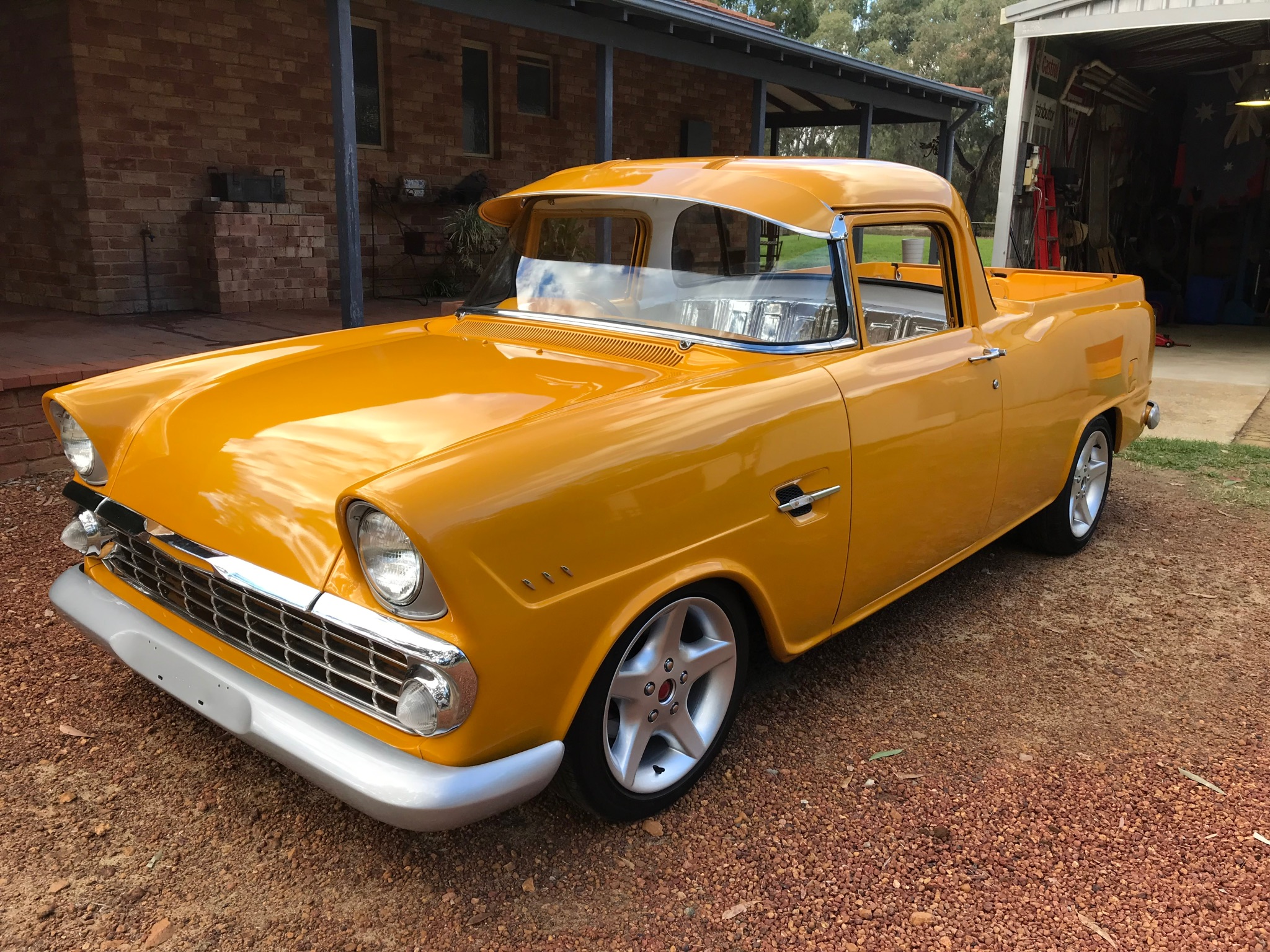

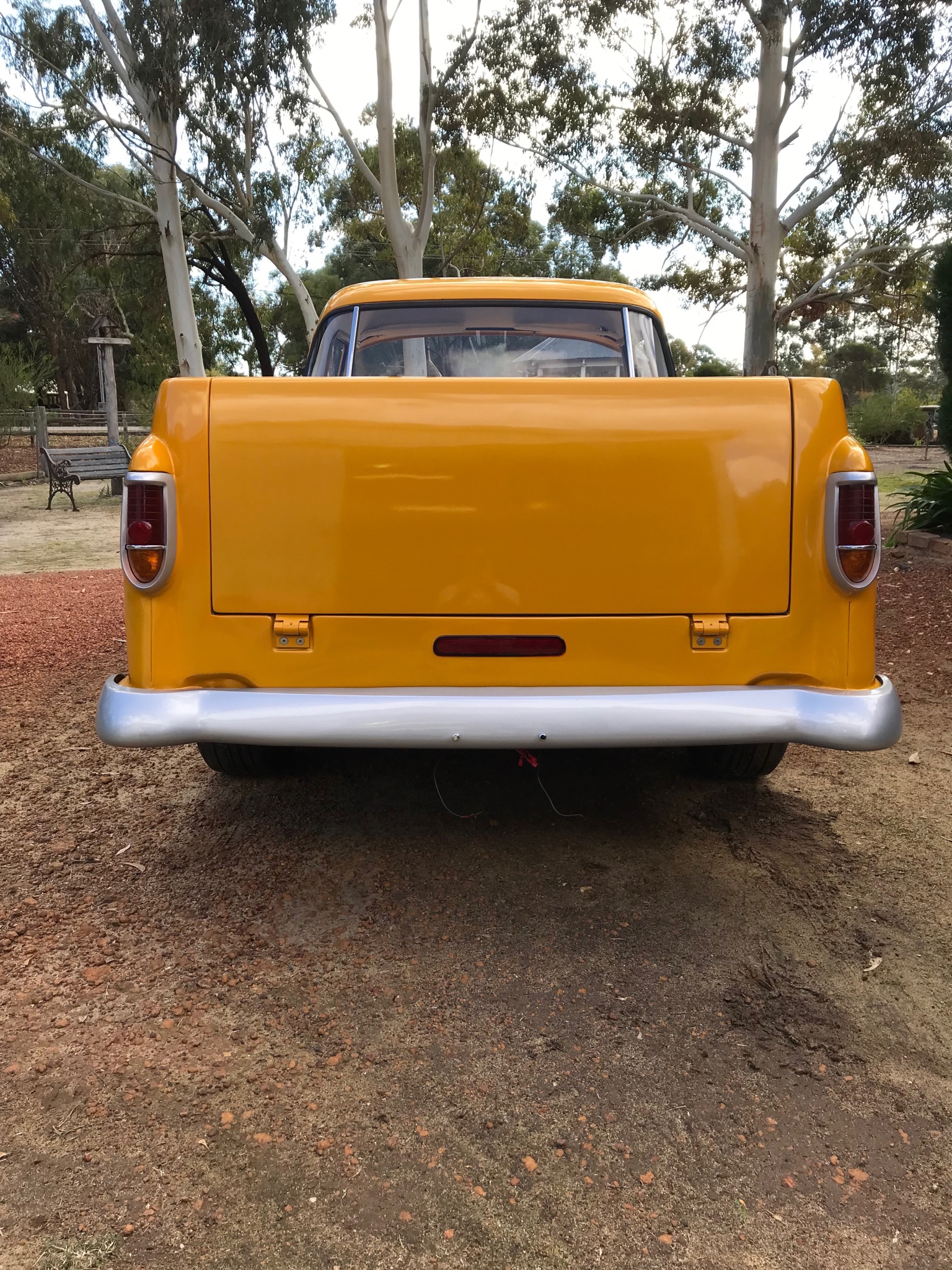

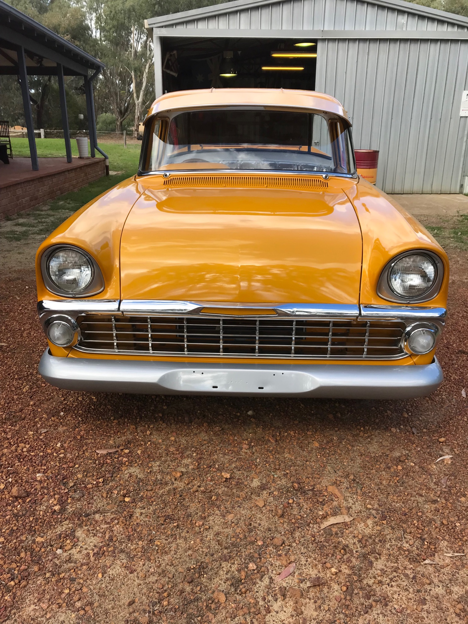

Put the Ute on its wheels (nice centre caps coming) to check ride height, I think the front is a bit low even though I like it, and will probably go back to standard height springs as tyres are going to rub when trying to turn, drove it out of my workshop for the first time under its own power, still got a fair bit to do and a couple of things to sort out.
