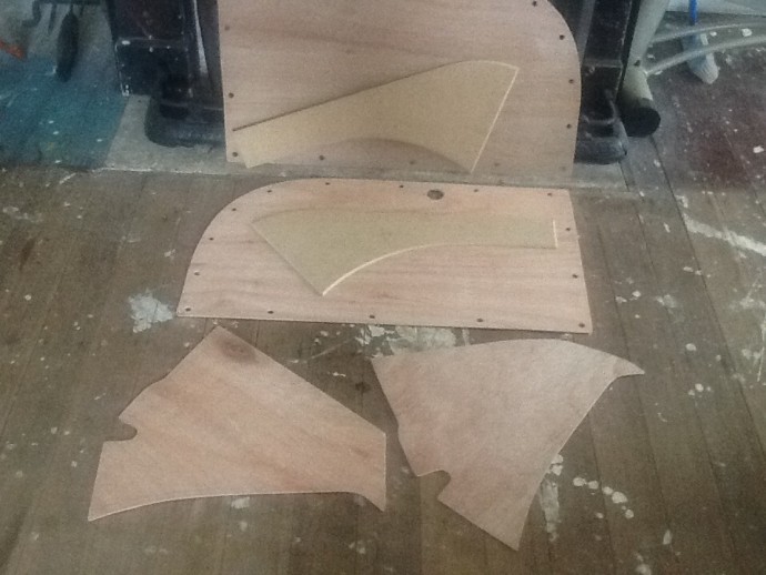

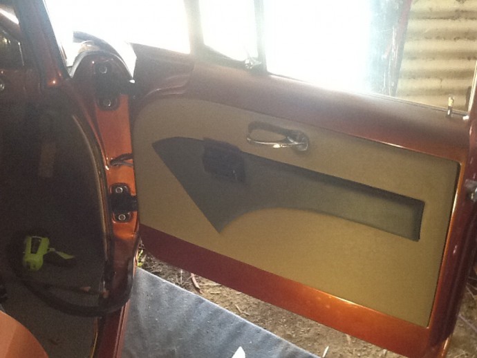

Been on the interior all this week , had to change tack a little bit , couldn't get my mates borrowed sewing machine to feed the vinyl through , spent a whole day on it last weekend with no joy , so now I have a no sew interior .
Cut all new door cards etc from some 2.7 mm ply ,and glued foam and vinyl on , looks tidy , will send all the seats out to get done professionally at a later stage .
A few little bits and pieces to finish off during the week , and she is booked in for rego inspection this Friday .
