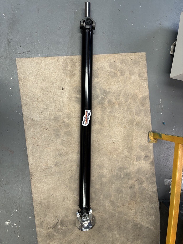

Decided to get a tailshaft made so that I can physically check alignment of gearbox and diff, then I can lock down the engine mounts and finish the gearbox mount.
Final drive have made my last two tailshafts so it was a no brainer to go back to them.

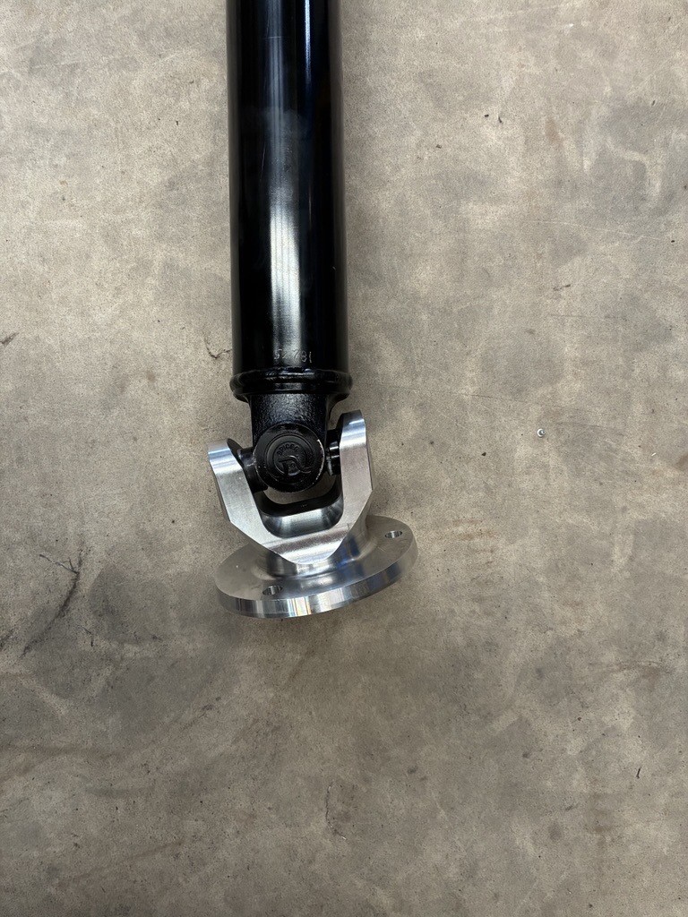

They provide an adapter at the diff end that eliminates the rubber donut that VE diffs use and gives you a Uni joint at both the diff and gearbox ends.

Not cheap but really great quality.

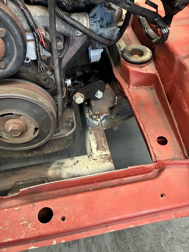

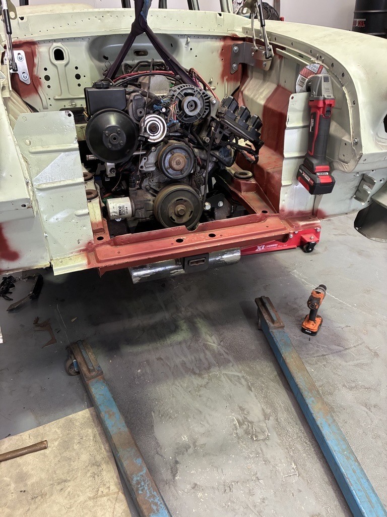

Got into the workshop this weekend and after having the engine and gearbox in and out 3 times I finally got it to where I think it is closest that I can get it to the right angle and the tailshaft again as close as I can get it.
Image (3).jpeg (251.22 KiB) Viewed 1283 times
Welded the mounts in fully.

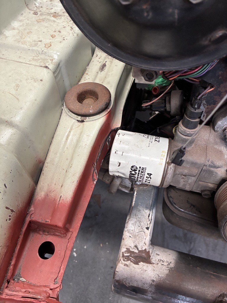

Relieved the chassis to be able to get the oil filter in and out.

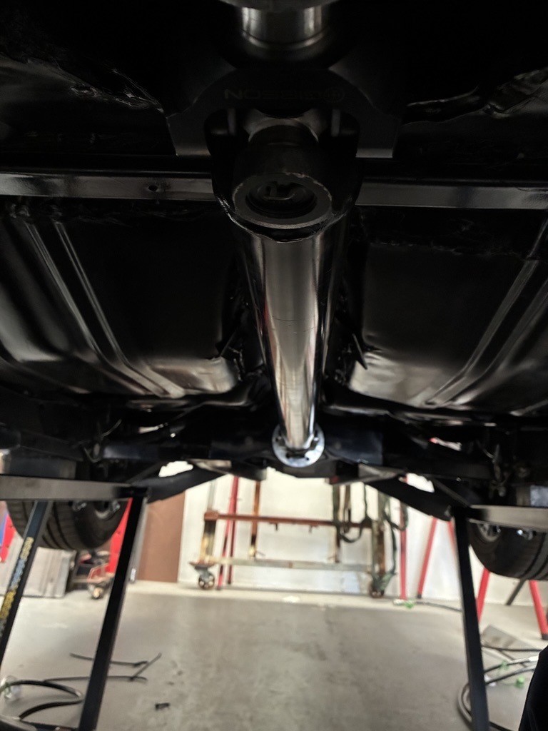

Think the tailshaft is close or as good as I can get it :crazy: :crazy:

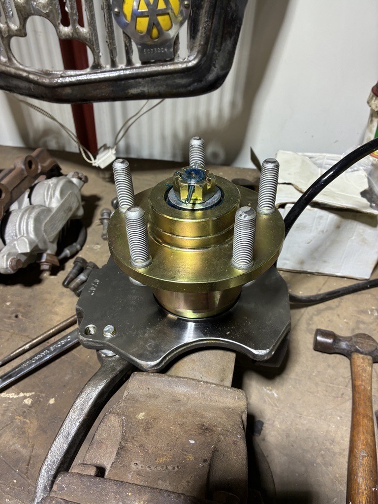

Finally received drop spindles and came up against the same issue I had with Frank.
Adapters fitted to stub axles.
Image (12).jpeg (215.75 KiB) Viewed 350 times
Ground clearance on the VT twin piston callipers
Image (13).jpeg (164.94 KiB) Viewed 350 times

Good progress Neil, the adapters are a bit of a worry if they are supposed to suit that calliper.
