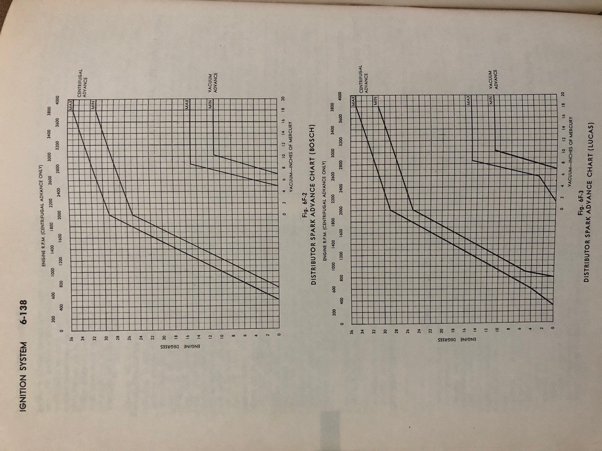

But I'm not sure what a std red motor timing should be at idle and rpm etc.

Love it Clint. Start the timing at 6 - 8 degrees static.

mph wrote: Sun Dec 19, 2021 5:54 pmBut I'm not sure what a std red motor timing should be at idle and rpm etc.
HR specs below for the 161 HC big block:
161 HC advance curves HR Holden.jpg (690.68 KiB) Viewed 5133 times

Thanks guys, still have not been able to get back on and have a play around with the fb. Thanks for the timing pics harv they will be a great help.
