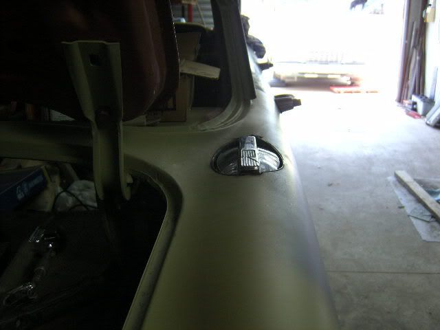

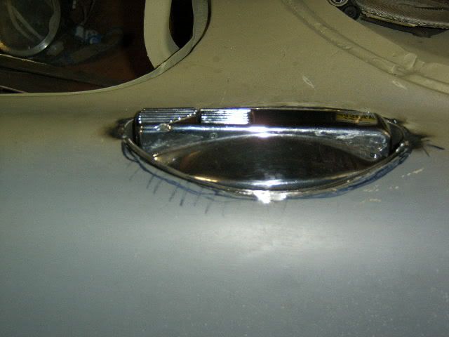

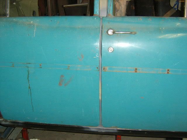

Have done the Jag filler cap trick semi frenched on top of the guard
The door gap now the filler strip is gone.

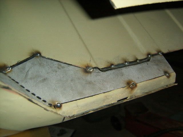

Started on the last bit of rust on the drivers side. It wasnt through just pitted so the whole lot came out. Tacked with mig then will be hammer welded with the oxy.

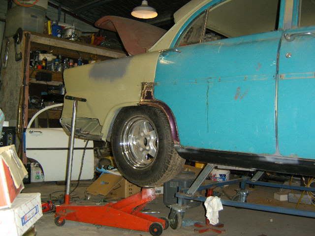

Malcolm a shot for you! Just love the big tyre look.

The wheel picture looks good, just too much tyre and not enough rim.

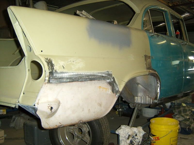

Thanks heaps for the guard section, Im still stunned that it had no rust! What was the rest of the car like?

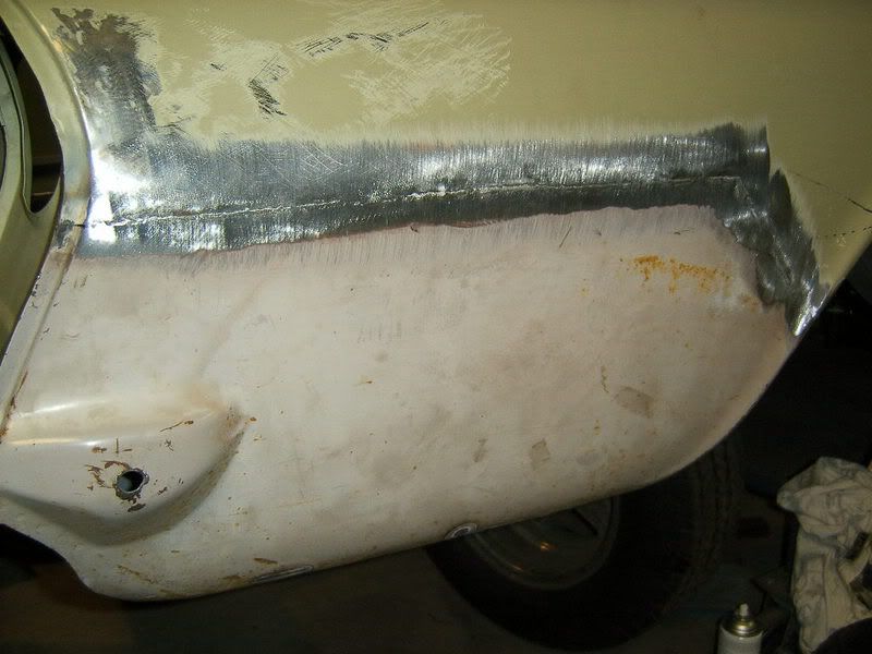

Anyway ive welded it in last night and its looking like a car again.
I got fed up with the mig and bit the bullet with the oxy only cause I can get at it to beat. Some distortion but nothing a couple hours of dolly work wont fix. Oxy welding actually stays soft unlike the mig and I will file finish this section on the weekend.

Hey Greg,
That repair looks really good. My parts car was a one owner FB wagon that had been rolled onto its side by the 70 year old woman that owned it when she swerved to miss a cow on her property, it had very little rust in the whole car, but where it did have rust was in strange places. I used 3 of the 4 doors and 1 front guard on my sedan. The panels had practically no rust at all. It probably would have been a good car to do up, but I don't like wagons.

Great looking work there Greg.
Can't wait to see her in the flesh, looks like you've got the door gaps pretty good from what I can see there.

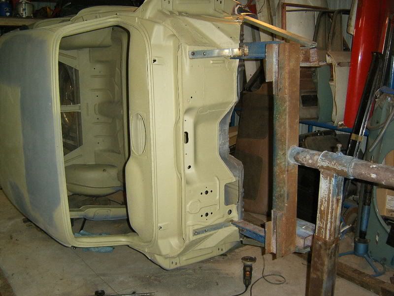

Finaly got hold of a rotisserie that Ive been wanting for years phew!

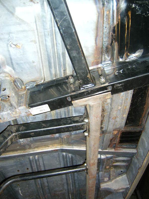

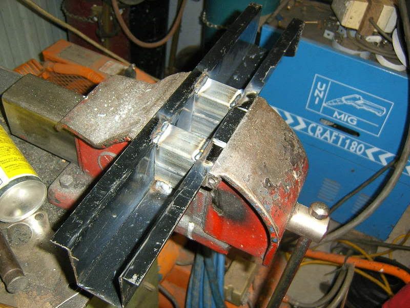

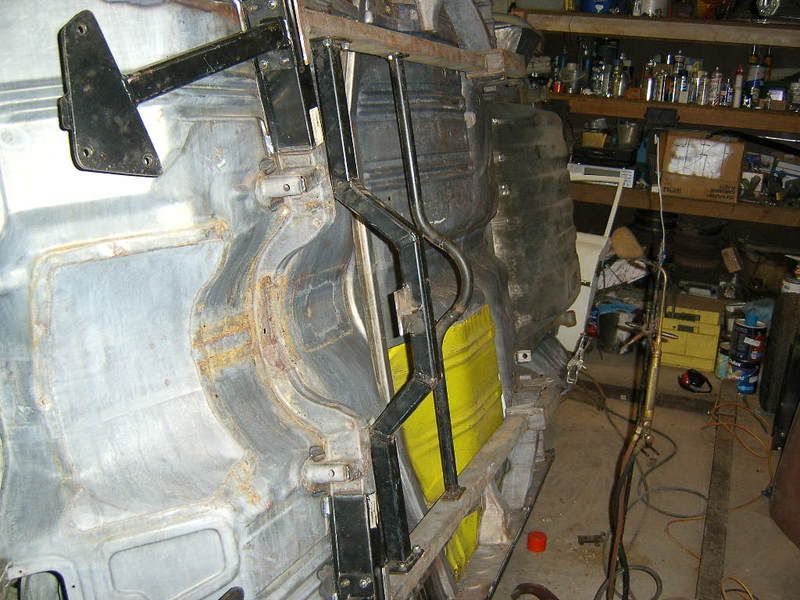

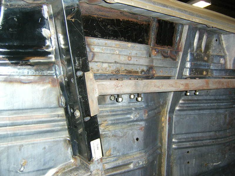

Started on the front floor braces and chassis kit.

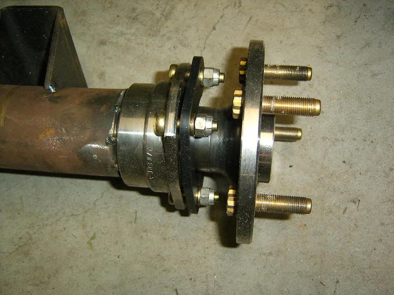

And also started the diff . It is a 9 inch with Mark Williams 31 spline axles and bearing ends.
With the combo Im running it should be unbreakable. :roll:

i agree, moving at a good pace! the diff sure looks pretty solid :)

Got the floor braces in and the chassis kit in and when I measured everything I was only 1 mm out of square, I think it was sheer luck rather than good planning! :roll:
By the way if anybody decides to measure how square their cars are they may be in for a surprise ( not real good from the factory!) :shock:
