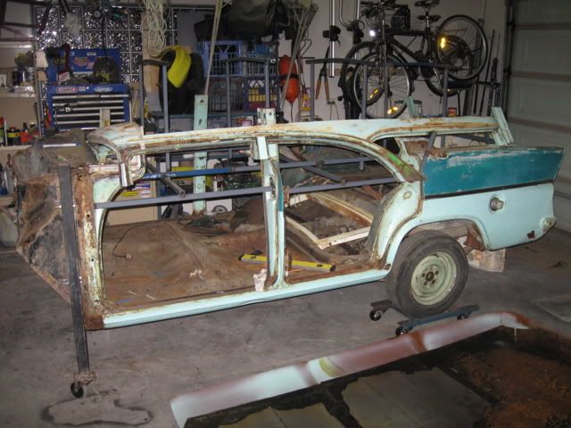

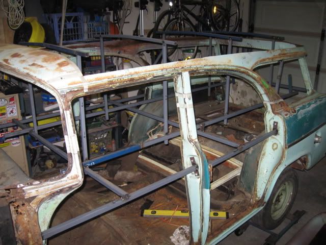

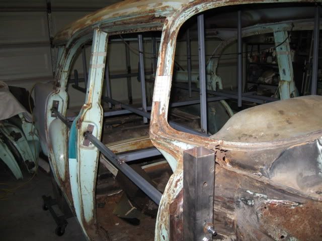

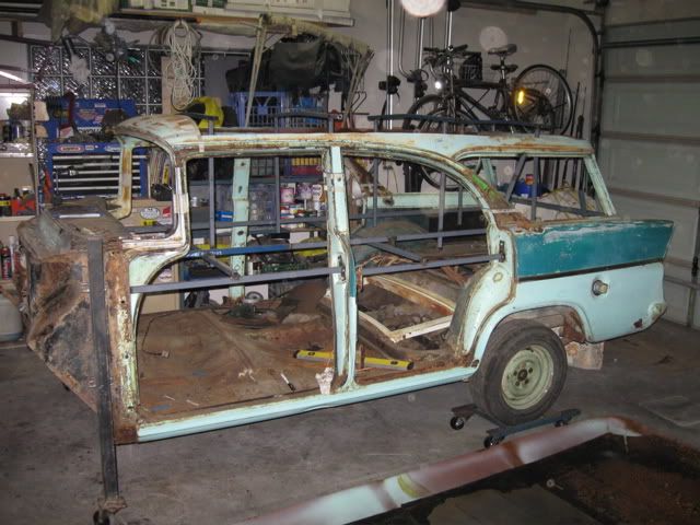

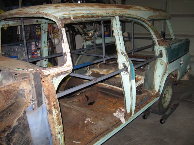

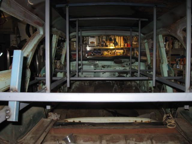

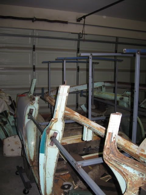

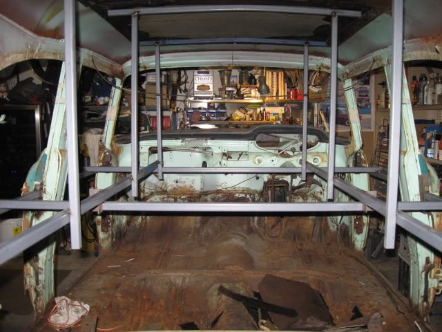

Re: My CHOPPED FB wagon project
Bracing is done..
The cutting has begun.
.. Cheers Mark
Bloody
as Mini........................
Keep the pics flowing!!
Progress is good, don't be shy with more pic's
It will be a BIG job,looks the business,Garry emotion,ha ha then its done

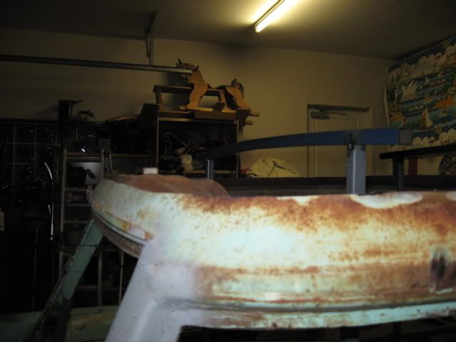

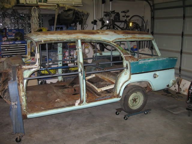

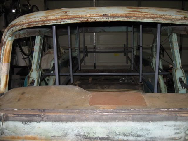

HAT IS OFF...........
Cheers Mark
WOW
In that third last pic I think the chop is going to be too low...
