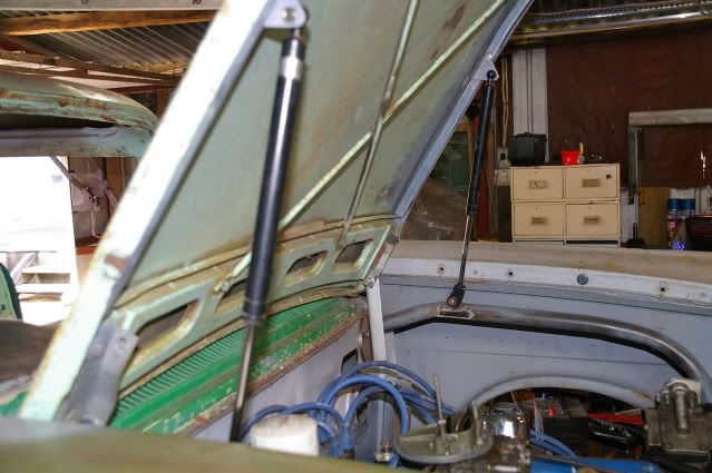

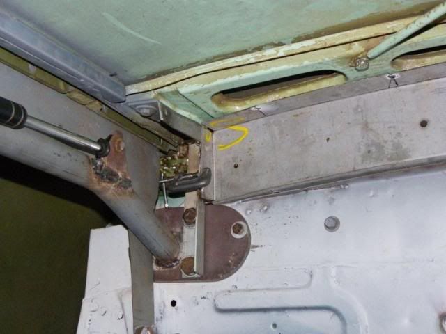

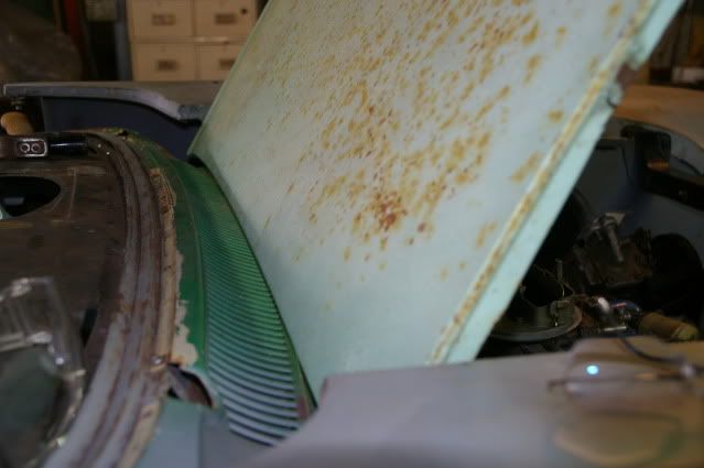

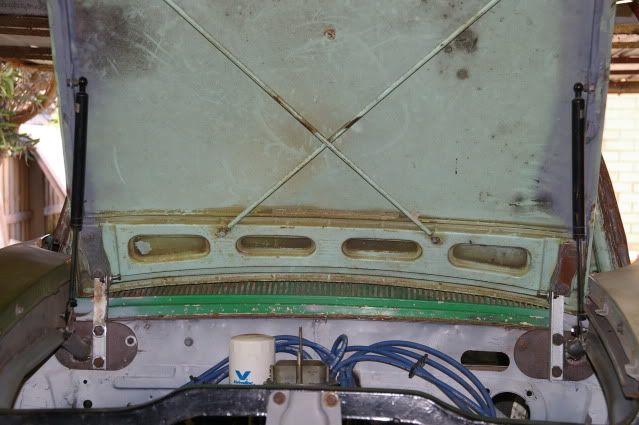

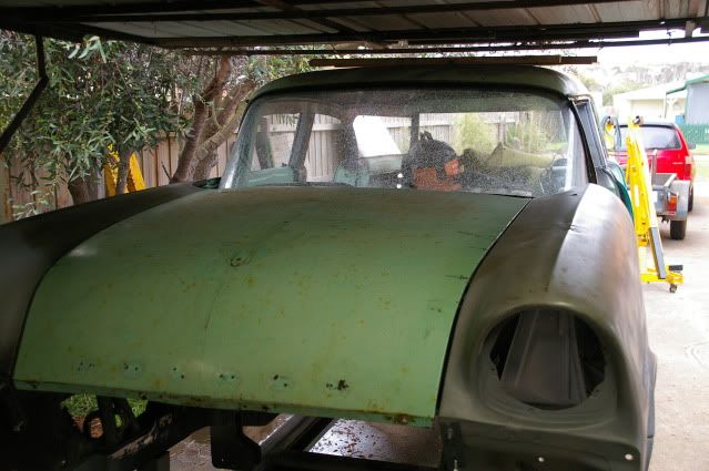

Must be winter, not much happening, but I have added Magna tailgate gas struts to the bonnet. They work really well, they take the bonnet up from about 6 inches after releasing the catch. We have made new hinges that cause the back of the bonnet to drop, this approach can only be used with our lowered windscreen, checkout the EK valance panel fits nicely missing the rear of the open bonnet, the FB panel would catch, stroke of luck really as our FB panel was too badly rusted...
now the bonnet is in, the next job is to fill in the back of the bonnet gap with a panel including a cowl air intake.

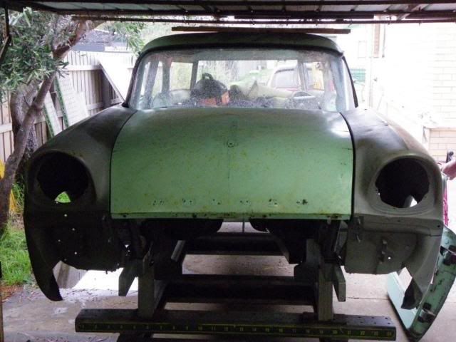

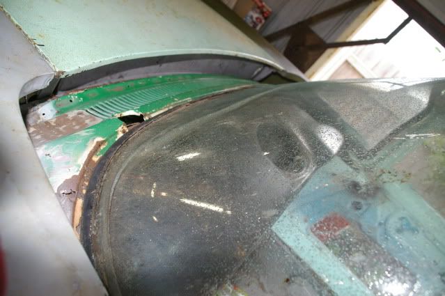

who needs a chopped windscreen anyhow....., just lower the dash. A trial fit to see what it looks like..
We are still working on the cowl induction system, and filling in all the holes. It's been a tad wet lately in VIC.
