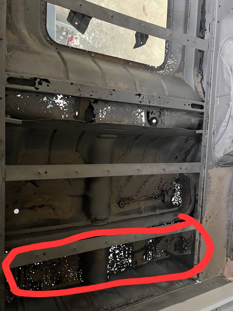

Hi FireKraka
Thanks mate really appreciated!! I'm trying to get my head around the very first part after the seat lower panel . Is it part of the sedan rear floors from rare spares ?
Pic attached . I get a bit lost in the decipher haha lots of different name interpretations for the same part . I've circled the bit I'm referring to

The red circled bit is just Rares fb/ek rear floor pans.

Hi Sneezy as Brett has said.
You will find that the floor pans between models are basically identical the really only difference is the fuel tank area, Ute, Panel Van and Wagon all had the square fuel tank, you can even see there in your photo where the back seat floor support is :crazy: for the wagon and sedan back seat
I've actually got a full fuel tank surround that I'm probably not going to use that was donated to me by Wrong Way Roger, Thanks Roger, mate you may want to use that also.

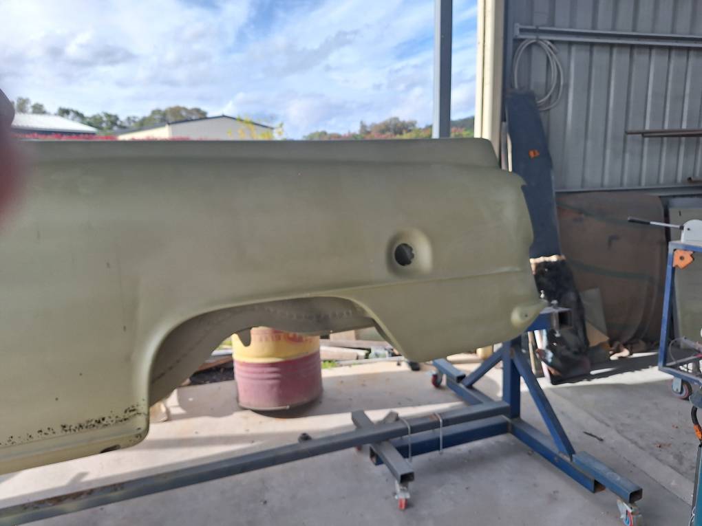

Posted: Mon Jun 03, 2024 10:03 am
by Sneezy1211
So the panel beater is ripping in , has replaced the left rear quarter so nice to see it straight again after all these years .. I was lucky to get a hold of a genuine nos rear quarter panel 10 years ago and held onto it.

Re: Family Affair Ek Ute
Posted: Mon Jun 03, 2024 10:22 am
Little bit confused here, how much of the rear quarter did you replace ? Was it a full ute/van panel you had or an FC wagon rear quarter ?
Posted: Mon Jun 03, 2024 11:45 am
by Sneezy1211
Blacky wrote:Little bit confused here, how much of the rear quarter did you replace ? Was it a full ute/van panel you had or an FC wagon rear quarter ?
Nice progress either way Image
Hi Blacky
Was a ute half rear quarter
