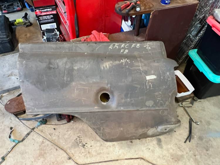

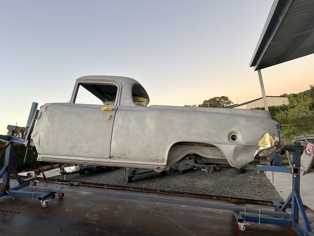

So the panel beater is ripping in , has replaced the left rear quarter so nice to see it straight again after all these years .. I was lucky to get a hold of a genuine nos rear quarter panel 10 years ago and held onto it.
Have ordered a heap of stuff from retro rods , they are now doing floor panels for the Ek probably not on there sites yet they only pressed the first lot last week. Have also got some stuff coming from Thomson's.

Little bit confused here, how much of the rear quarter did you replace ? Was it a full ute/van panel you had or an FC wagon rear quarter ?
Nice progress either way :thumbsup:

Blacky wrote:Little bit confused here, how much of the rear quarter did you replace ? Was it a full ute/van panel you had or an FC wagon rear quarter ?
Nice progress either way Image
Hi Blacky
Was a ute half rear quarter
