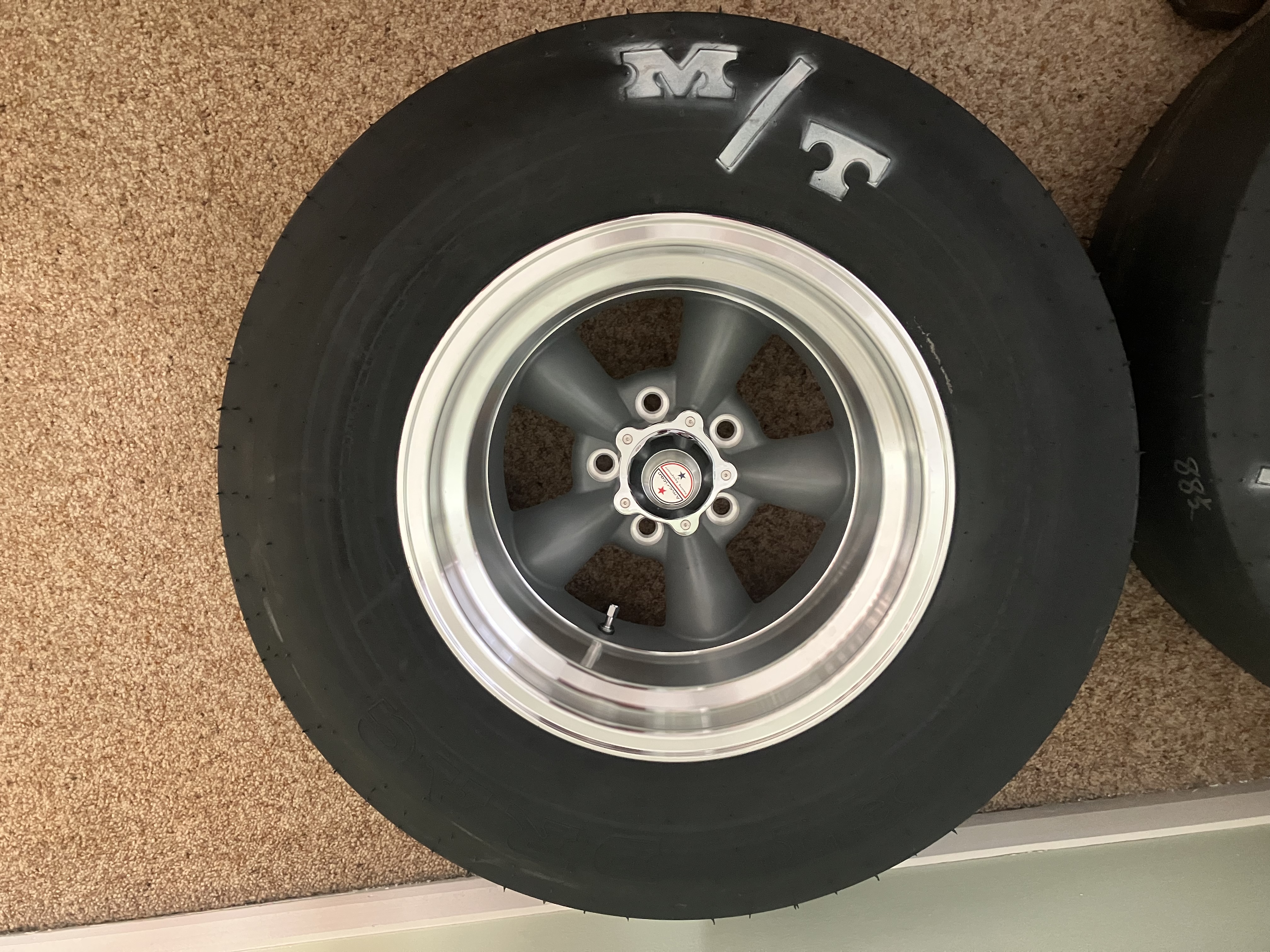

New shoes. Wheels still waiting on the courier :(

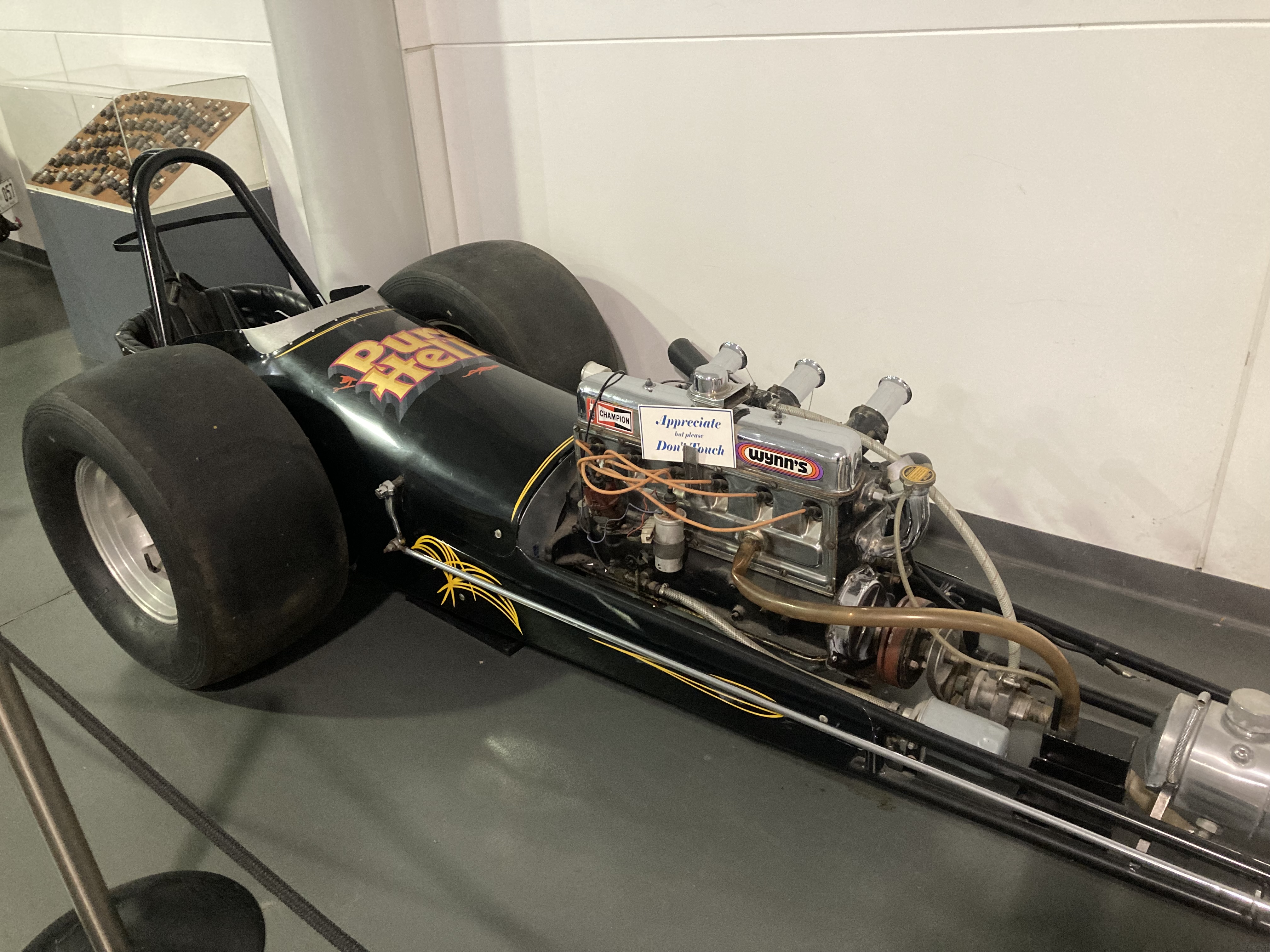

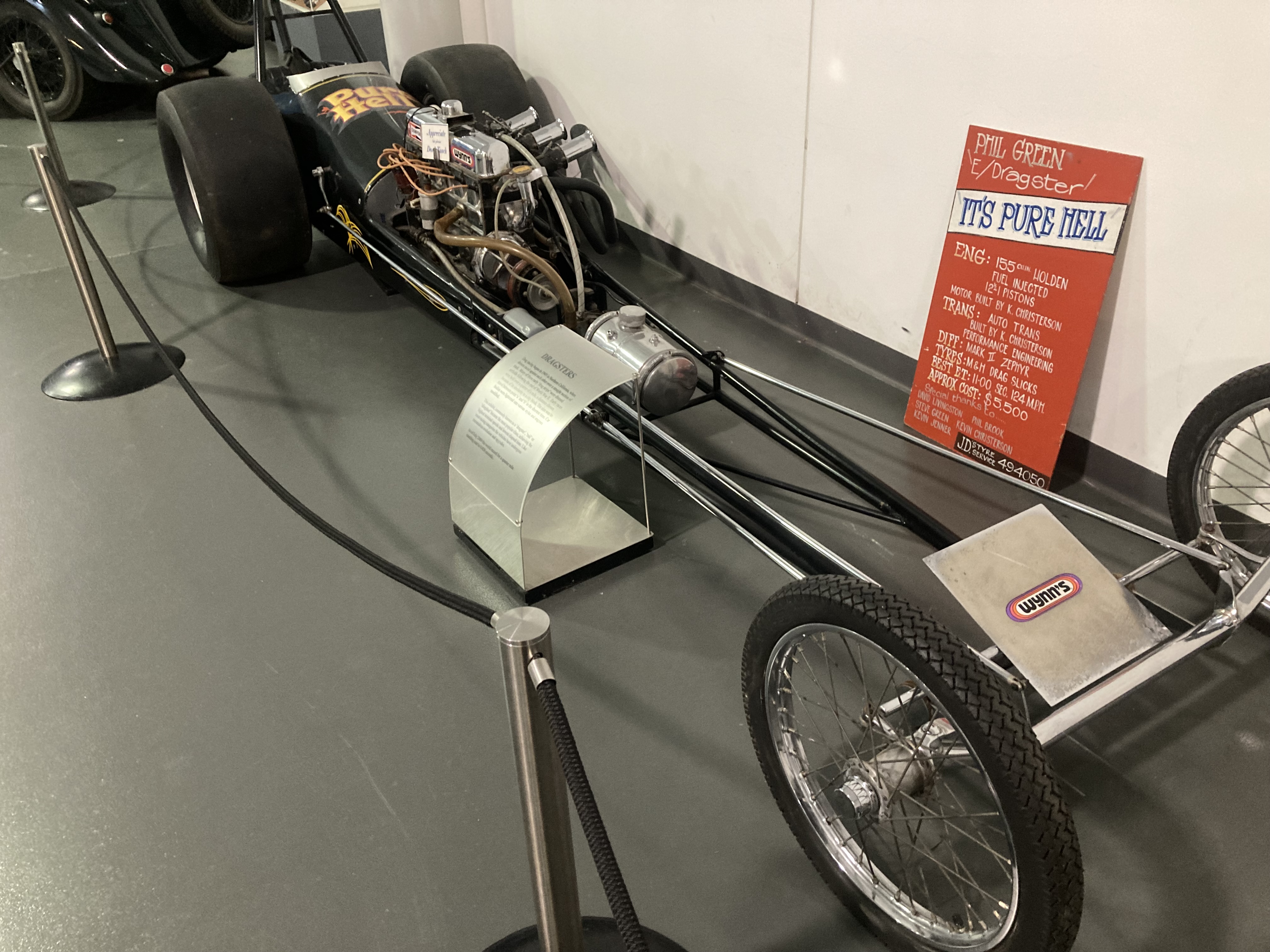

BS wrote: Sat Jun 11, 2022 9:49 am Crook as a dog with the flu lying on the couch watching the winternats live stream and seems to be a heap of front engine dragsters running in modified this weekend. Got me thinking how bloody cool it would be to see a grey powered front engine dragster in the mix!
Like this ?
National Motor Museum Birdwood.

As close to the Pure Hell FED as IHRA rules will let me 8)

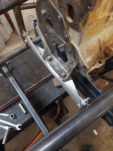

Timing cover leak drip tray Front engine mount:
front engine mount.jpg (90.94 KiB) Viewed 3373 times
Rear engine plate (needs trimming):
rear engine plate.jpg (122.09 KiB) Viewed 3373 times

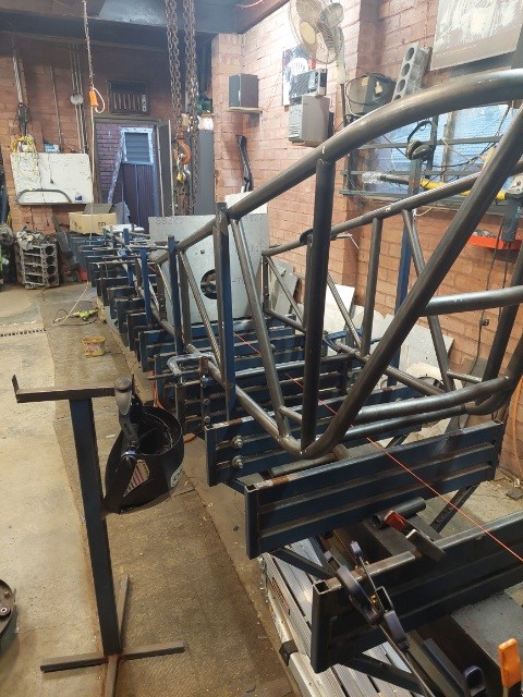

Posts: 5741
Re: Harv's FED thread
Yep, Richard Botica.

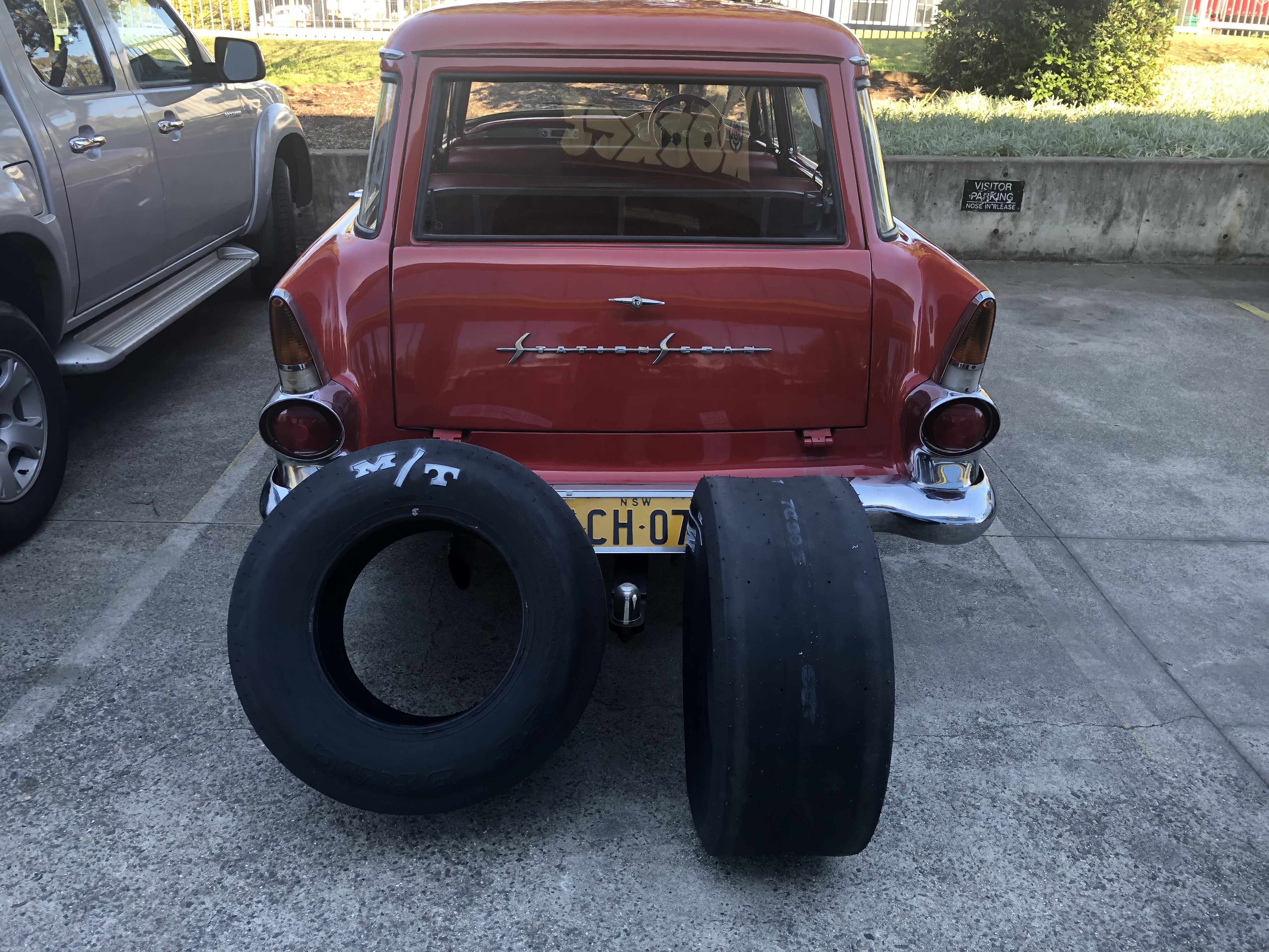

Tyres on:
This gives you an idea of scale…Number One Son’s VL front wheels are 19s. The FED wheels are Chev pattern… horribly close to Common-door. Suspect if his wheel wells were bigger then I would have come home to two worn-out slicks 🙄
