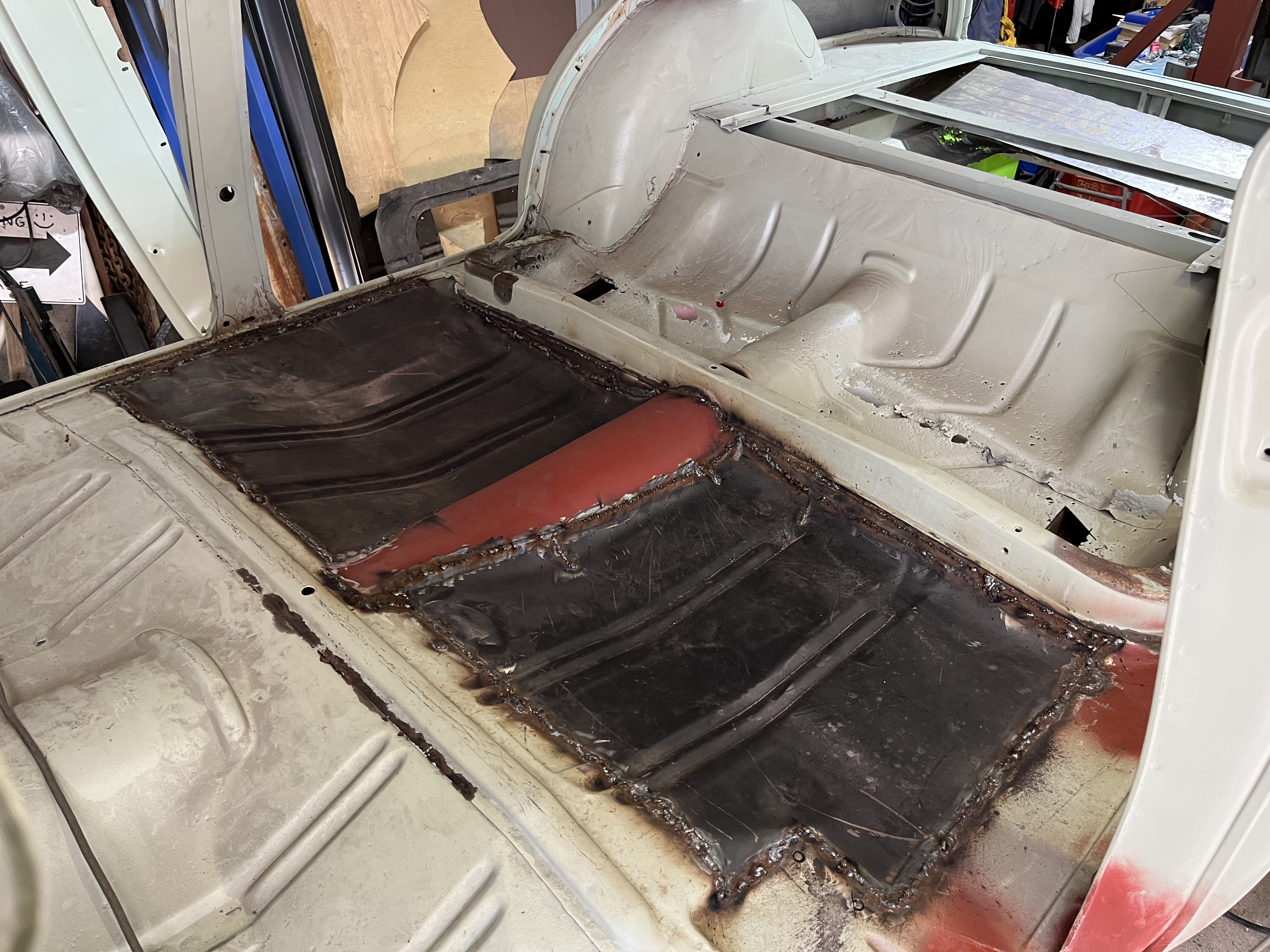

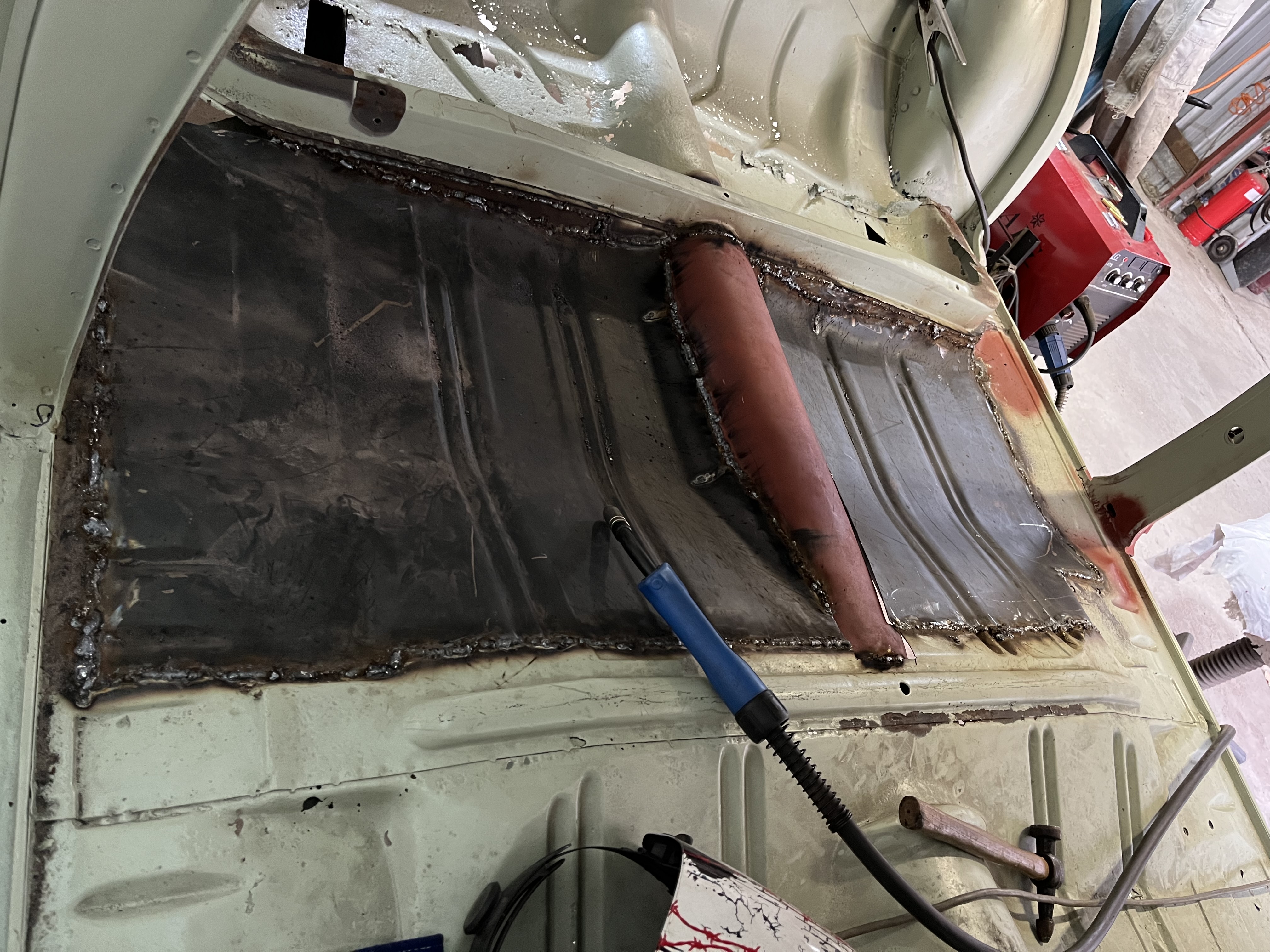

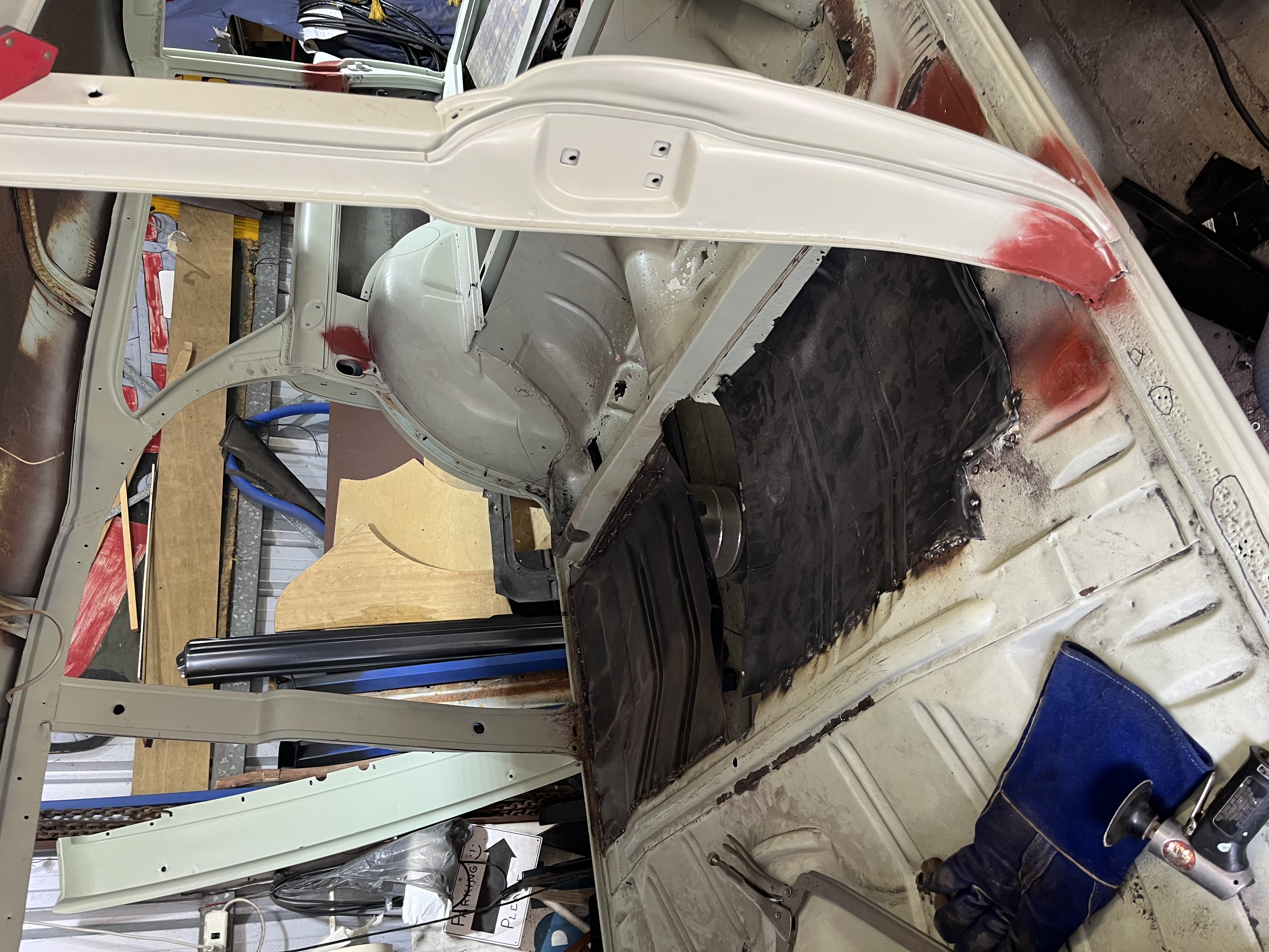

I've had a couple of reasonable weekends in the shed lately and got a bit more done but I think I have a mental health problem I seem to make holes, fill holes and then just make more to fill, anybody know a good physiatrist :crazy: :crazy: :crazy:
got to this stage good Friday and ran out of gas :wtf:
Got gas on Saturday and finished welding the tunnel in
Then just for giggles and shit I thought I would make another hole
And the leftovers

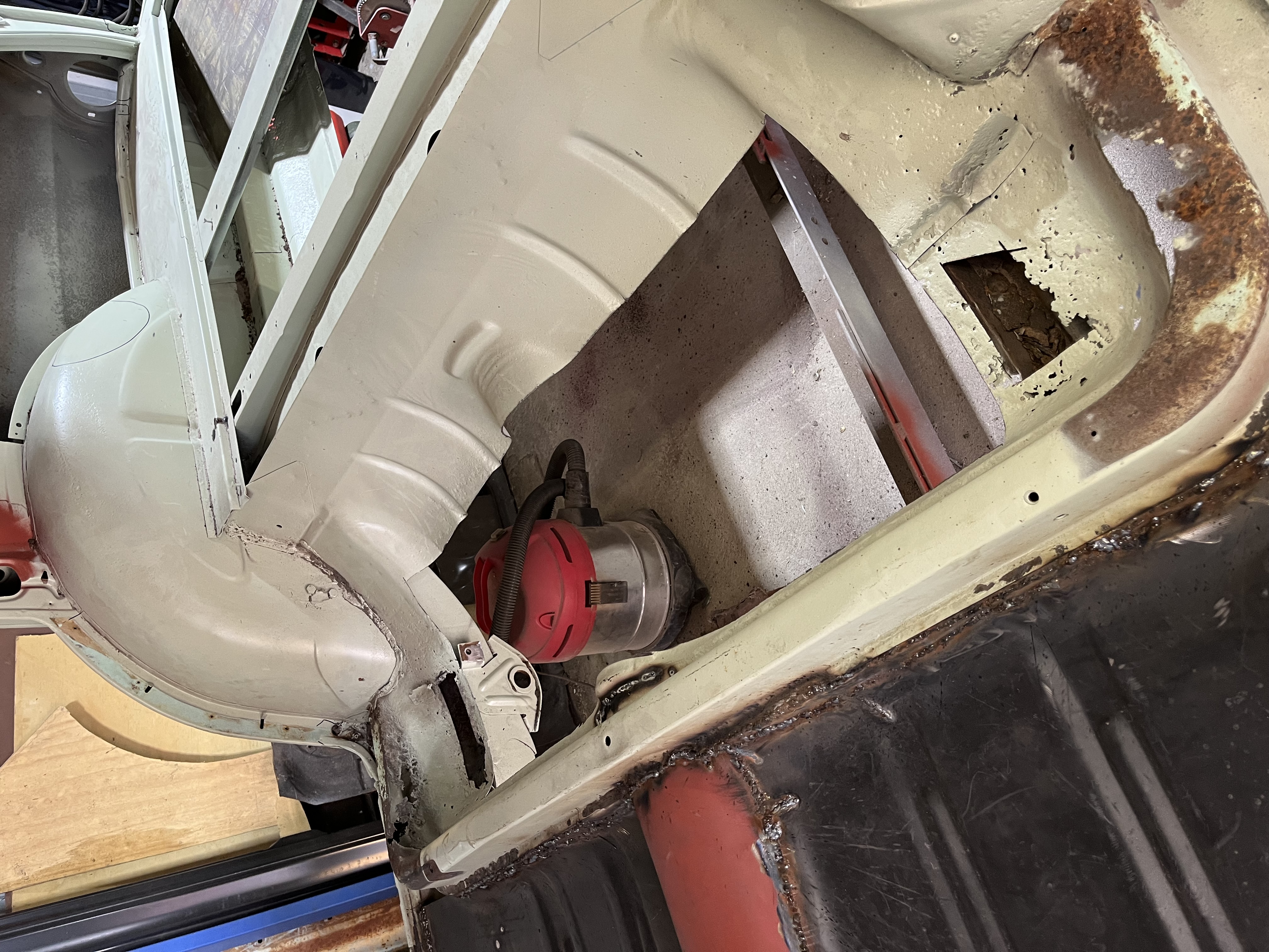

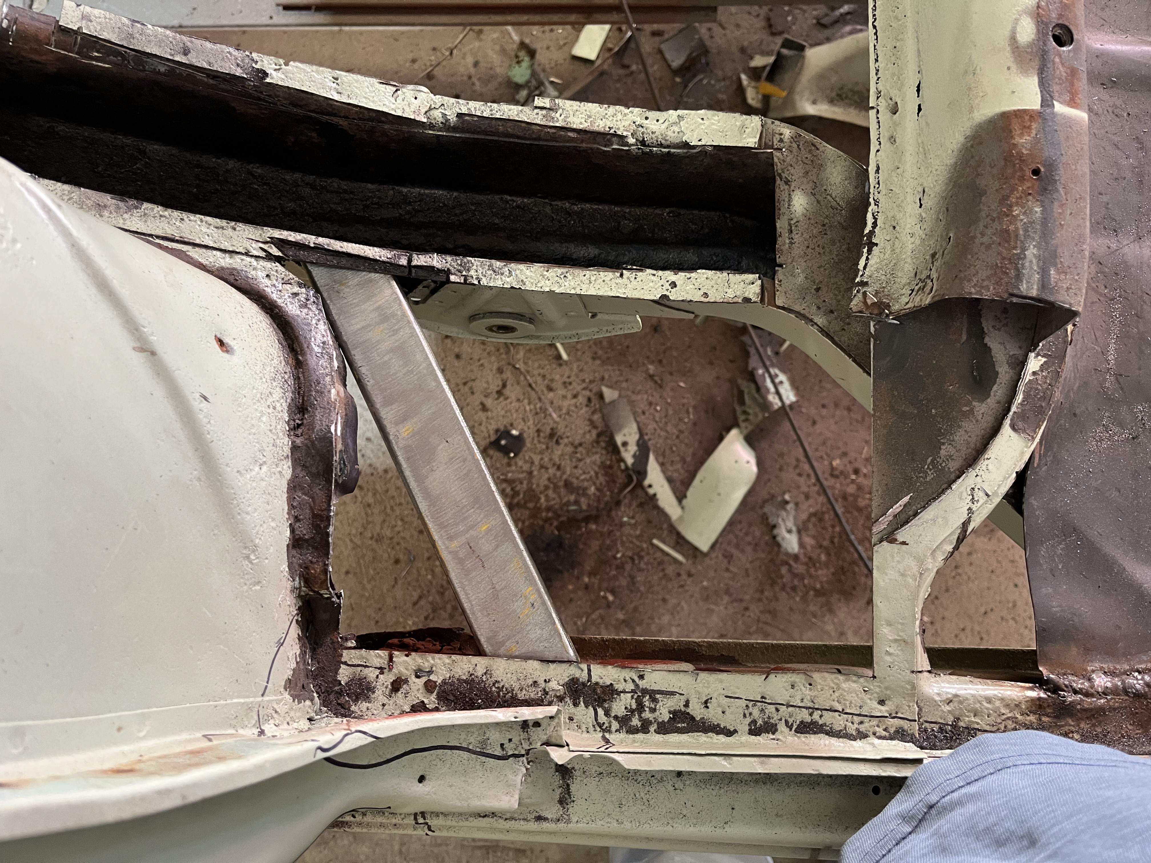

For those interested, to be able to fit the rear independent suspension cradle I have to cut a section out behind the original diff hump, V6 Conversions supplies a plate you have to bend up and weld in, this means I will have to have a custom fuel tank made.
The plate is roughly bent and sitting approx. position in the back
And from underneath
I will have to drill out the spot welds on the old top shock mounts and then cut that area away, looks like I would lose about a quarter of the original tank area.

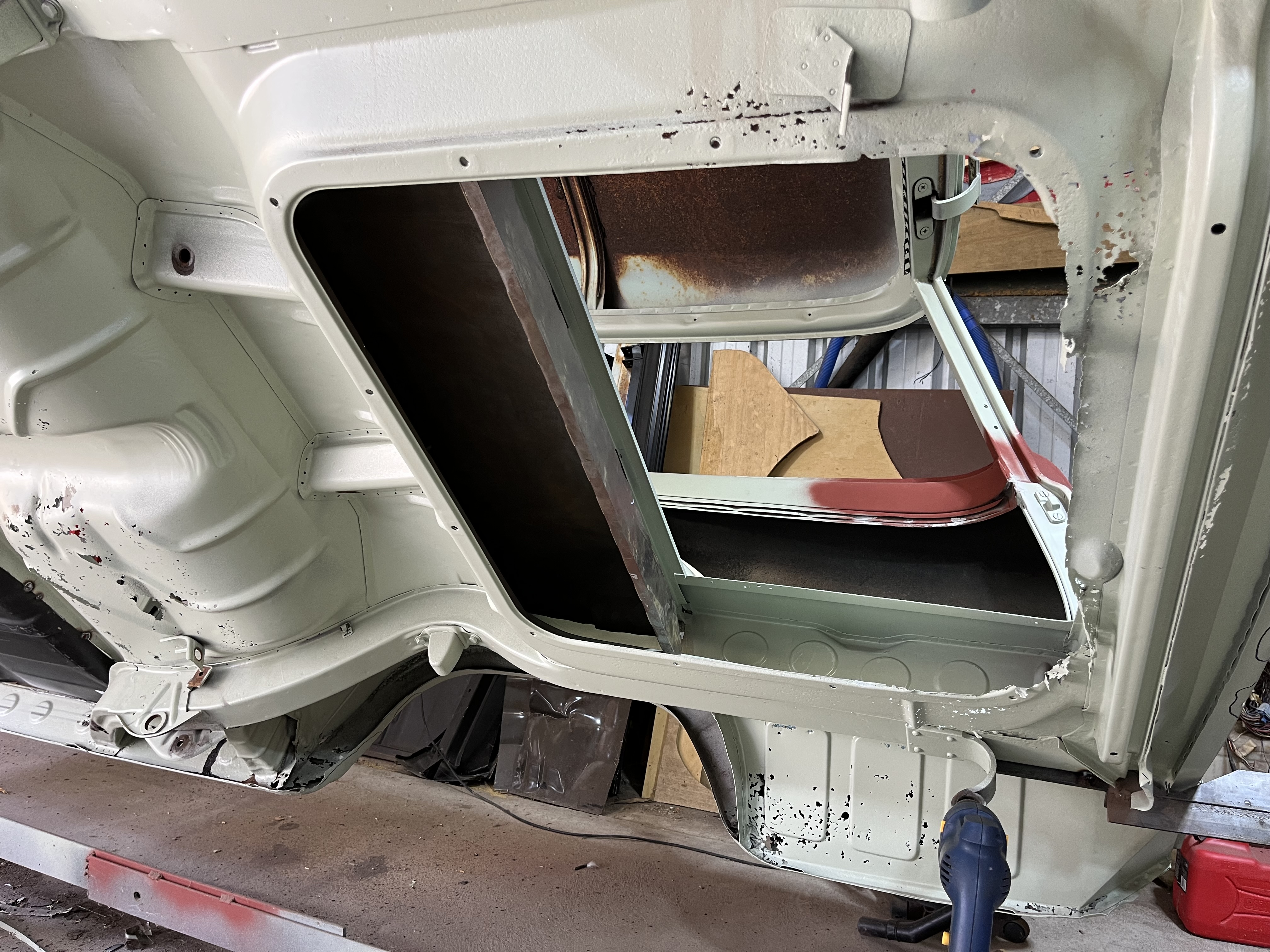

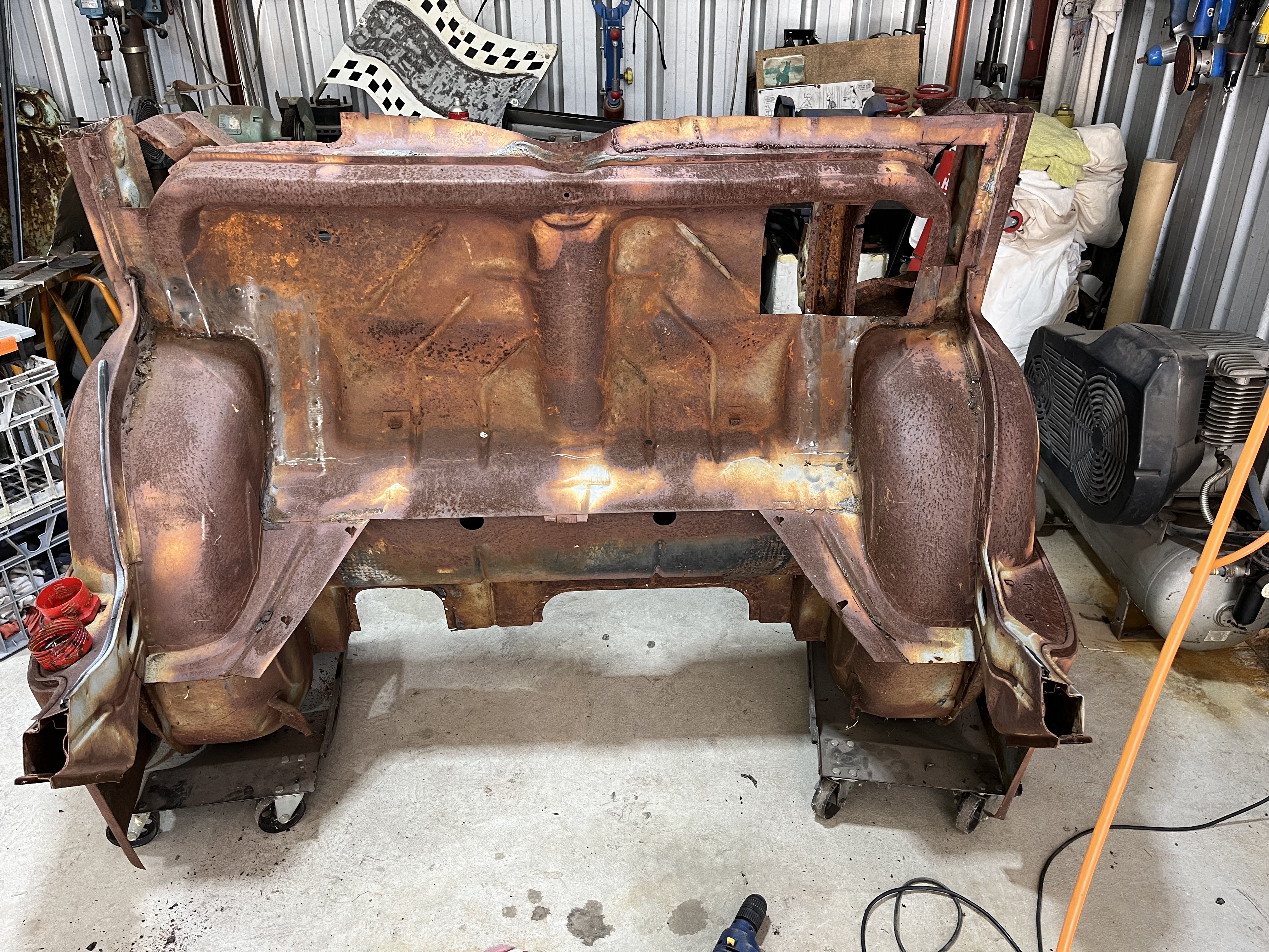

A little bit more done on the weekend.
EK mart kindly donated, in exchange for Bourbon of course :thumbsup:, now my least favorite job of unpicking multiple spot welds to get the pieces that I want to use.

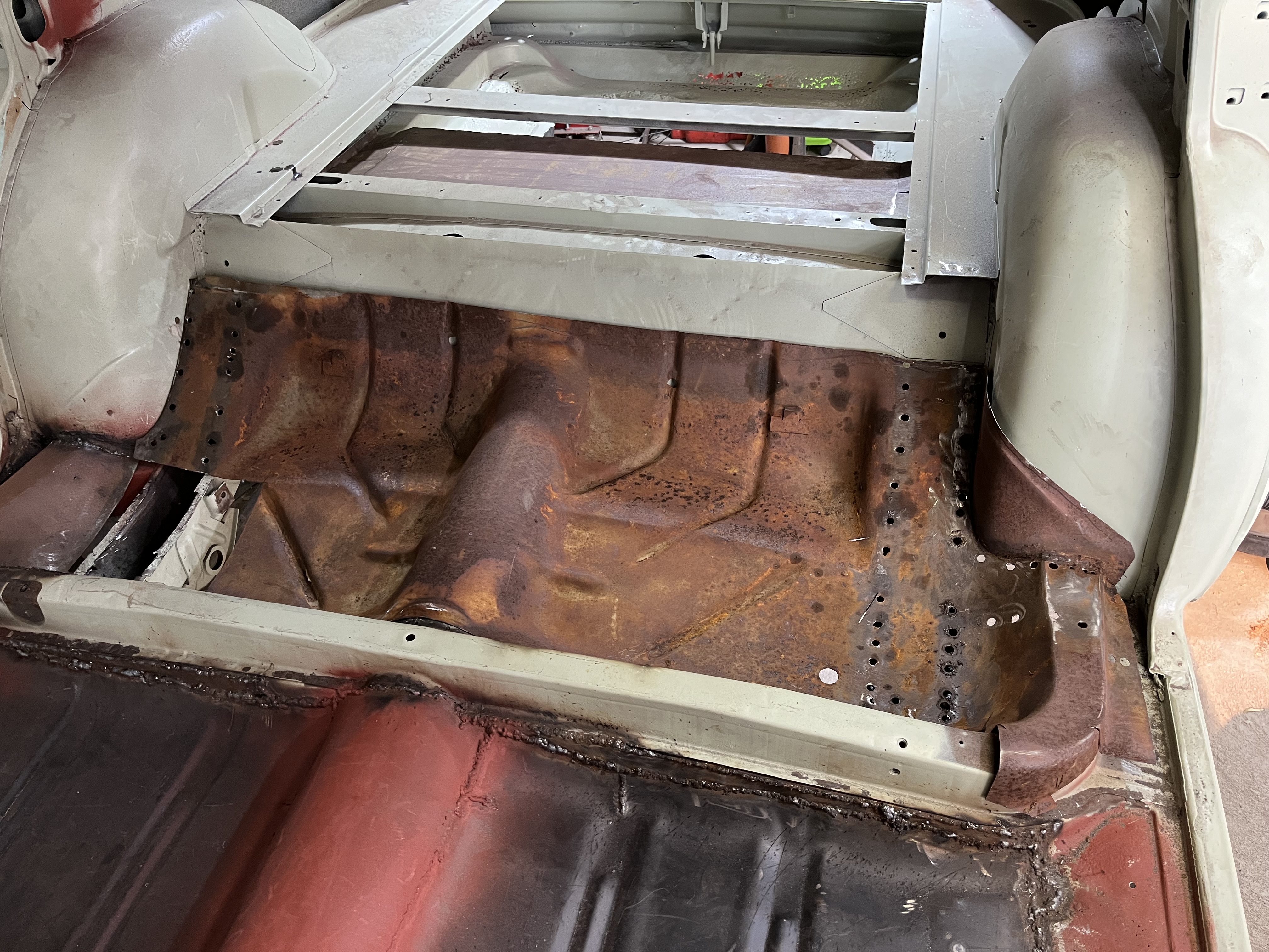

Got stuck into the donor section (thanks again EK Mart) and starting to get the piece ready to fit and weld, there is a bit of structure underneath that needs work as well.
Also part of the wheel well on the passenger side
Posts: 11661
Re: Neil's FB Station Wagon
Serious patch panel Neil. The old patch on a patch is a familiar scenario. I just noticed a bit of bracing added in the torque box area which no doubt was made a bit easier by absence of the floor. Are you going to give the inner wheel tubs a massage? Having the floor out would make things easier in that area too.
