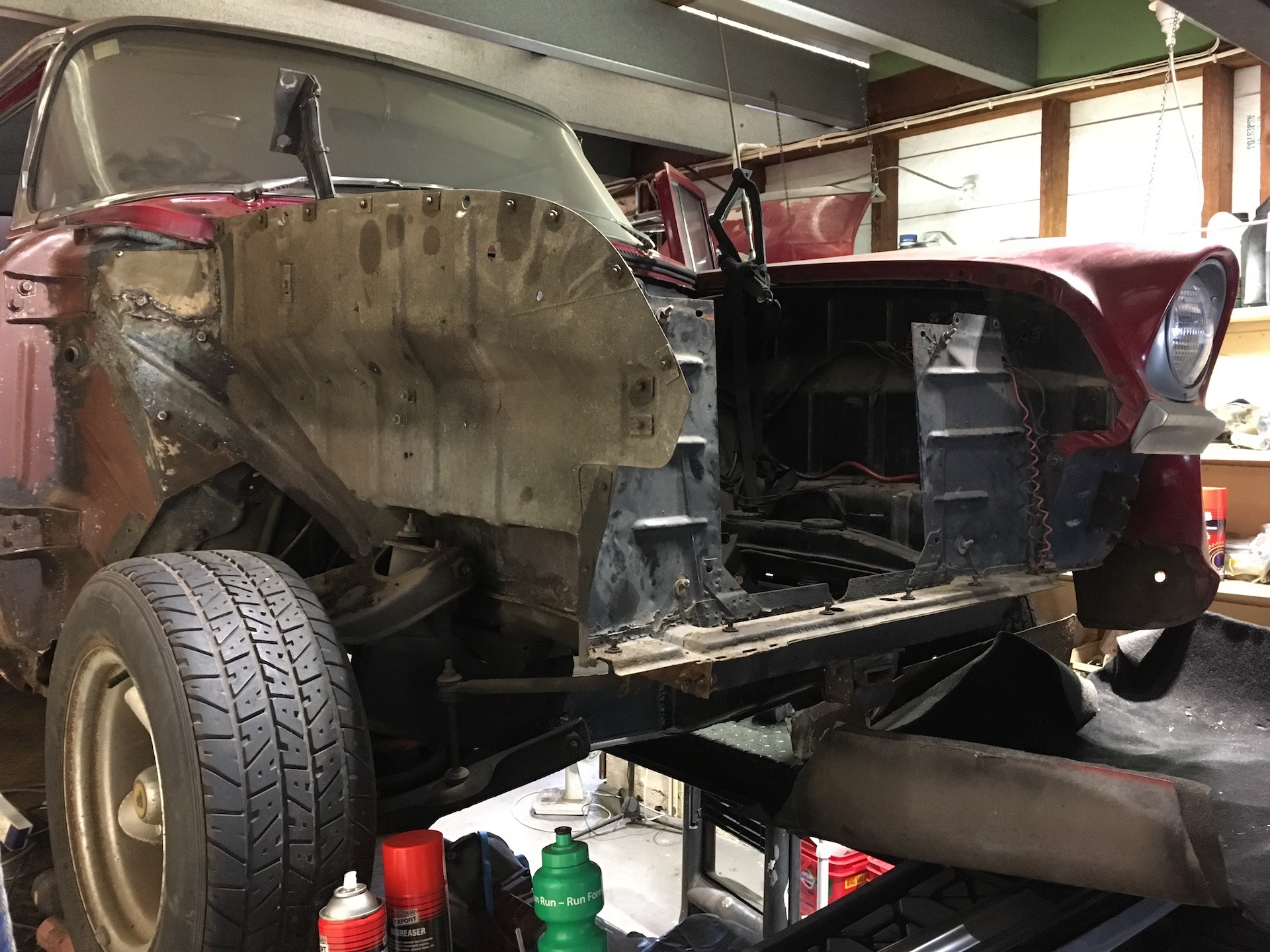

Re: Ol' Rusty - FB/EK Sedan
Posted: Sun Nov 15, 2020 1:08 pm
by funkyscooter
Guard Off.JPG (691.35 KiB) Viewed 1604 times
Time for the guards to come off. Notice the repair to the subframe. Section above the bolts has been replaced. Is this a common rust area?

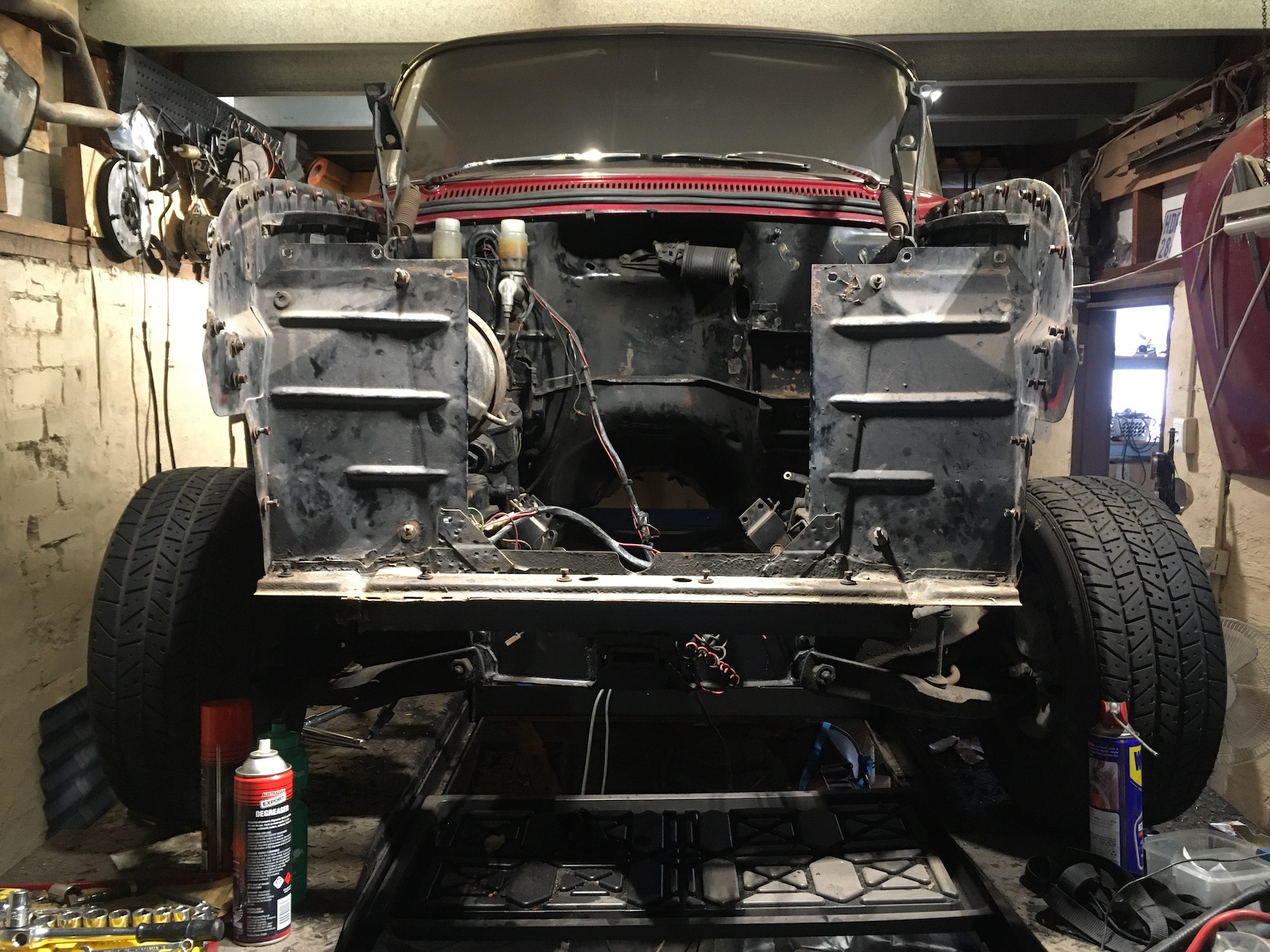

Posted: Sun Nov 15, 2020 1:11 pm
by funkyscooter
Guard 2.JPG (724.06 KiB) Viewed 1603 times
The wide angle on the iPhone give the car a decent toe out

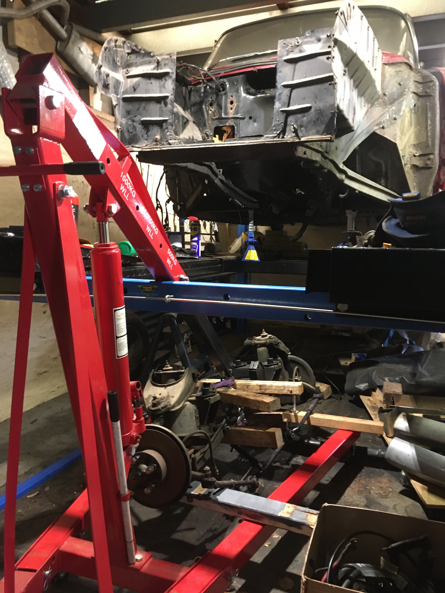

Posted: Sun Nov 15, 2020 1:14 pm
by funkyscooter
Front end out.JPG (653.02 KiB) Viewed 1602 times
Not too many bolts and there’s the front end out.
Posted: Sun Nov 15, 2020 1:21 pm
by ardiesse
Your subframe looks original to me: it's a Hydro subframe, matching the Hydro body. Rough-ish spot welds on the radiator supports, but that's normal factory finish.
Posted: Sun Nov 15, 2020 1:30 pm
by ardiesse
Second attempt. The section above the bolts. I was looking at the front tie member. You mean the bit where the subframe bolts onto the body near the driver's side A-pillar. Yes, that's definitely a repair.
