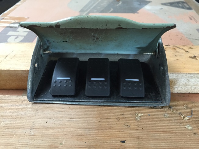

Replacing the switches on the dash with the gauges shown previously and adding 3 rocker switches into the ashtray, wipers – heater and driving lights.
I have not had the switches engraved yet but likely to be in modern style.
Temp set up for photo only, lots of filing and sanding to go.

I'm trying to find place to add cup holders without attaching anything to the trans tunnel. I'm after clean look on the interior.
Maybe a slide out from under the dash or BMW style pop out from the dash fascia using the space above the ashtray ?
The heater I just put in, blocks anything under the dash in the middle.
More time on the internet may turn up something.

One option for cup holders is to drill out the inside of the glovebox lid with a holesaw and either insert plastic liners from a modern car or weld in steel cups cut from baking moulds.
Had hoped to do similar on the wagon, but it got lost in all the other tasks.

For cup holders I reckon custom a slide out twin cup holder to attach under the dash under the ashtray - slides out when you need it and stores away for a clean look.

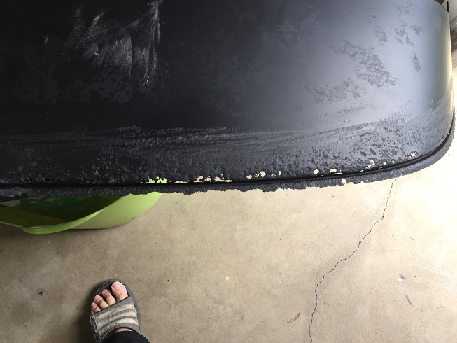

Pickup he sunvisor this morning from paint strippers, Minus Paint here in Adelaide.
As I suspected under the bog was rust holes.
sun visor 1.JPG (61.23 KiB) Viewed 997 times
sun visor 2.JPG (100.9 KiB) Viewed 997 times
Any suggestion on how to go about fixing this ?

I got a repro one from Auto cables retro spares Eltham Vic. Doesn't use the roof brackets so no need to drill holes in your roof. Welcome to have a look at it of course.

I may repair this one by replacing the rusted area with a strip of metal or bronze weld then file to shape.
I have the metalised filler that could work as this set like rock.
plenty to do before I need a sunvisor.
