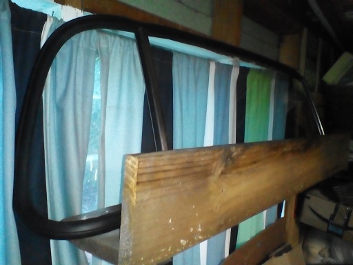

The new rubber for the rear window looked like it had been twisted up in the bag for too long. It's also a lot stiffer than the rubber for the windscreen.
Anyway, I thought I'd 'train' it, so I wrapped it around the window. Not real easy - initially I squirted soapy water on it but as it turned out that it made it too slippery and it kept sliding back out. I did the centre section first. For the end pieces, putting the top and bottom of the glass for about 5cm and then working my way around from the top did the job.
I built a temporary shelf out of crate wood for it in the shed.

Hey mate that is what I did with the rubbers for my screens, left them on for a good couple of weeks and heat in the shed during summer before they were fitted.

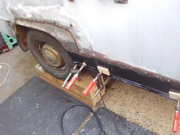

Decided to have a break from being underneath the car and started stitching in some new metal on the driver's side...pic of 'round one' attached

Wow. Did you get the lower quarter patch from Retro Spares at Eltham?

Yep, Retro Spares...about $80 each side...needed some manipulation to fit, but still easier than starting from scratch.
