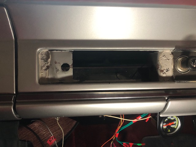

Power supply for the new radio had to be re-run, as the old radio was wired "always on", rather than "only on with the ignition"... old power leads had multiple twist-the-wire joins covered in cellotape. When I pulled the old radio out, this mess was waiting for me:
Radio slot butchered.JPG (65.29 KiB) Viewed 9732 times

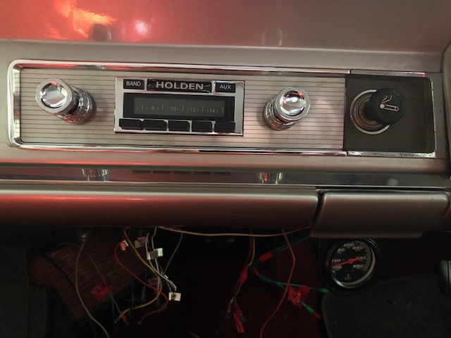

The radio slot has been cut top and bottom, and two "ears" folded back. The photo shows one "ear", complete with round radio knob hole, bent back to where it should be. Bent both back into place, and put the new radio in:
Radio in place.JPG (100.03 KiB) Viewed 9732 times

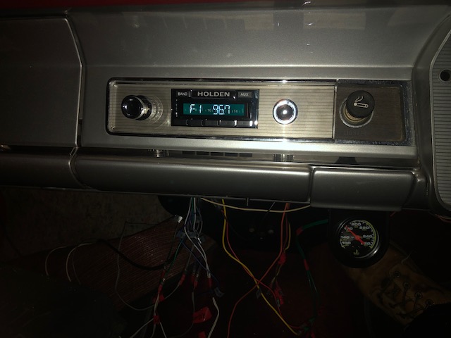

Looks good, though you can see the clash with the ball-milled insert and the adjoining cigarette lighter woodgrain. The radio has a fake clear acrylic station number plate on the front. When you turn it on, it lights up from behind with an LCD display, obliterating the station numbers:
Radio turned on.jpg (59.31 KiB) Viewed 9732 times
(... and yes... that is Radio National :oops: ). It does AM/FM, has line-in connectors at the back if you wanted to run a CD player, and has an AUX input to let you run an iPhone into it. Neat radio.
