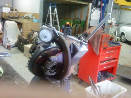

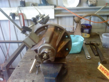

Finished off the diff centre today. New pinion seal and backlash check.
Re-sheaved rear springs. Axle bearings and inner seals tomorrow and fit up diff housing.

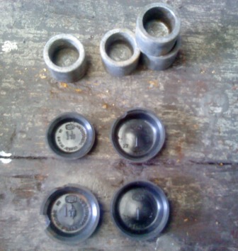

Dodgy shit some people do. Found this today. Both rear wheel cylinders and pistons measure up as 1"
One cylinder had 1 1/16" cups jammed in it. Not to mention grease under the adjuster caps. Top left is a slightly swollen 1 1/16" cup. The two right hand ones are 1" and are huge! Shit happens when you mix mineral based compounds with non compatible fluids and materials.
