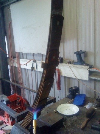

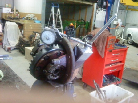

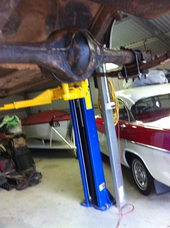

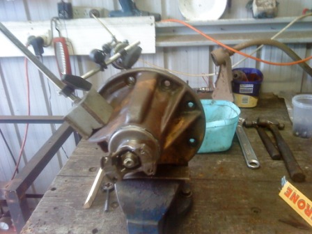

Finished off the diff centre today. New pinion seal and backlash check.

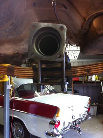

Re-sheaved rear springs. Axle bearings and inner seals tomorrow and fit up diff housing.
Also just wondering if any others have ever noted what spline type they have with regards to pinion yokes. I never released till now that they produced course and fine spline yokes for the 3.89:1 diff centres up to EJ. Only found out when I went to fit a replacement yoke and it was a fine spline......bugger.

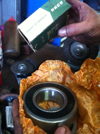

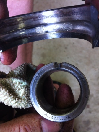

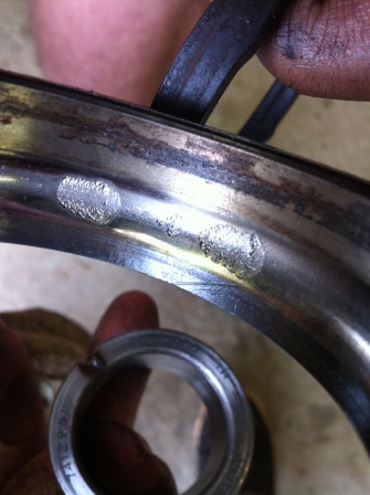

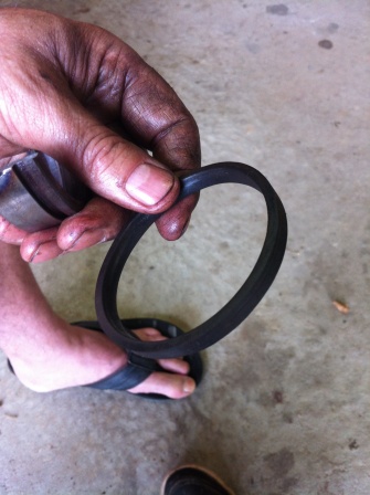

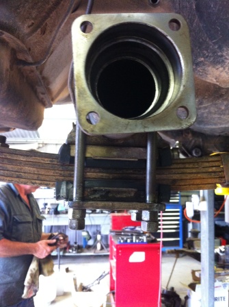

A little more progress today. Diff centre in. Replaced stuffed original axle bearings (UBC Aust made). Not bad for 53 years of work. Even found the original deflector rubbers still fitted. Took some tracking down and managed to find NOS UBC bearings to refit and NOS inner oil seals.
Inner oil seals in soak tonight for fitting tomorrow with axles.

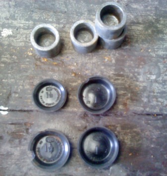

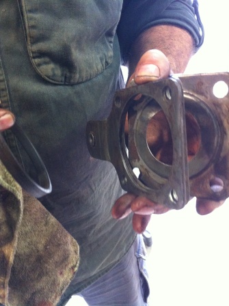

Dodgy shit some people do. Found this today. Both rear wheel cylinders and pistons measure up as 1"
One cylinder had 1 1/16" cups jammed in it. Not to mention grease under the adjuster caps. Top left is a slightly swollen 1 1/16" cup. The two right hand ones are 1" and are huge! Shit happens when you mix mineral based compounds with non compatible fluids and materials.

No surprise Tim..........they didn't return. Wheels locked up in various states. I have yet to get to the front cylinders.

Sorry Tim, they did. As I said very early on, she's a bit of a mudguard. Still trying to think of a easy way to clean out the brake lines thoroughly I.e. what sort of chemical can flush them clean as they are pretty bad. Might have to make up new ones.
Posts: 14275
Re: Seagull Grey EK 2106
So easy to make new ones , why risk it ? When I did the RHD conversion on my '46 I wiggled one of the brake lines and it snapped ! looked fine from the outside and was still working at the time.

Yeh good point Blacky. I procrastinate too much over some things. I was thinking of going over to silicon fluid later on anyway so I might as well bite the bullet...........but let me think about it. :crazy:

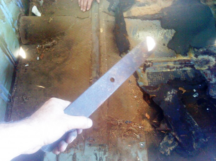

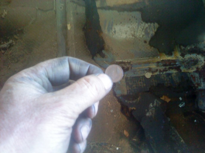

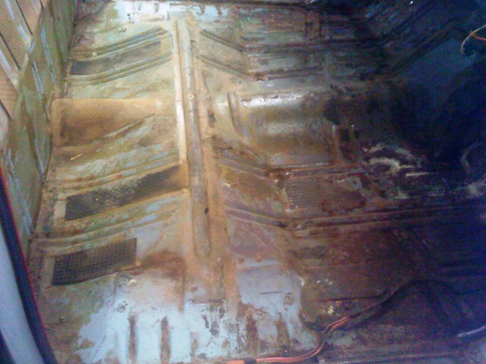

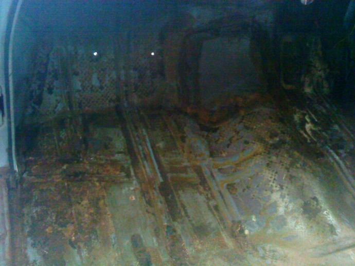

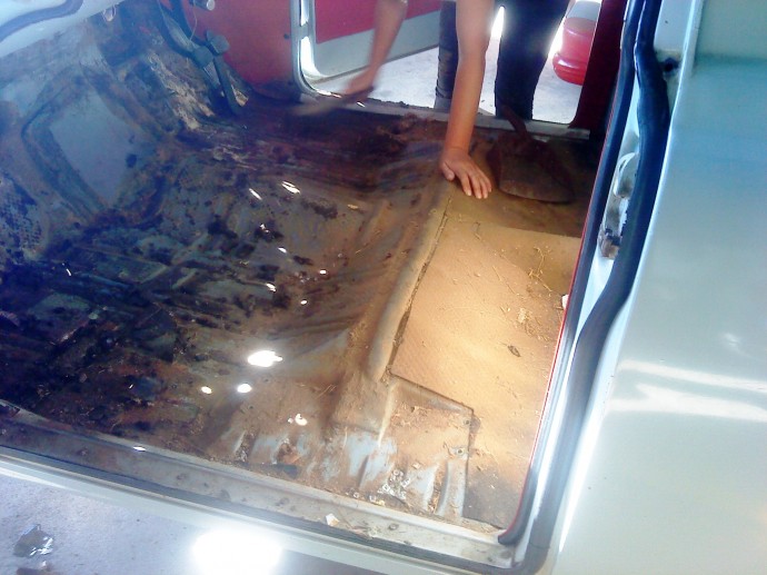

Ok a bit more done today. Stripped out the front floor as the floor mat was stuffed and there appeared to be some moisture in the past. A bit tentative as its the last lot of stuff to come out and finger crossed no rust. Anyway all good with just some surface on the drivers side from a bit of water getting past the column rubber. Bonus find under the seat was a couple of 1966 one and two cent pieces (good year that) and of course a spare helper spring off something! A good scrub down inside and out and we are good for a bit of rust prevention here and there and start on getting some gear back together. 4 1/2 months to go.

FJWALLY
Posts: 1833
Location: Forest Hill
Post by FJWALLY »
Looking great Craig.
I see you have those same glue marks on the upright section behind the seat - what was stuck on there originally as nothing was in mine when I got it.
Also i had a couple holes in the drivers side floor where the cross member goes under and I can see it is full of mud - what do you suggest to A clean it and B -protect it - do I just drill a couple of 20mm holes in either end and try and flush it out? pump as much rust converter and fishoil in as I can afterwards?
