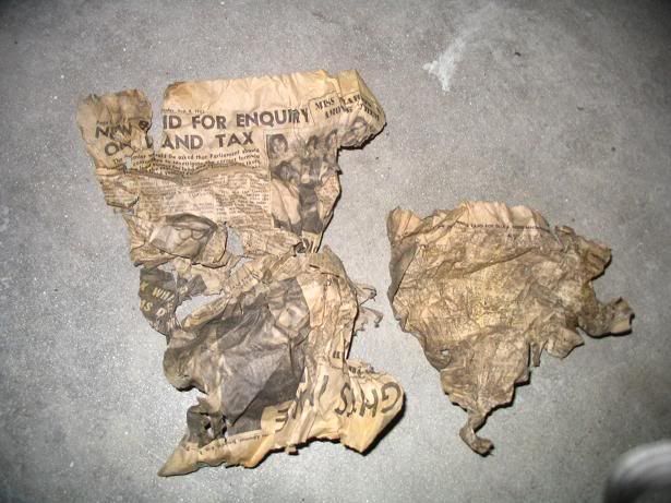

Found something very interesting today though... whilst taking the original bumper apart to remove the passenger side piece due to it being damaged i found this...
Stuffed inside the over rider was these 2 pieces of paper not giving it any thought at first i went back to them whilst packing up. Slowly un doing the paper trying ever so hard not to rip it i realised it is from the Melbourne Advertiser Saturday August 4, 1962 Now im not too sure how it got there and why but i find it fascinating. A house in Ivanhoe costs 4850 Pound

that's amazing being 1962 it mst have just about been there from new, amazed it's lasted this long with rain and such
my dad used to lay floor coverings and he was always bringing home old papers and magazines people had used as an underlay under vinyl

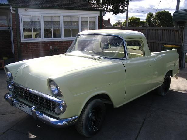

Progress has been minimal partly due to weather and a busy month in july.

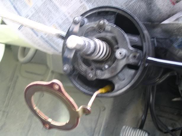

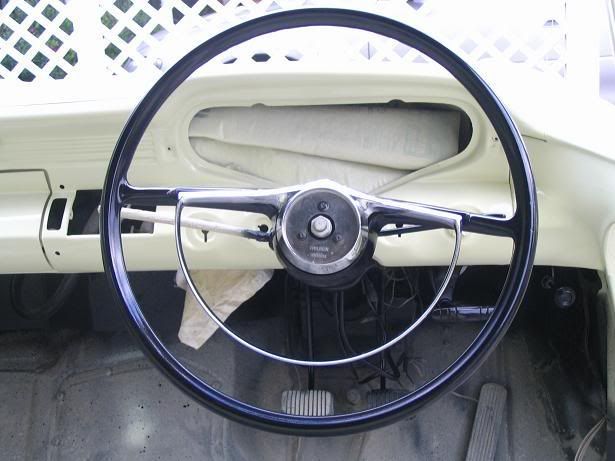

Started to reassemble the wheel with what bits i had and realised it appears im missing the horn contact where is it positioned in the assembly and where can i get one from???
Quick splash of paint to freshen things up

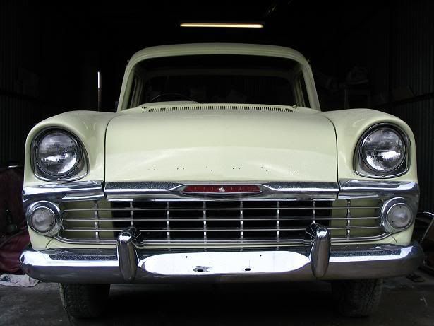

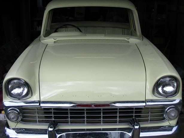

Most of the chrome back on the car, gave her a wash to remove a bit of dust and over spray
Experimenting with the chrome rings with black stockies
The ute is off Tuesday to Reservoir Trimmers where Carlo will work his magic on the inside front seat will remain as original is perfect along with door trims, only visors and headlining to be done, with new rubbers brought front and rear windscreens will also go in during this period......... Getting there

hey bud, i would hate to be picky but is that over spray to the right of the column? or is that on the camera lens? u might have to sack your painter!!!! :lol: :lol: the black and chrome ring lookin sexy! Zenith rules! :)
Kingaz
Posts: 201
Joined: Sat Apr 01, 2006 12:59 pm
ute progress
Post by Kingaz »
Andy andy andy... no overspray just the hole behind for the bezel, thanks for ya help on saturday!!

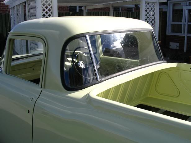

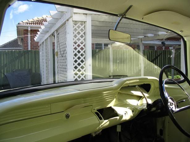

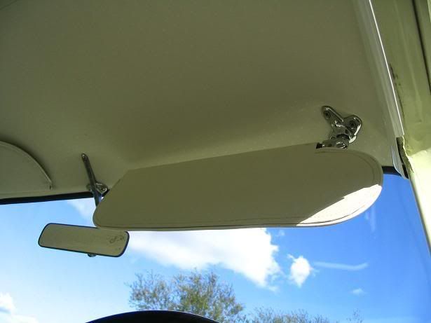

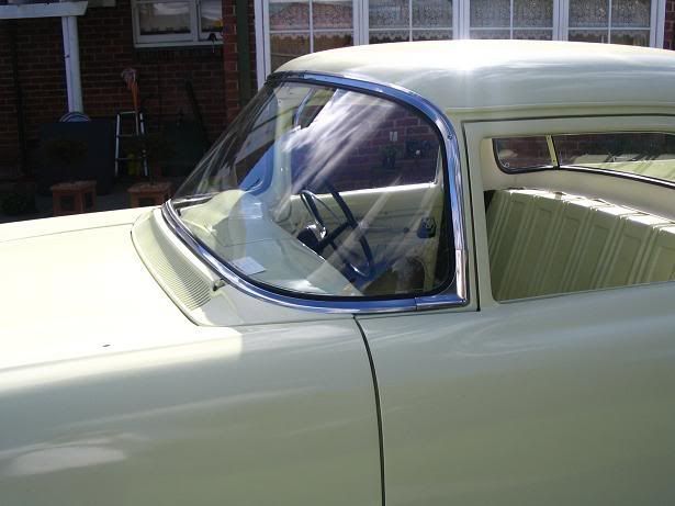

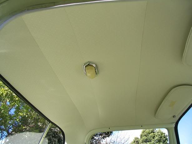

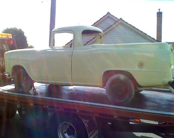

The Ute went off on wednesday returned home today with the head lining and sun visors replaced, plus front and rear windows looking more and more complete as each week goes
On the truck
Front and rear windows in
Interior shots.... just need to put the carpet in doors trims and seat

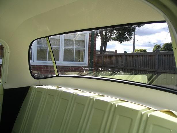

Putting the side and quarter windows back in tomorrow any tips on how to do this ive got the workers manual as a guide but is quite vague so any help or tips would be appreciated as i dont want to damage the doors or paint

Kingaz,
When fitting the quarters back in, I found that if you put some tape on the leading edges of the window slot you lessen the chance of chipping your paint. Also remember they are designed to fit and fit tight, So gentle as you go, the hardest part is to push the top rounded corner though the channel to mate with the front of the door frame. Remove the adjusting screw from the base of the seperating pillar so it dosen't catch the paint.
All in all a daunting job but pretty simple after the first one.
Cheers Theo Z...................

Thanks Theo for your guidance will try this next weekend when i get some energy.... Dont stress J i have all the intentions of a 3-4 inch drop after shes registered.
