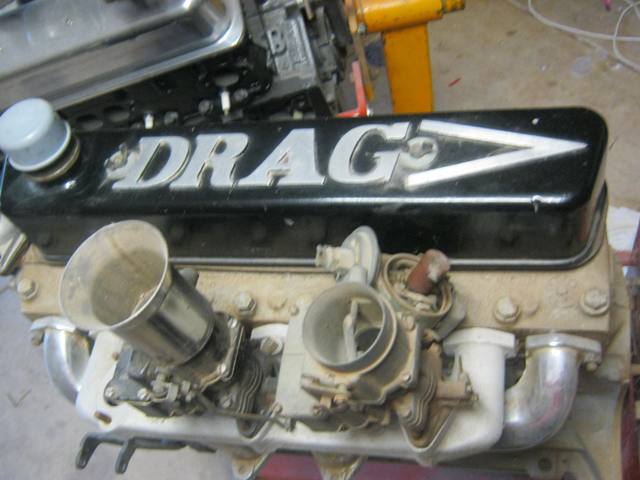

Hi guys heres my hot gray 138 +60 rm62 cam, triples, headers, 186 valves, steel custom made timing gears, speco rev master double valve springs, EJ bearing caps, custom rocker cover
hot gray.jpg (61.61 KiB) Viewed 2143 times

Wow where did you get that Drag Rocker cover mate :shock: :shock: :shock: they are older than most people think I've spent years, no DECADES looking for one.
So if anyone has one of these Drag covers to suit a grey that no one really likes or wants let me know and I'll take the piece of junk of your hands (just name a price) :lol: :lol: :lol: :lol: :lol: :lol:
Lucky bugger :thumbsup:
Mick 8)

I had to buy 2 trailer loads of grey motors and parts to get it and had to deal with a not happy wife who was not impressed with my drag rocker cover! somtimes they just don't get it!

My rocker cover came from an fj custom that won the 1965 Adelaide rod show and was featured in hot holdens mag way back i also had the engine but it was stuffed i've never seen another! neither has anybody i know so anybody who know something about it would be cool Cheers Mark

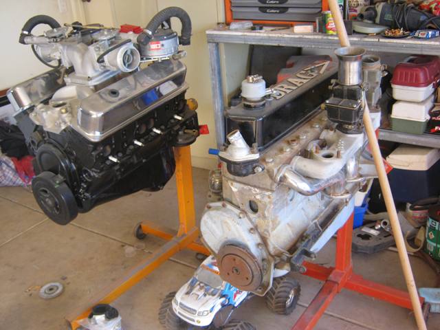

Here's a better pic!

lostmav wrote:Here's a better pic!
NOW YOUR JUST TEASING THEM :)
