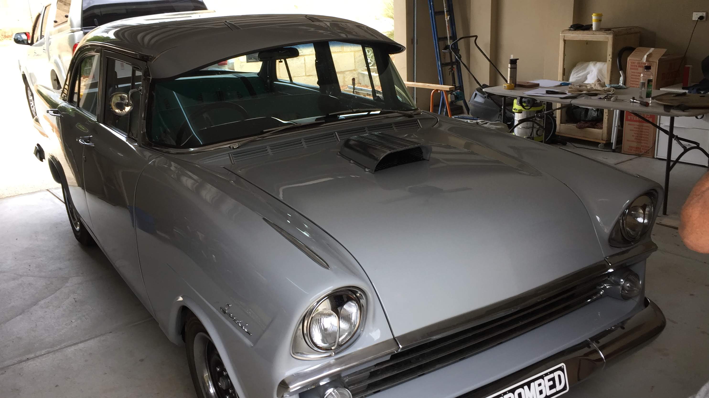

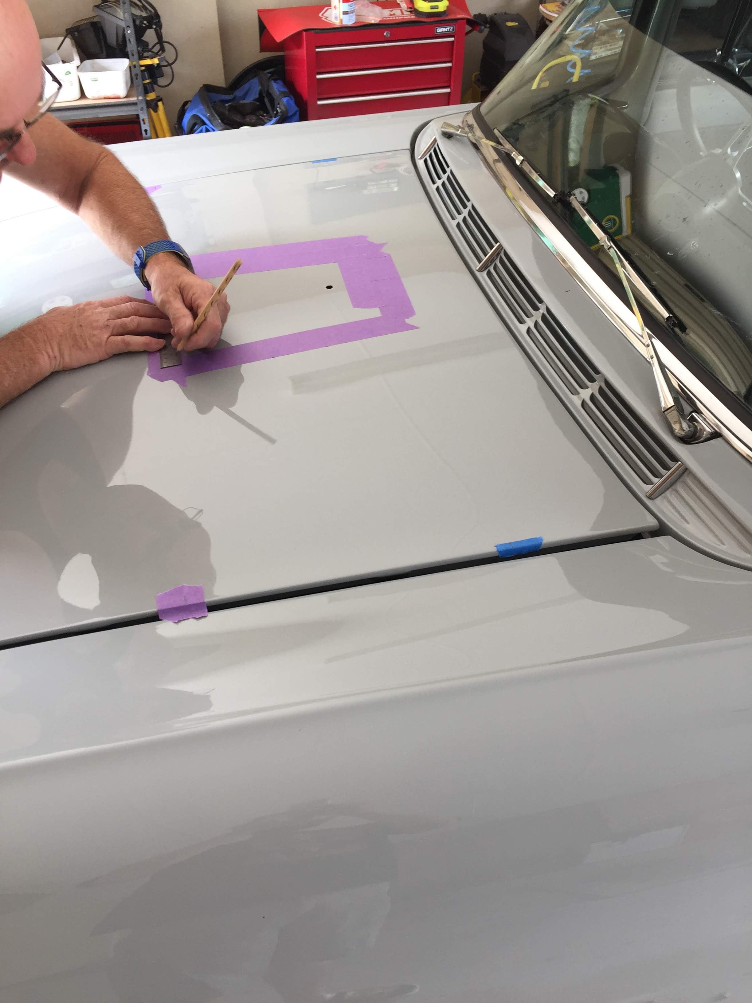

i was starting to have some grinder withdrawals so i decided the bonnet needed a hole on the weekend... i wanted a little bit more air flow towards the filter... going to replace that next with a top flow filter to get the real benefits.

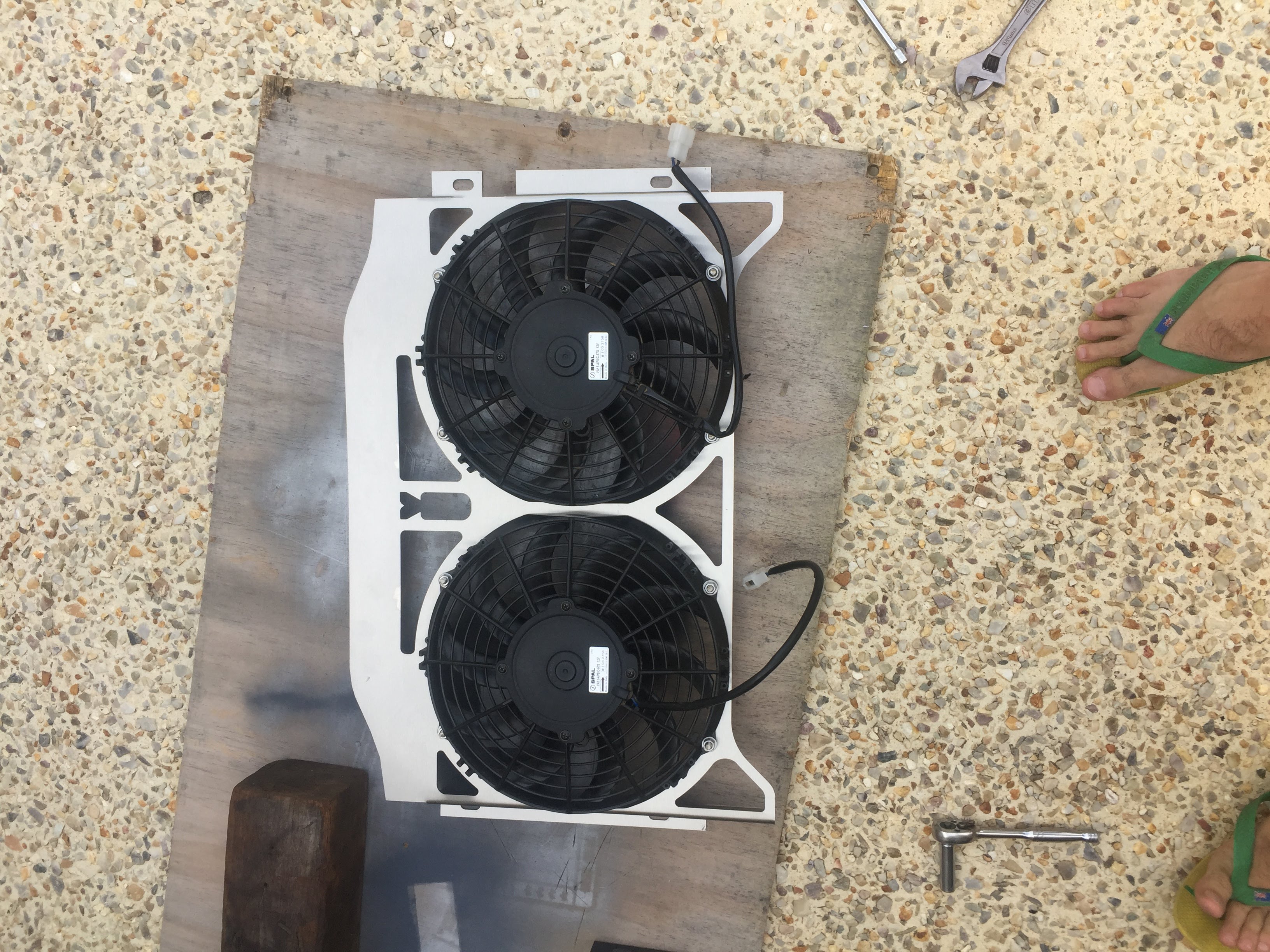

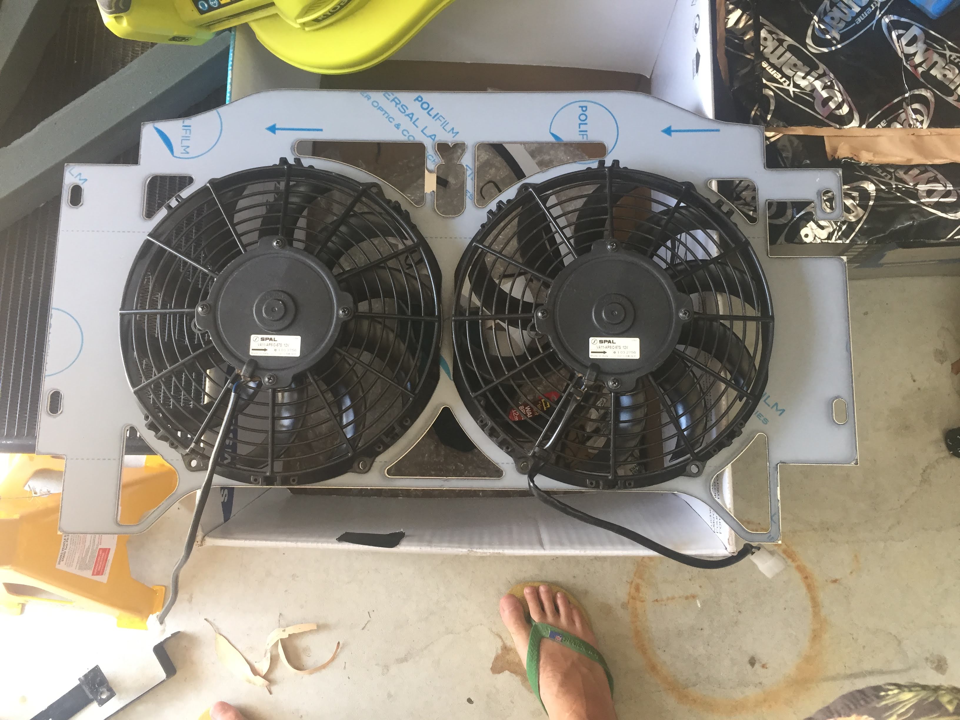

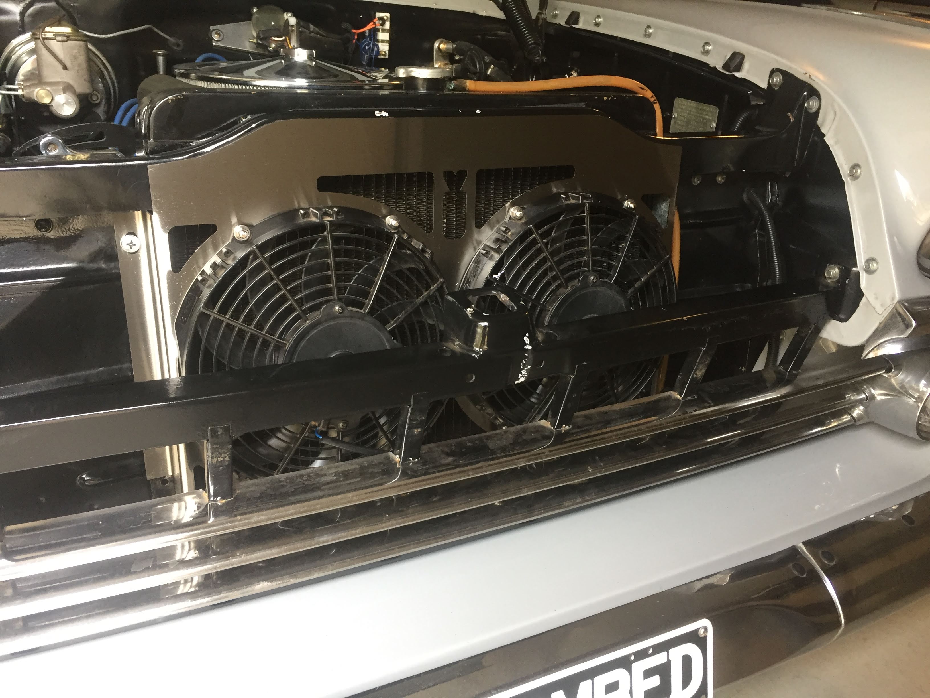

Well the work continues, slowly slowly upgrading and changing things as i want...
Wanted to redesign the fan mounts and just start cleaning things up and making things neater, horn got relocated under the guard while i was at it.
a little CAD work here, and next minute a 1.2mm brushed stainless fan mounts, got to say i really enjoy making pieces like this... everything got a good clean since it was a little dusty from a good paddock run :wink: :lol:
Being pusher fans i wanted to test leaving some open space for air flow while the car is in motion, and for when the AC condenser goes back on
