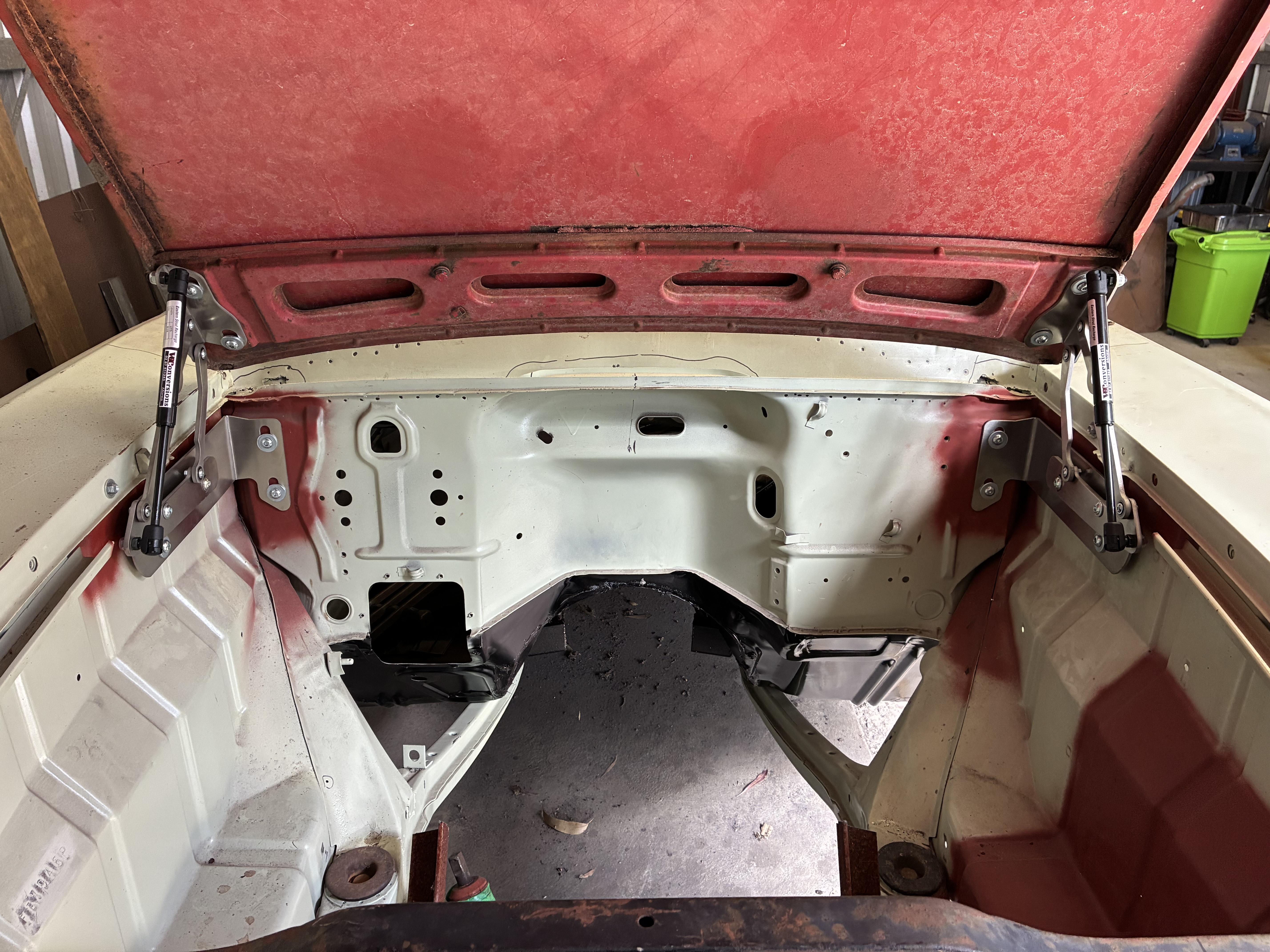

Fitted up the bonnet hinges while I was getting the workshop ready to move, two reasons, 1 hold the bonnet on, 2 I wouldn’t lose the bloody bolts and fittings :lol: :lol:
I tell you, you wouldn’t want your bonnet catch to let go the gas struts are fairly strong

They look neat and you won’t have any trouble running a bonnet budgie. Weight saving as well no doubt, both car and wallet.

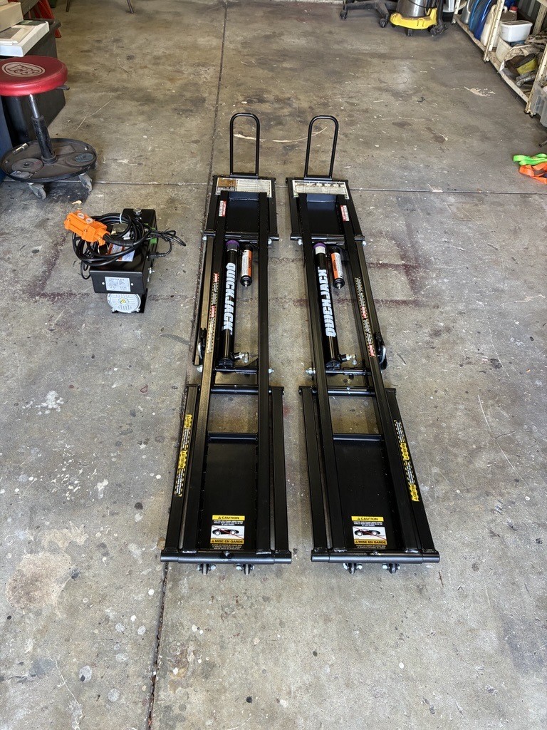

I don't have a hoist or anywhere to put on know so decided to buy a Quickjack hydraulic stands.
Gets really good height and much more clear when sliding underneath than being on car stands.
After I filled them with oil and bled them they worked really well.
