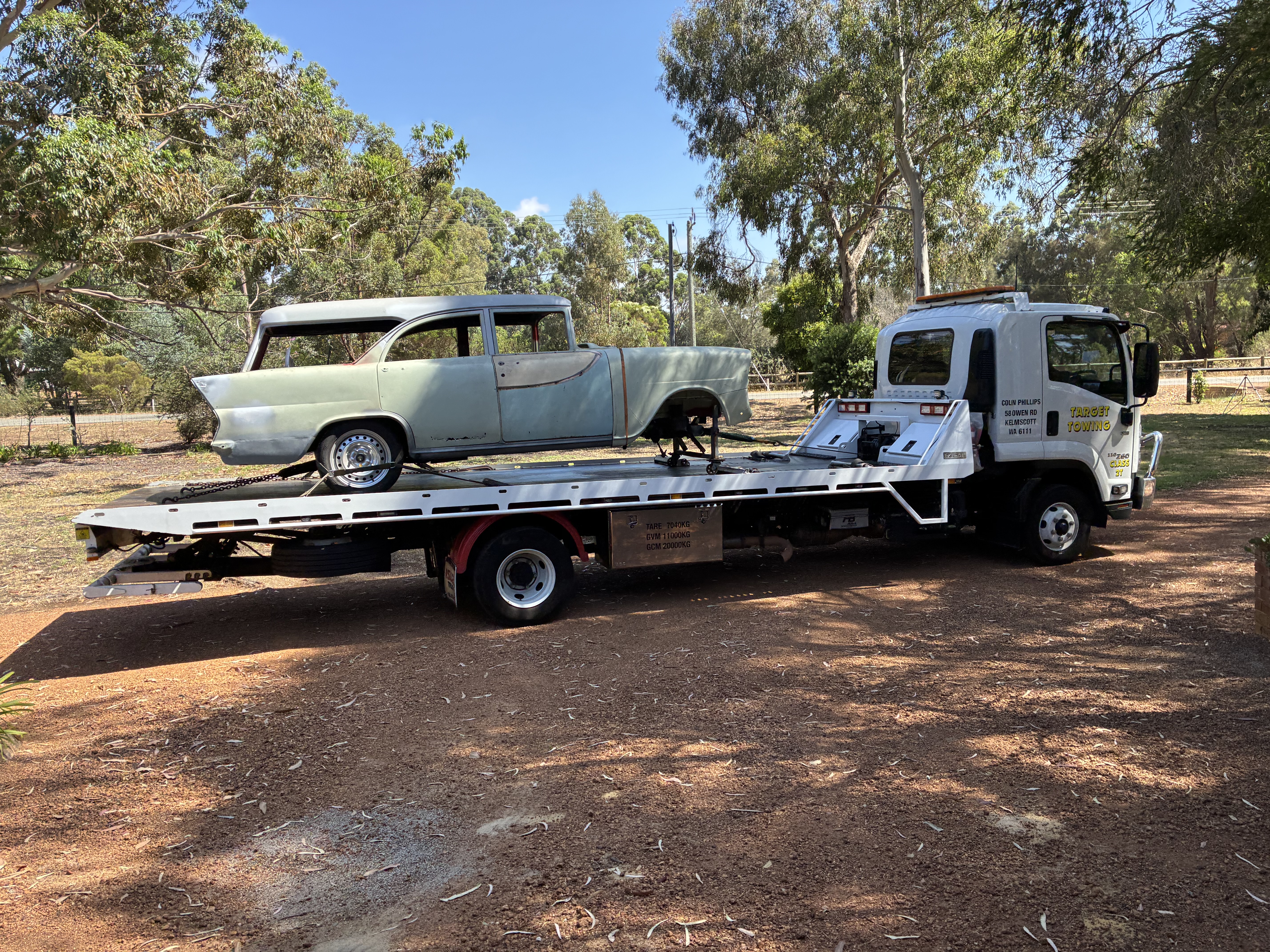

Work on the Reverend has had to go on hold for the moment :roll: we have sold our property and bought a place back in suburbia
:cryingg: have a friend with a factory unit so I’m going to share with him until I finish the wagon.
Have been moving for the last 5 days and the worse part is trying to move my workshop :lol: :lol:
The Reverend on the tilt tray heading to new workshop.
Want to wish everyone a safe and Merry Xmas and Happy New Year
Posts: 11643
Re: Neil's FB Station Wagon
Love the bigs and littles gasser stance Neil.
Good luck with the move and Merry Christmas to Robyn and you.

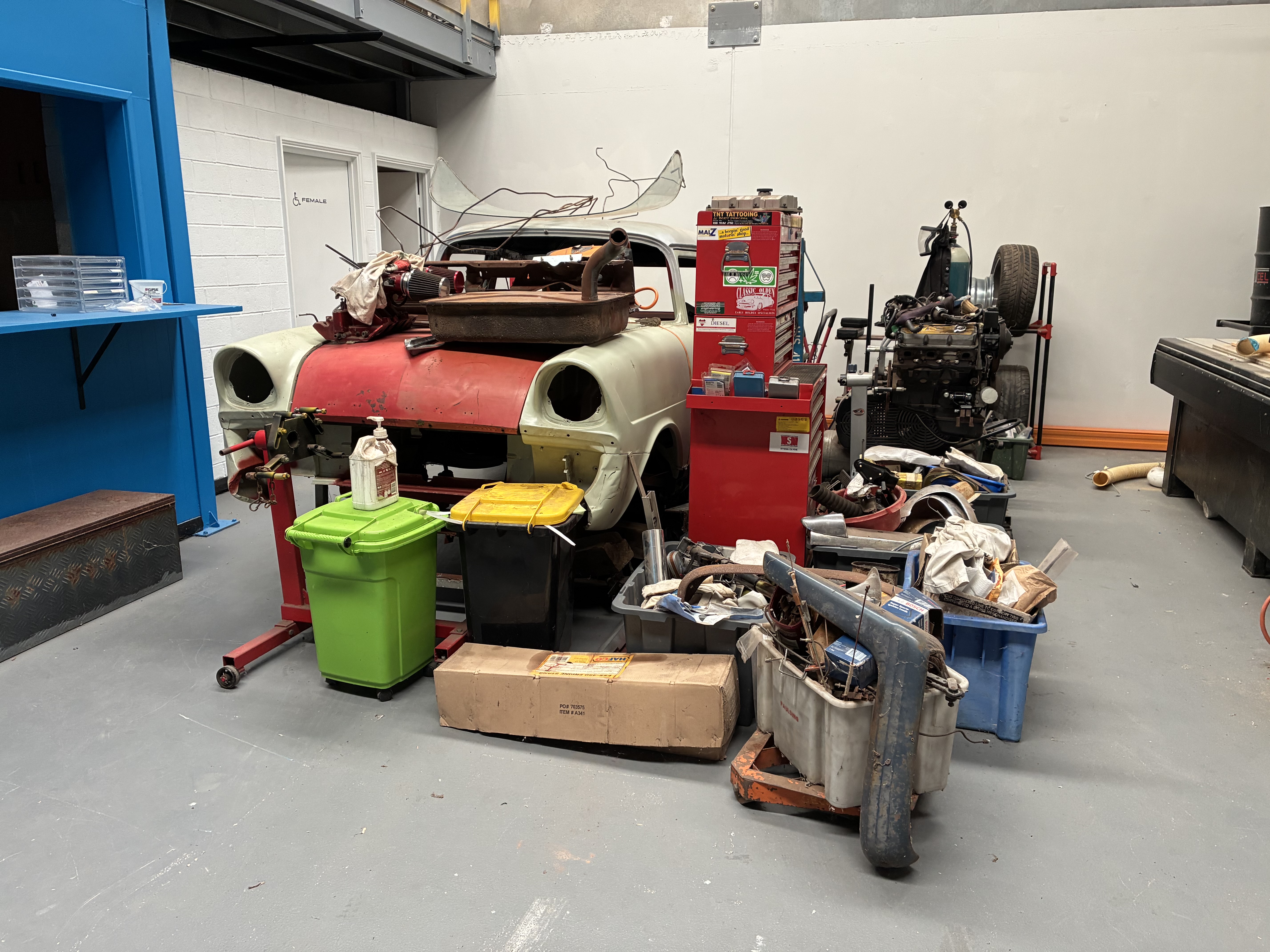

Well the Reverend has been in his new home since just before Xmas, I went to visit yesterday to remember if I still had as much junk as I thought I did and yes the parts fairies didn't come and sort it out for me, this is what you get for 20 years of gathering bits I suppose and this is after I had made considerable donations to EK Mart :lol: :lol: :lol:
