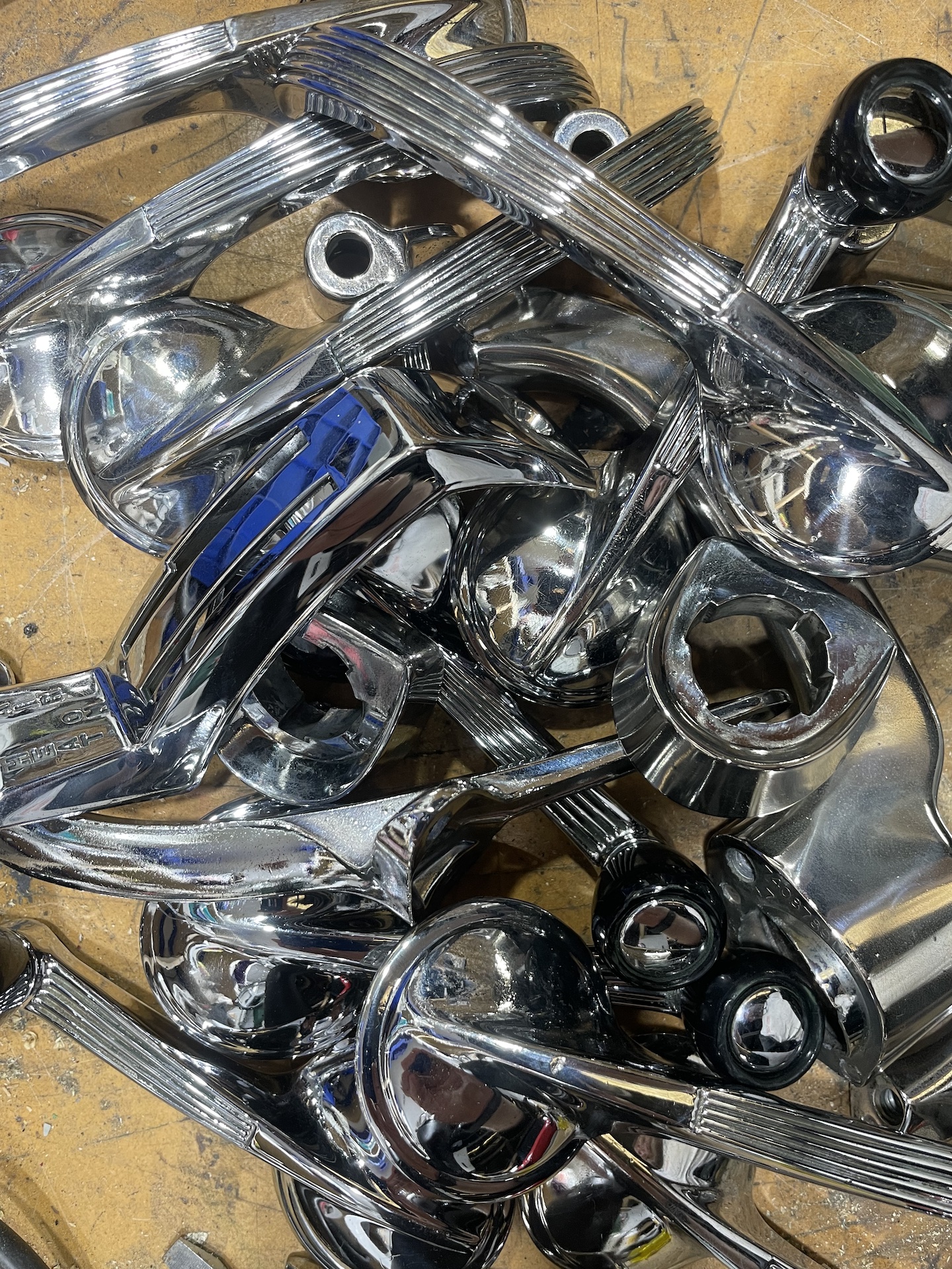

Still working on the boot lid fit - let's just say it's a work in progress. In the mean time been finding and polishing chrome bits off the car. Starting small, will work up to some of the bigger exterior pieces. My thinking is if they look okay then that will do. There are a few bits that will need rechroming like door handles which have worn most of the chrome off, but not going for mirror finish so happy with most of these.
There are a lot of scuff marks still on some of the handles. I have some extras so I might try cutting one a bit more aggressively to see what happens.

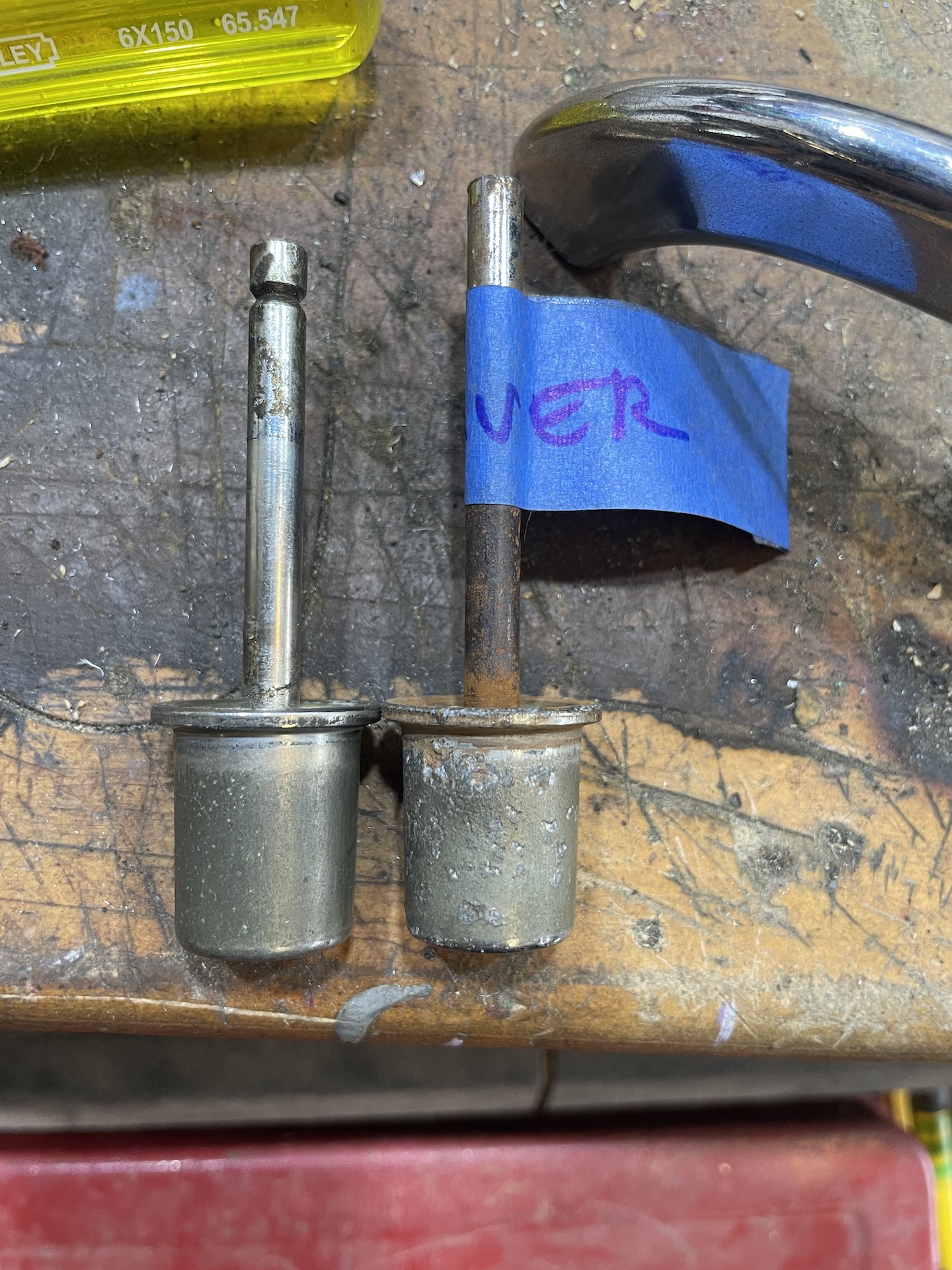

Grabbed the front and rear RH handles. Same part number.
Layed out the 2 different length buttons from the front and rear. One is 6.25mm shorter than the other. Had all 4 in the same container, and labeled one passenger, not front/back so not 100% sure which is front or back.

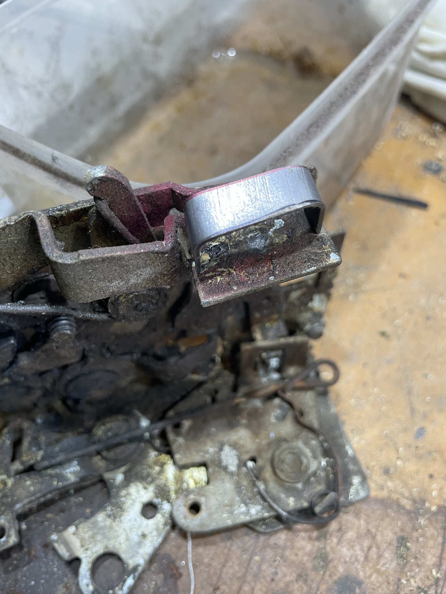

Got the rear door out of storage and grabbed a lock, confirming that front and rear locks are the same part numbers. Attached the lock and measured the depth from the exterior to where the shaft presses against the lock 'paddle'. Was about to grab a front door down and measure it when I had the craziest of ideas.

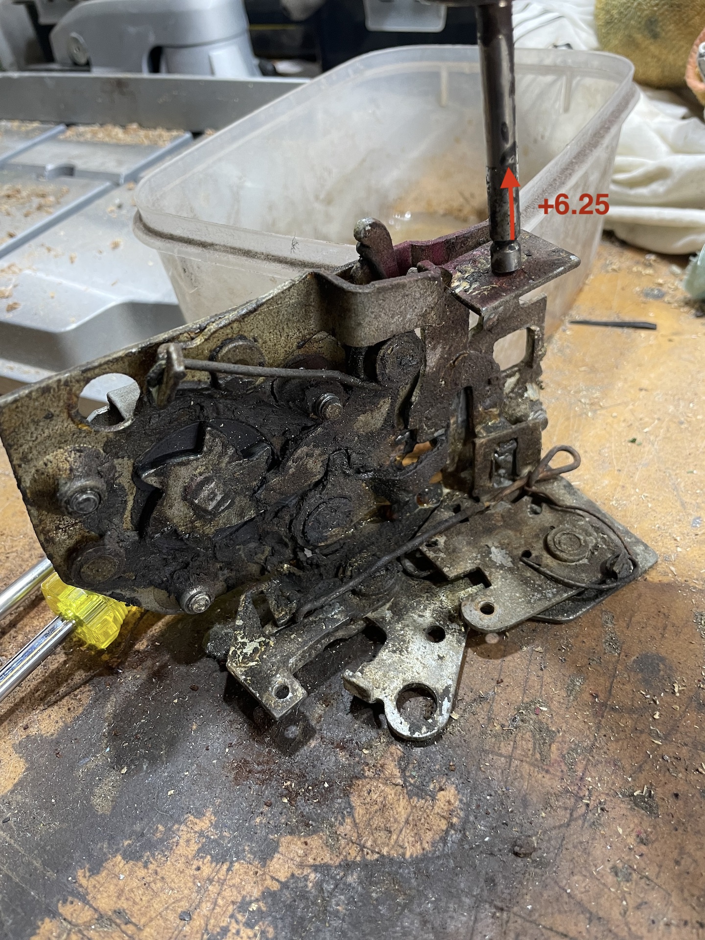

Anyways this has confirmed that to mod a rear exterior handle to a front handle, I could either....
A: extend the shaft by 6.25mm
or B: add 6.25mm to the 'paddle' as roughly mocked up here.
With my limited tools I will most likely go with B. Unless someone has an option C that is not "stop being a tight arse and pay the extra $80 for a combined 1/2in of steel rod"

Love your lateral thinking Scotty. Yes, the pin length is the only difference. Maybe a front knob could be used from a manky front handle, in a good rear handle?
