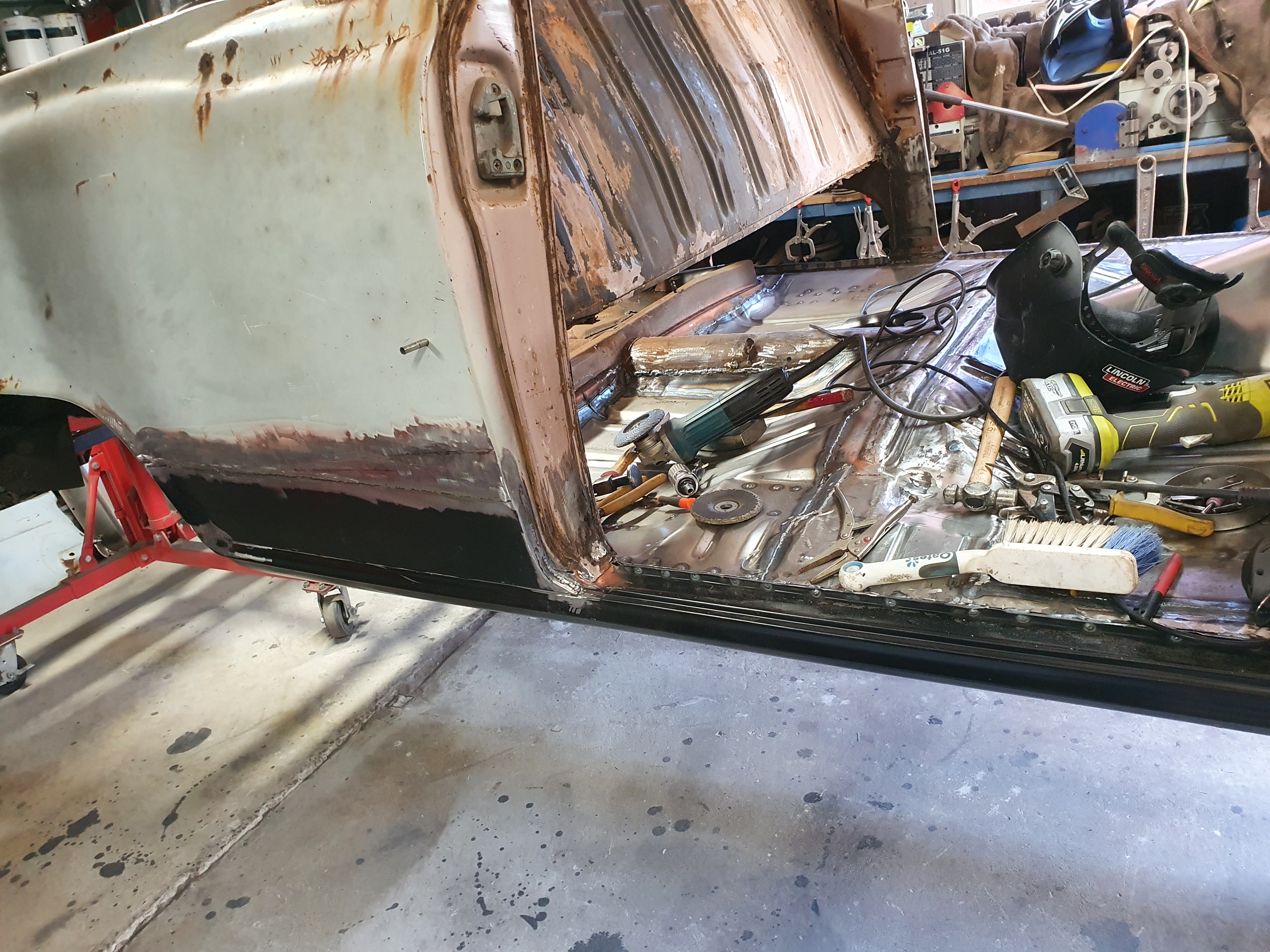

Tidied up a few loose ends today in preparation for rear quarter work. A little behind schedule but doing OK. ImageImage

Thanks Clay. Did 7 plug welds in behind. Can just reach it without the back cabin bottom panel sections, but I think I would be glueing it otherwise. I will POR15 all the lower 1/3 in that cavity, including the floor.

Reckon so. I thought you should be able to get in behind. It’s the top bit worries me re warpage.

All tacks, no beads and a wet cloth. No worries😄.
