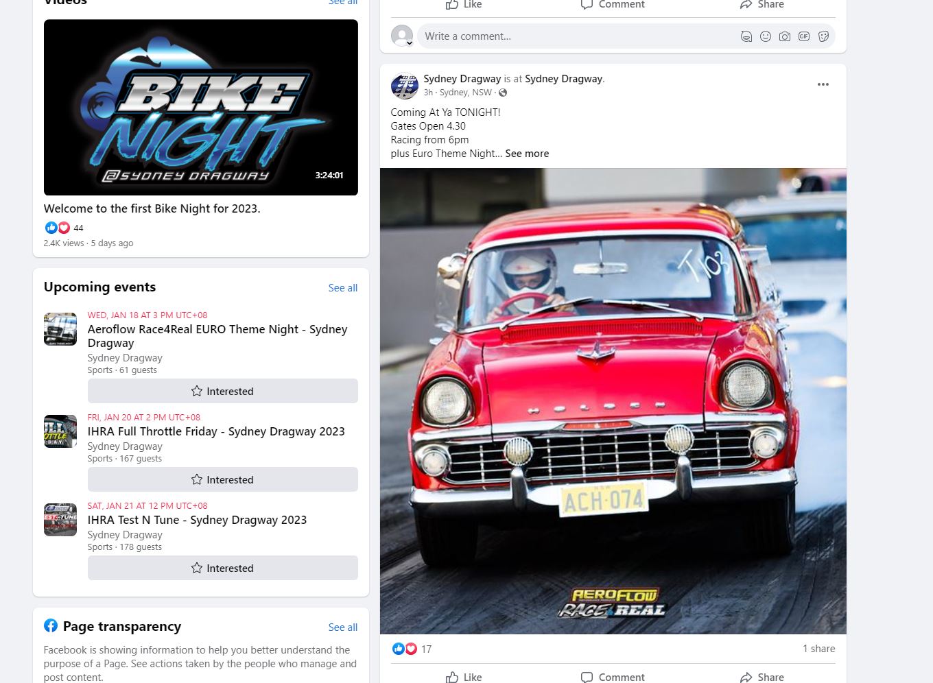

Number 1 Son leaning on the wagon last week. Posted on Facebook by WSID for tonight's drags.
WSID Facebook post.JPG (184.59 KiB) Viewed 4013 times
Re: harvs ek 327 wagon
Posted: Wed Jan 18, 2023 8:08 pm
What a ripper! 13s with driver and passenger windshields and period fog lights! Car looks fantastic.

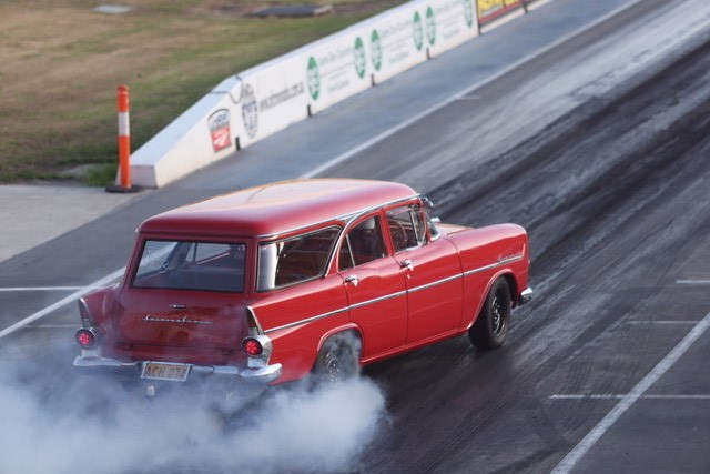

Another photo from the creek showing the illegal rear number plate and towbar.
WSID January 2023.jpg (60.76 KiB) Viewed 3824 times
Posted: Sun Jan 29, 2023 3:37 pm
Love it Harv
Posted: Sun Jan 29, 2023 5:24 pm
by BS
Great shot!
