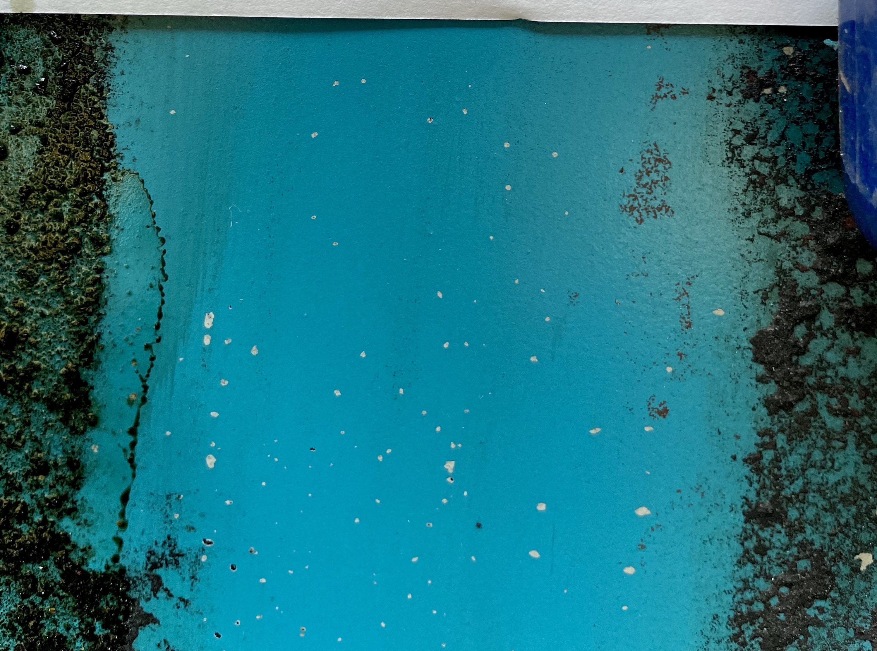

Been removing body deadener from inside the front guards and revealed this colour. Any guesses? I took the photo with a big piece of white paper so it should be correctly colour balanced.
Tartan Turquoise? Twilight Turquoise? Reef Green? Probably more blue than green
It's a FB panel (I can see where the stars and special badge holes have been filled in). Who knows - could also have been resprayed but looks original.

It’s yer basic shade of green… :mrgreen:
https://m.youtube.com/watch?time_contin ... e=emb_logo
Not reef green - it is more green than blue.
Re: Ol' Rusty - FB/EK Sedan
Posted: Fri Jan 05, 2024 7:12 am
by funkyscooter
Thanks Harv - at the end of the day the name is probably only useful as a historic reference anyway.
IF I like the colour, then its not too important what its called, but I was hoping to search for cars in this colour to see if I like it across a whole car, and not just the tiny patch I am looking at on the underside of the guard.
I have access to a colour scanner like the ones they scan samples in the paint dept at Bunnings, so I'll grab the values with that. Or maybe I should just take the whole guard in to Bunnings :lol:

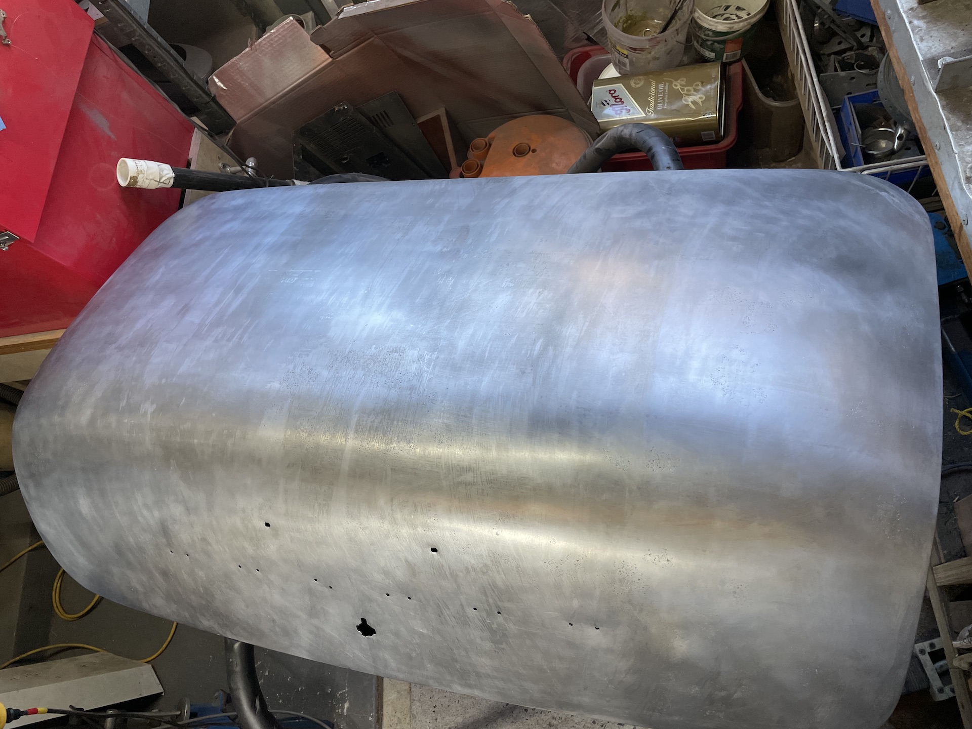

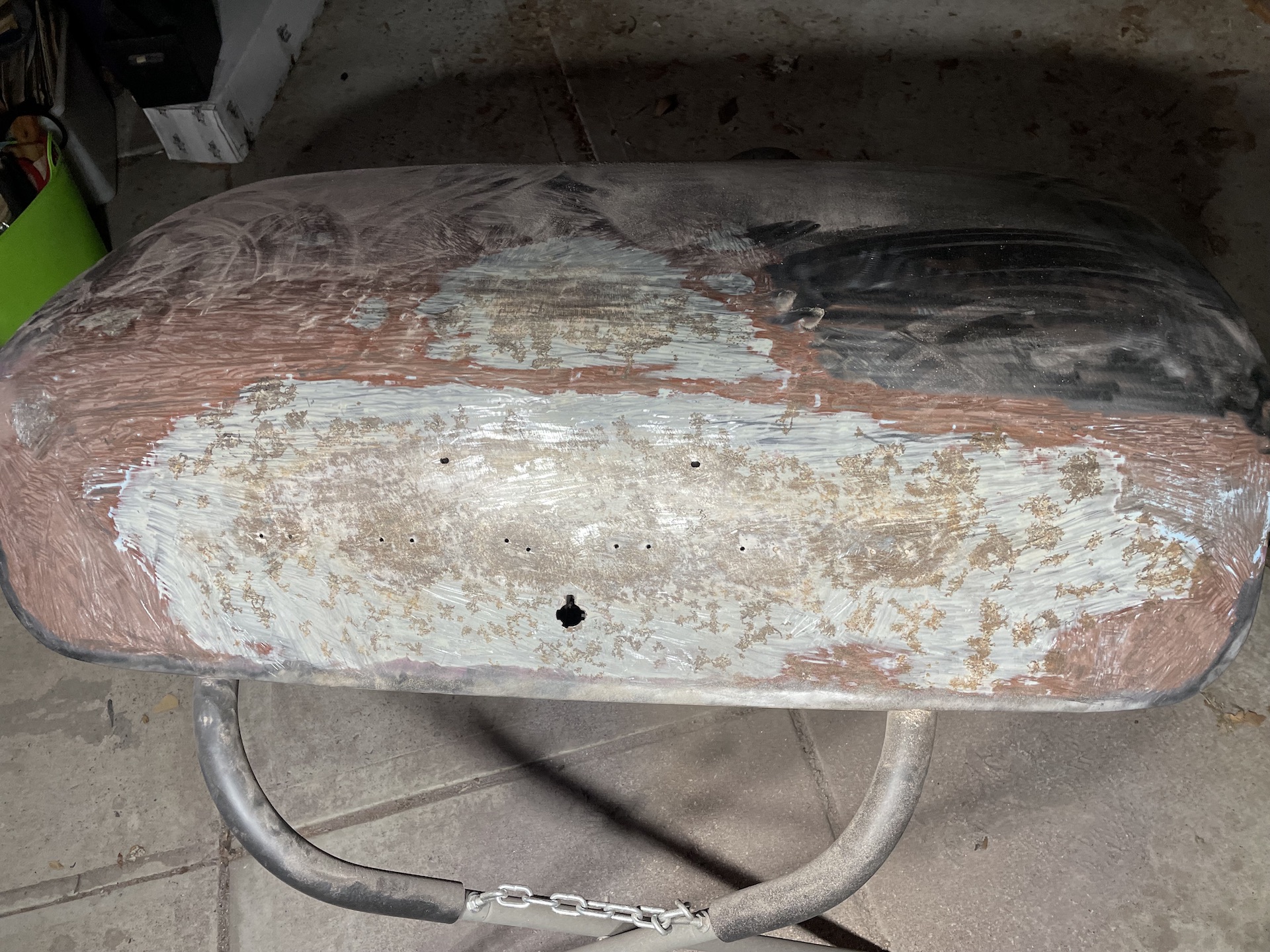

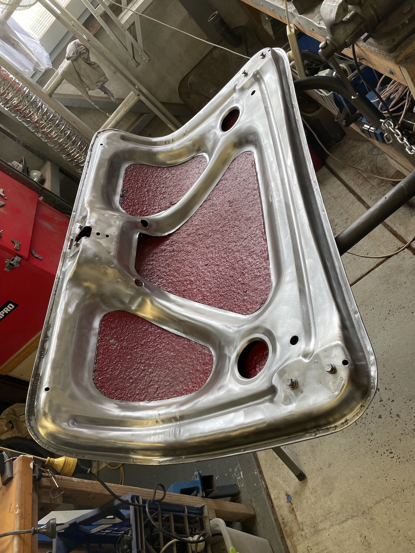

Finished treating the rust on the boot
viewtopic.php?p=267650#p267650
Before
After
Flipped it over and got distracted by the holes in the bracing.

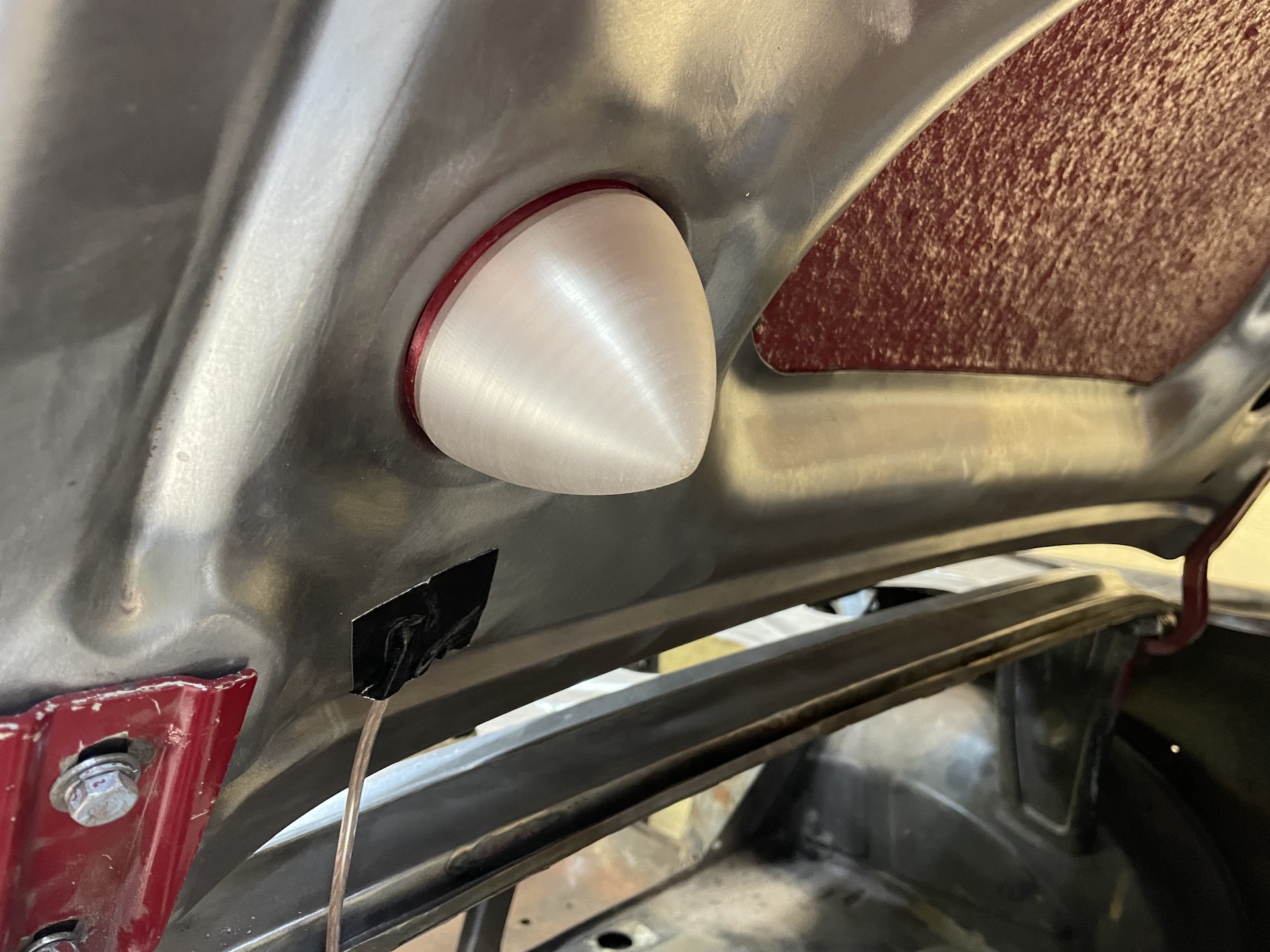

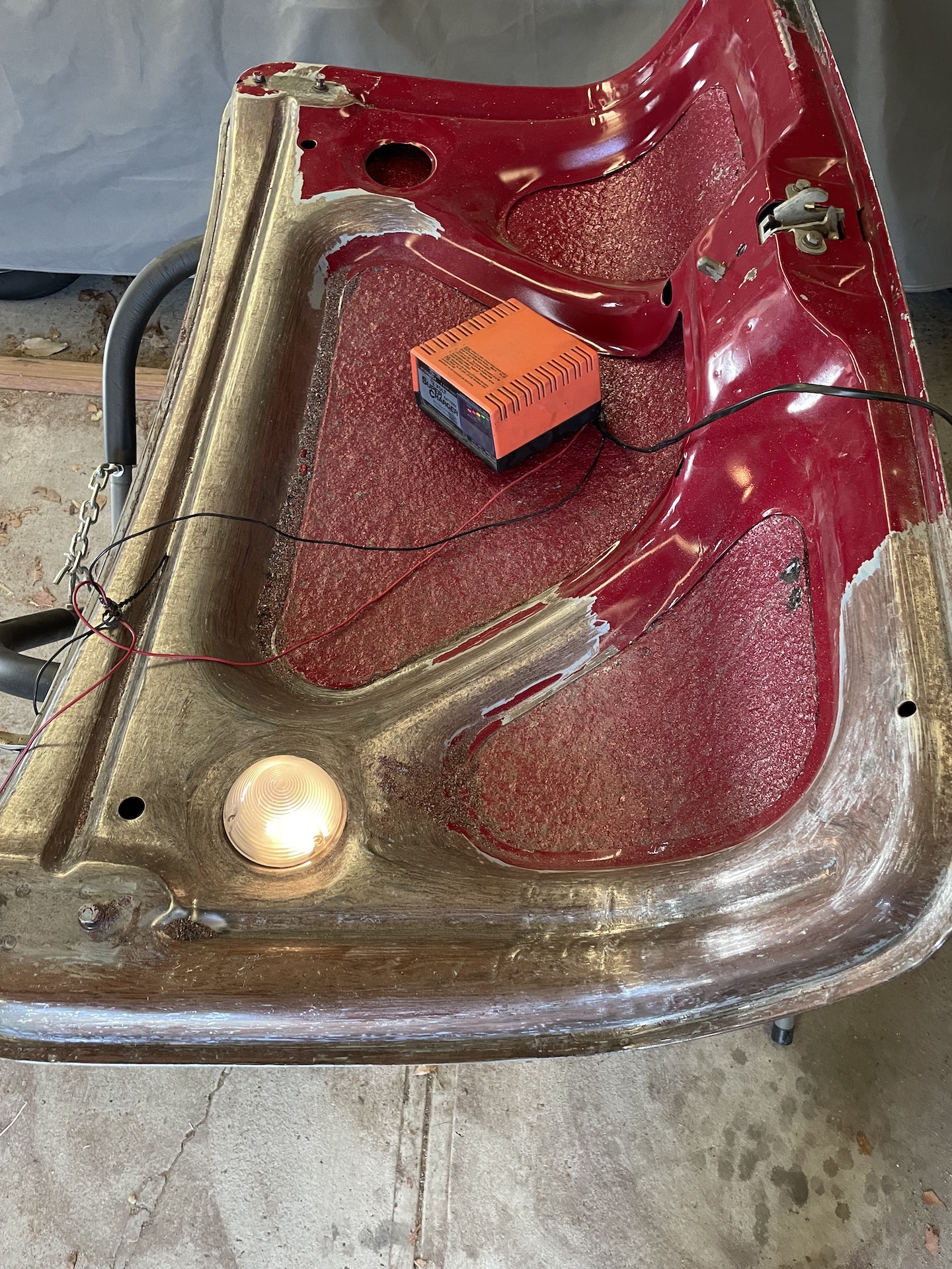

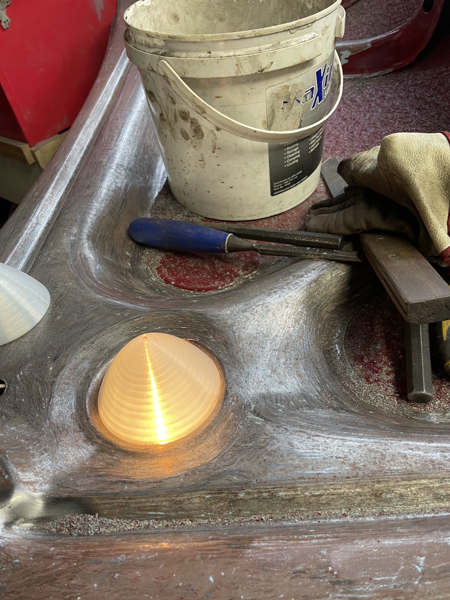

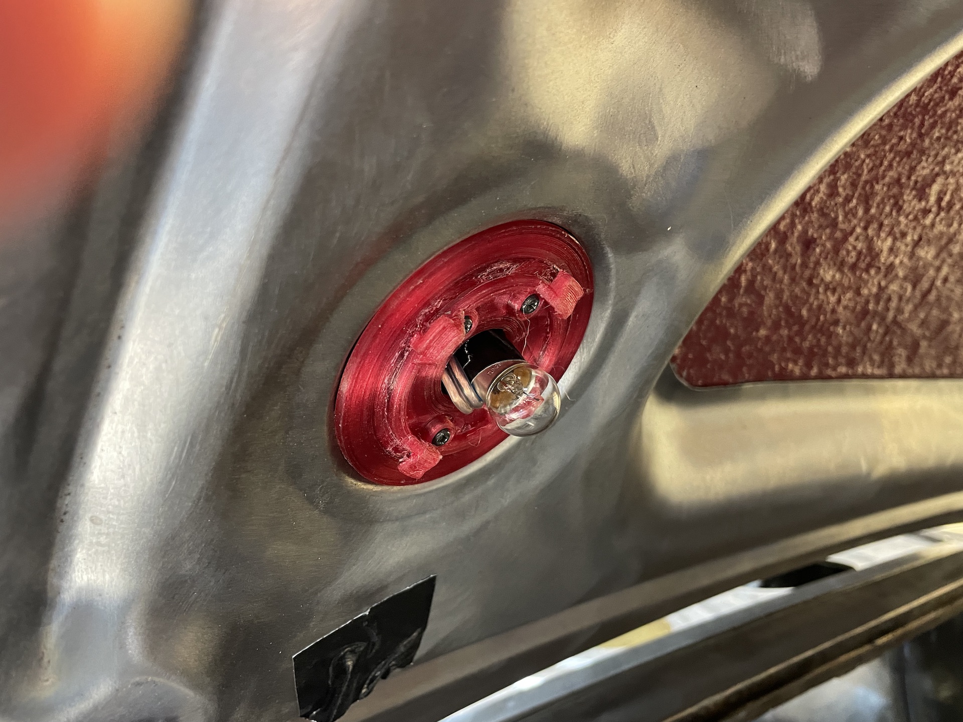

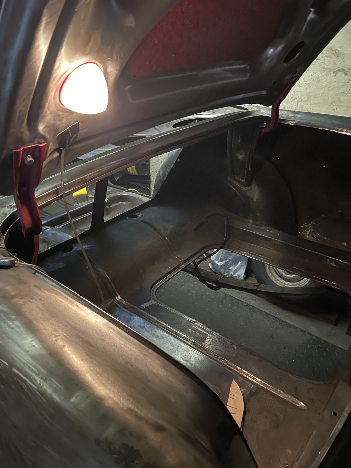

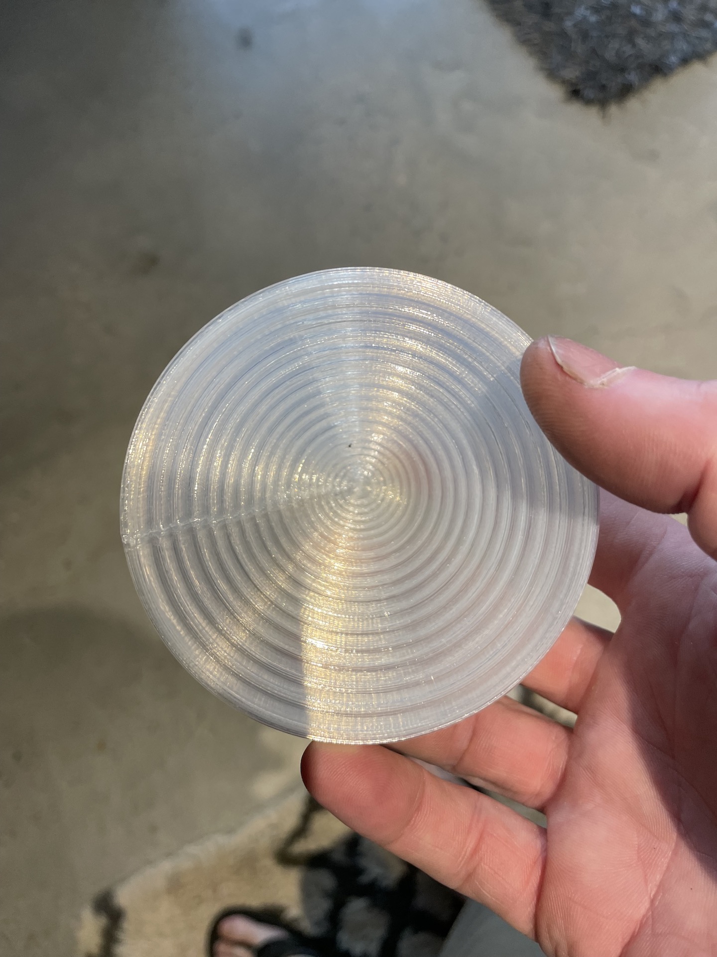

Boot lights! Well I am not someone who would waste a perfectly good $50 lens on a boot lid light, instead I think I have wasted a good few days modelling and 3D printing my own.
Version 1
It's a start, not sure if I like it, and while I mulled over it I stripped and cleaned up the inside of the boot. No big hidden rusty surprises here.

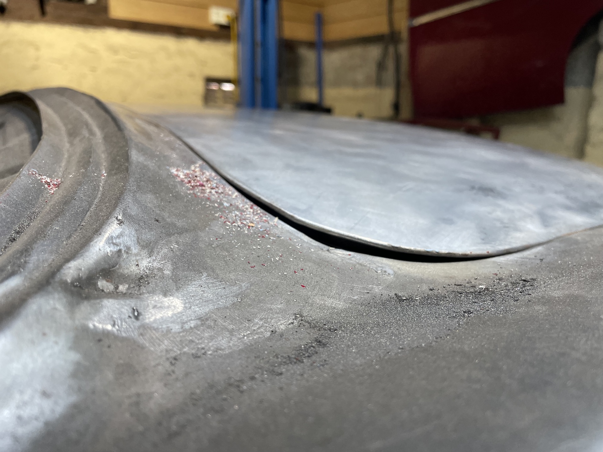

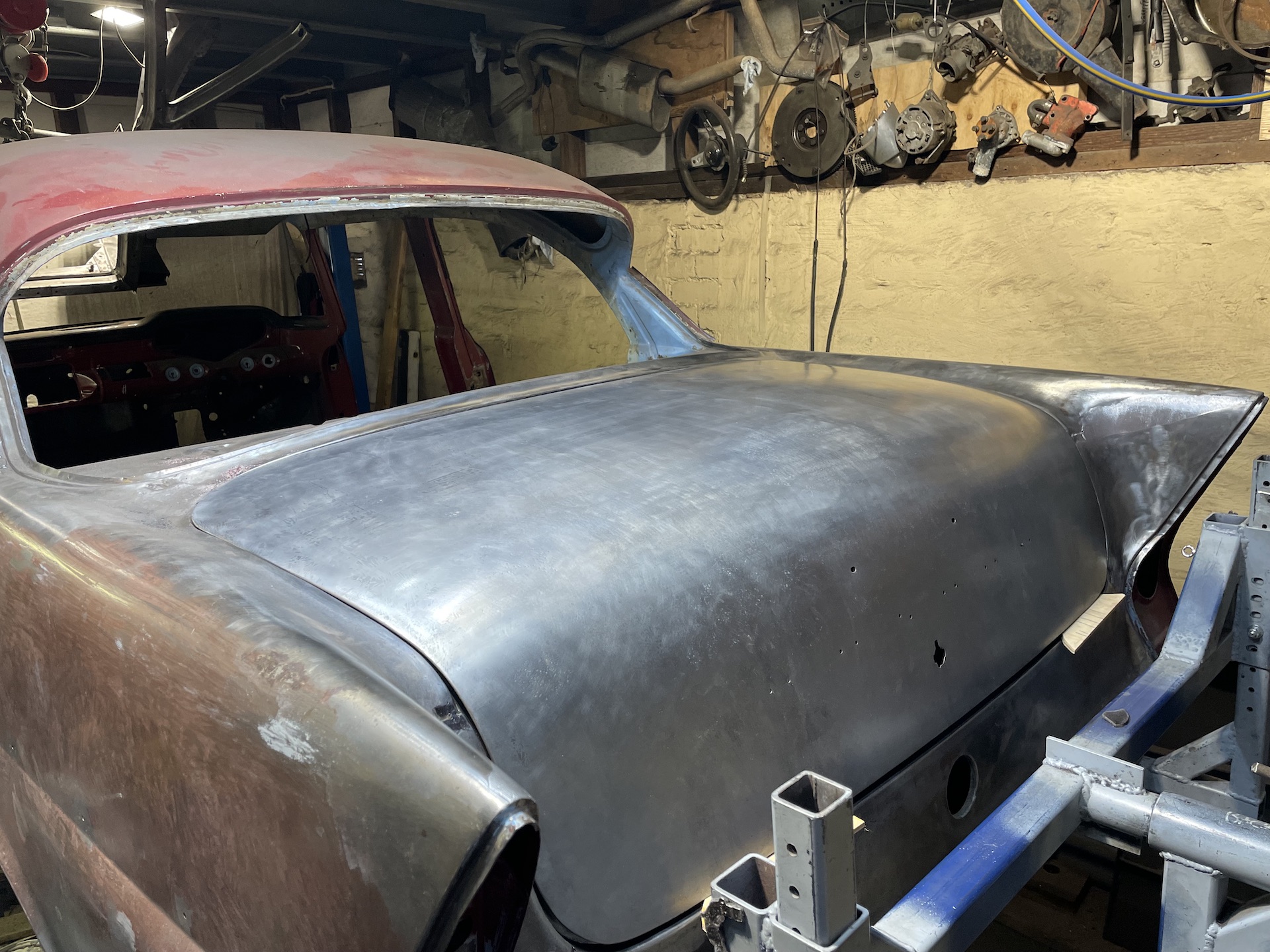

Fit the boot, recheck gaps etc.
Tried to get the best fit I can shimming as per the instructions in the shop manual. This is it!?
Really not happy with these. Seems like a lot of filler will be needed to get this to flow a little better.

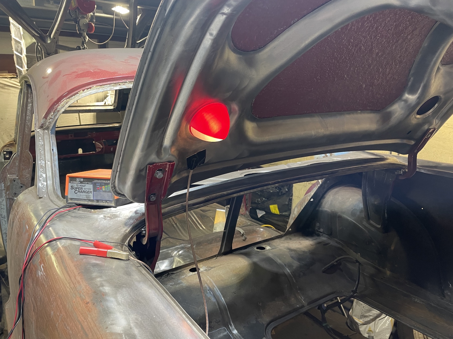

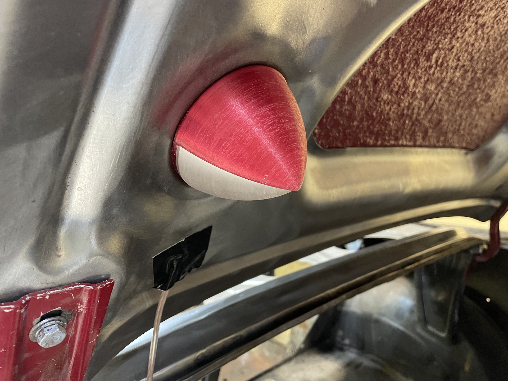

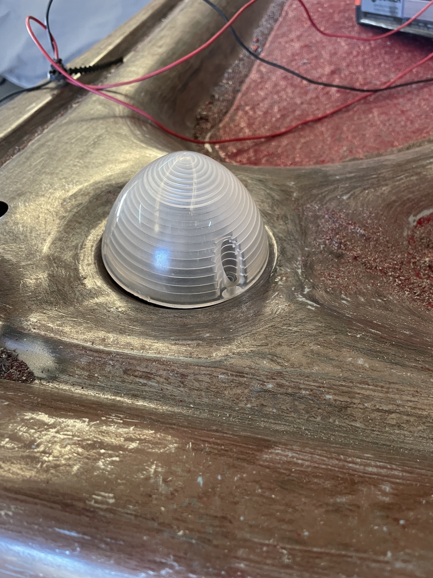

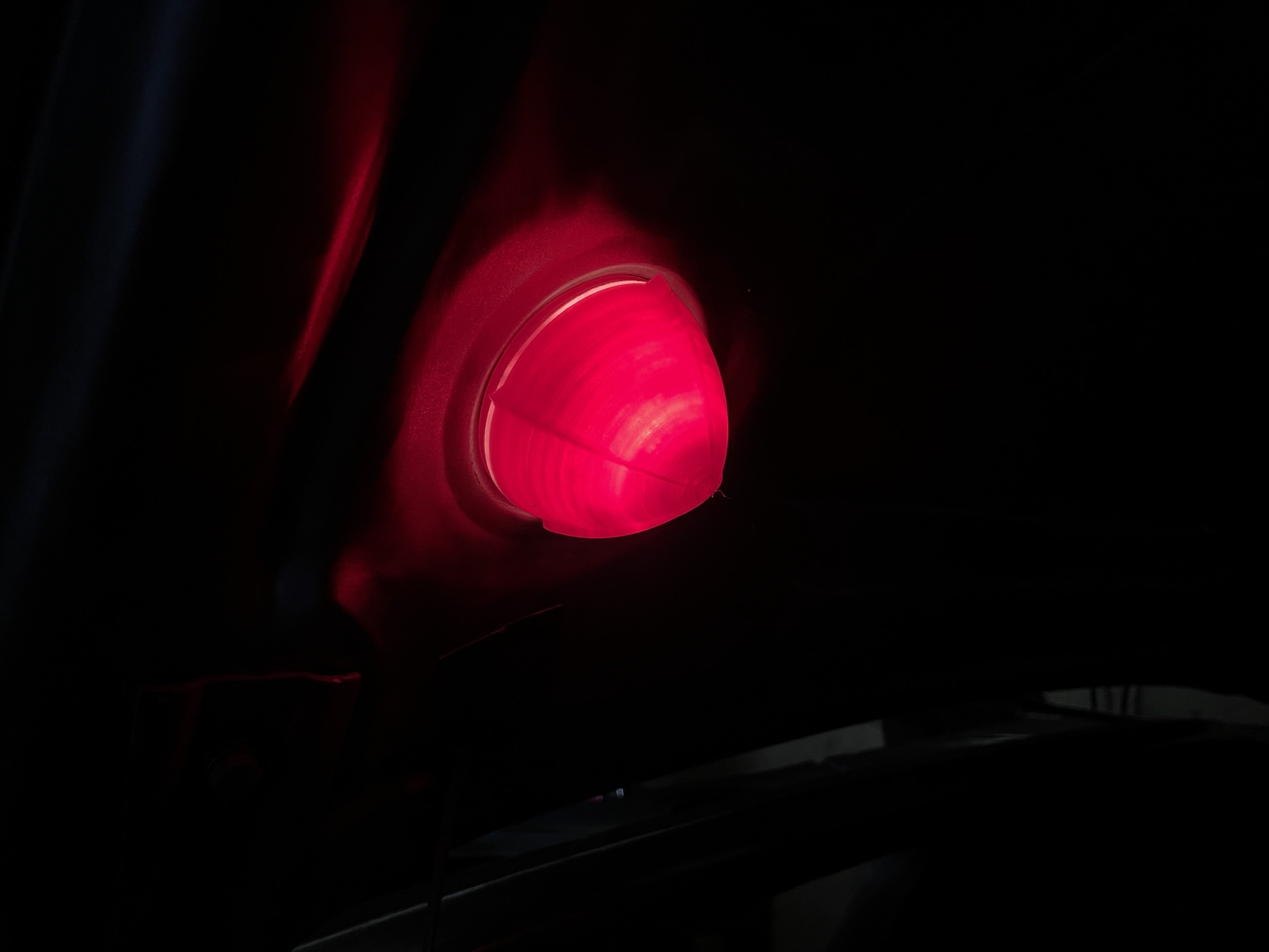

Then back from holidays, still no decision with the bad boot lid, so I distracted myself with version 2 of the boot lid lights.
This one has a better profile and I printed up a mounting plate. The lens twist on.
Then I added a clip on safety red warning cap thingy that stops you getting blinded by the light. Might try this colour coded to the car down the track.
Then a full red one with 4 ribs. Impossible to get a good finish with this due to the shape.
What was I doing again.......

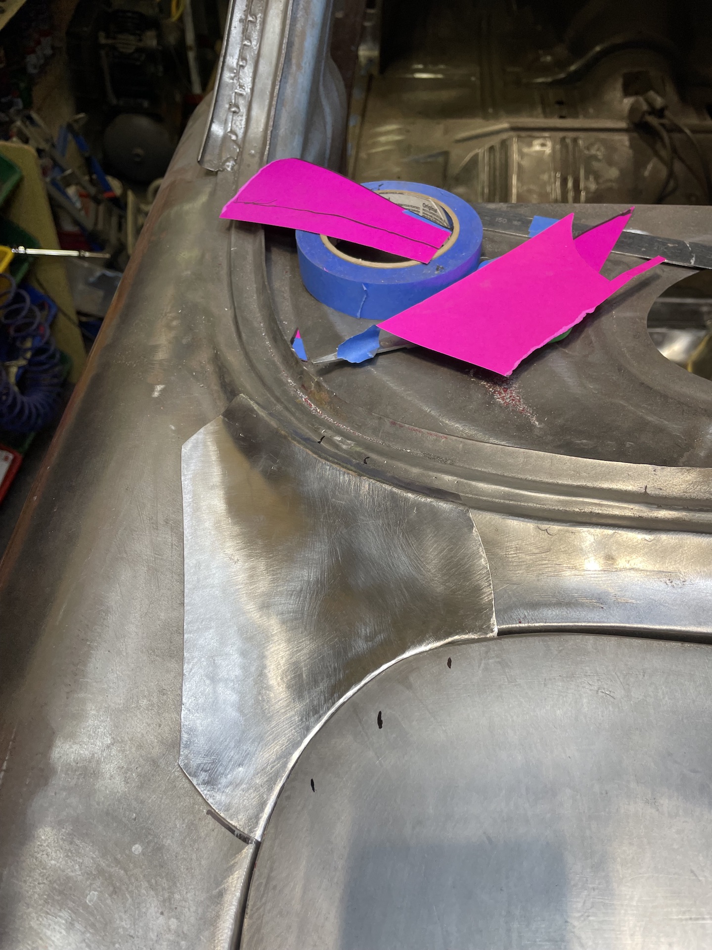

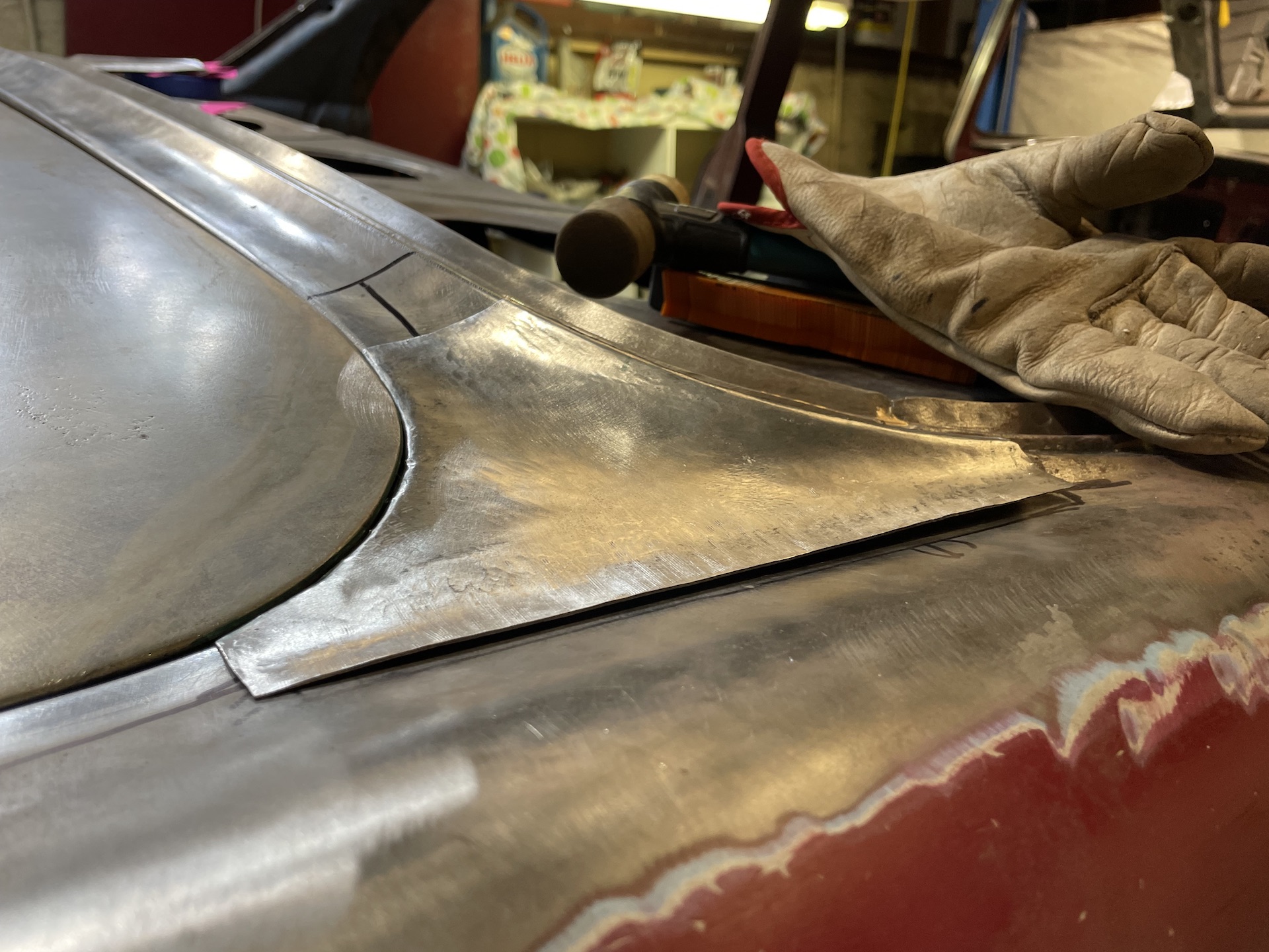

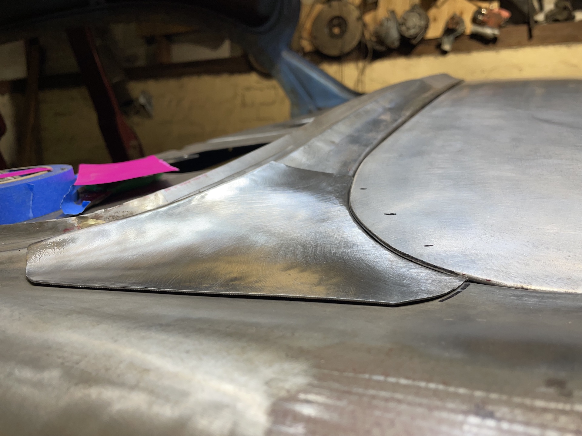

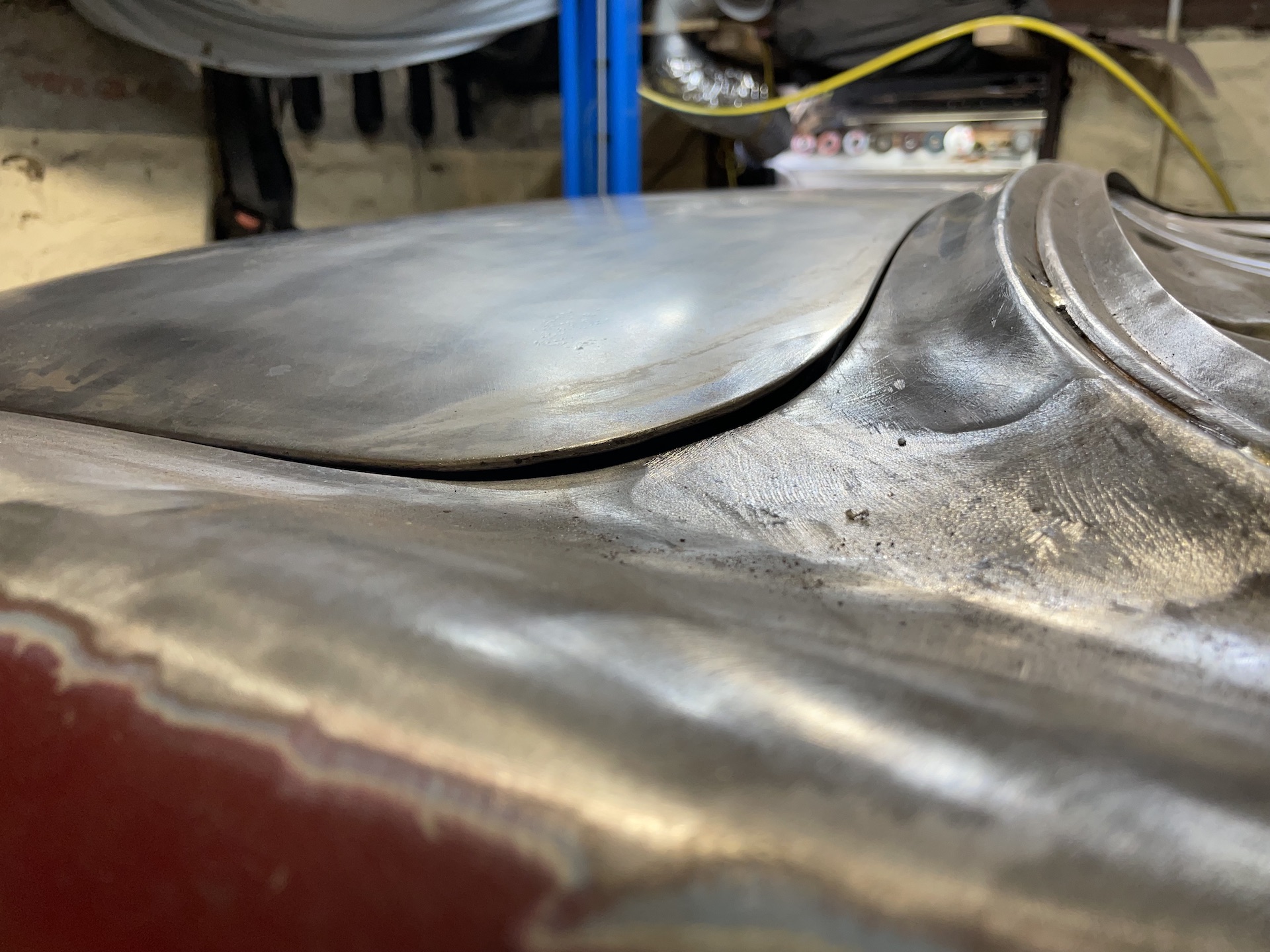

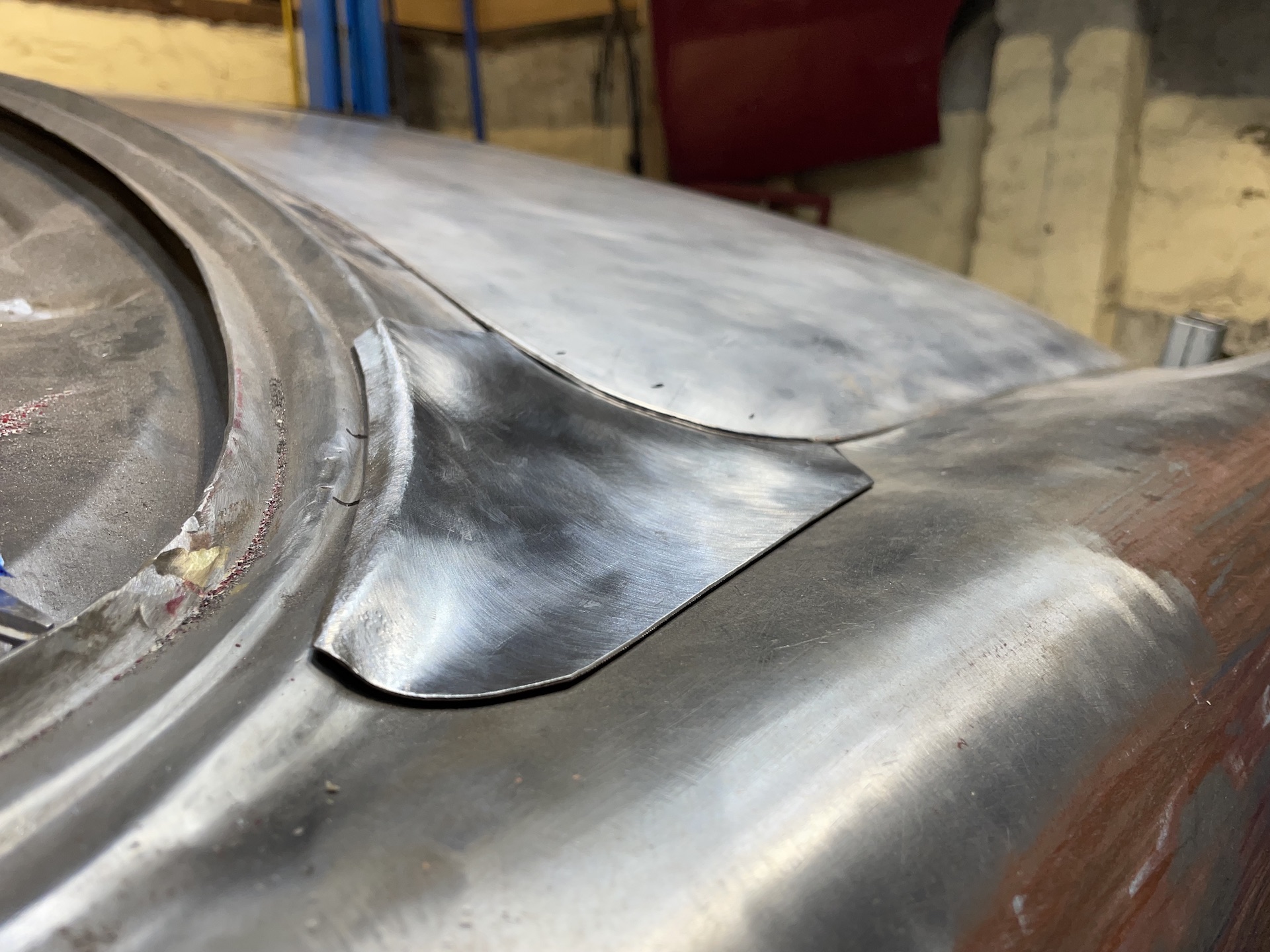

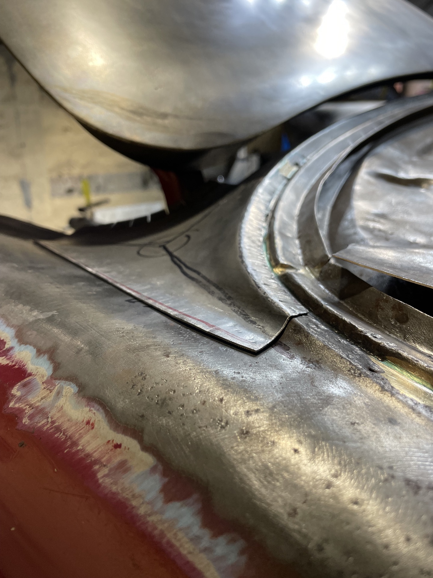

Oh yeah trying to decide if I really want to cut out and raise the body to match the boot.
So after much forming and shaping and general hitting and twisting later I managed to get these.
And on the drivers side..
They are ok. There is a lot of work that I need to do around the rear window on the drivers side rust wise, so I might tackle that first.
I have also thought about taking a BFH to the lip of the boot but it looks correct as is. Or I could just fill it in with body filler.
What I need to do is make a decision. So I'll go and remove some body deadener off the front guards and think about it.
Or try to repaint cars with AI :roll:
Posted: Mon Jan 08, 2024 6:05 pm
by ardiesse
Scott,
Take to the lip of the boot with Mister Hit. It shouldn't (famous last words) take too much effort.
Posted: Mon Jan 08, 2024 6:29 pm
If it were me I would have a go at bending or shimming the boot to hinge mounting surface so the hinge is swinging further in the shut direction, bringing the lip lower. Possibly you've considered this already.
