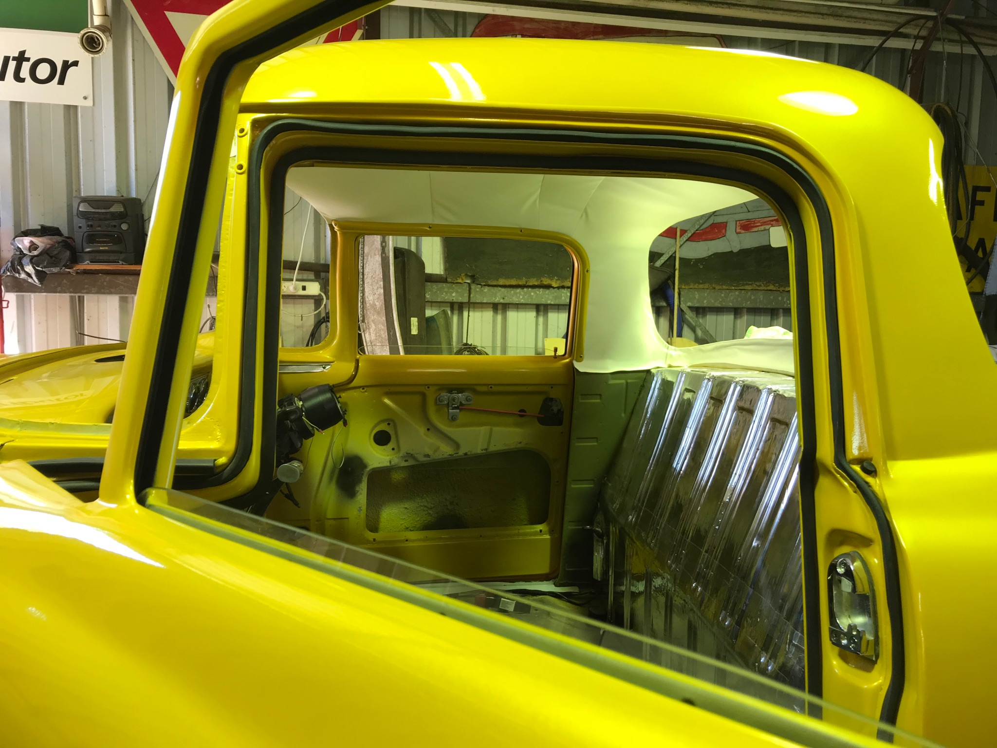

Well some major steps completed in the last two weekends with the help of two really good people.
Firstly John Campo from the WA club came and finished wiring up my headlights that I just couldn't get my head around, I just couldn't figure out how to get the VT headlight switch and the high beam/flasher lever on the steering column to work no matter how long I stared at the wiring diagram, took John a couple of hours and I had to buy new headlights :roll: but at the end of it all wiring is now completed :clap: thanks John.
Now to yesterday and to say I'm a happy man is an understatement :ewink: Keith (retired panel shop owner) who did the body work and painted Frank and has become a good friend came down and together we installed my ebay purchased headliner and then we pulled in the front and back windscreens.
So I still have wiring to tidy up, brakes to bleed, hand brake cable to finish and interior :crazy: and I should be finished :eh: maybe ๐Ÿ˜œ

Way to go Neil
Your cargo cabin wall has me puzzled. It looks like freshly dressed steel.
Re: Neils Frankenstein Ute
Posted: Sun Apr 07, 2019 9:19 am
by FireKraka
Thanks Mate, cabin wall is covered in poor mans Dyna-mat l still have to finish doing the firewall and floor after tidying up the wiring.

getting close now mate :thumbsup: :thumbsup:
Posted: Sun Apr 07, 2019 11:32 am
Ok I can see it now. Great job. Thatโ€™s not the underdog product? That is what I have.
