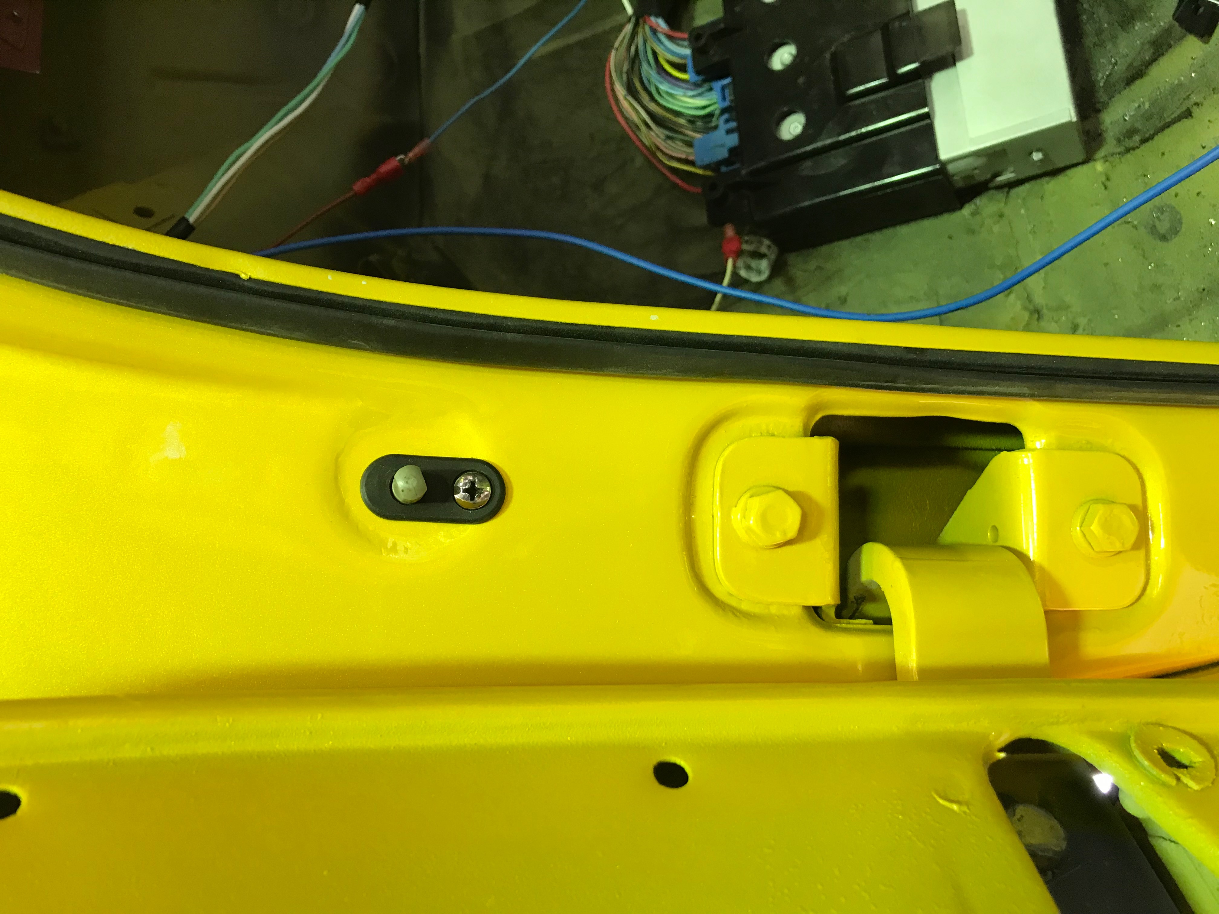

Hi Neil looking good, as to your question re wiring and door switches I suggest you use Commodore ones, the earth is via a self tapper that holds the switch in place and the wire attaches with a standard push on connector, a much more reliable arrangement than the ones pictured given they look badly corroded.

Keith great idea on the commodore interior light door switches mate, I raided the wiring harness I had and after having procrastinated for what seemed like months within 10 minutes all done and dusted.

Hi Neil,
Does the plastic deform around the press out in the body or do they fit ok ???
I will use them as well I think.
Posts: 2820
Re: Neils Frankenstein Ute
Hi Greg they seem to be fine but then again I didn't really look, I will have a look and let you know.

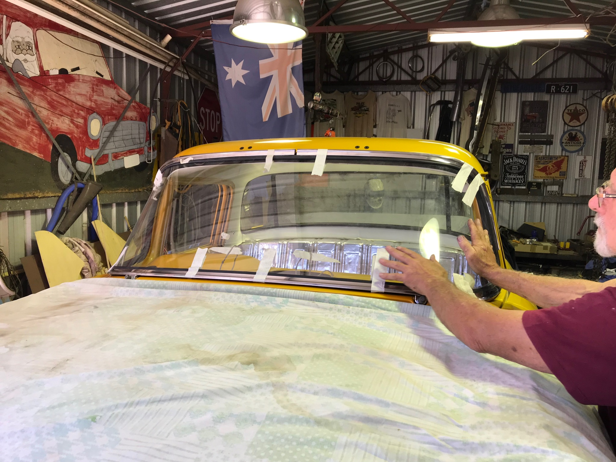

Well some major steps completed in the last two weekends with the help of two really good people.
Firstly John Campo from the WA club came and finished wiring up my headlights that I just couldn't get my head around, I just couldn't figure out how to get the VT headlight switch and the high beam/flasher lever on the steering column to work no matter how long I stared at the wiring diagram, took John a couple of hours and I had to buy new headlights :roll: but at the end of it all wiring is now completed :clap: thanks John.

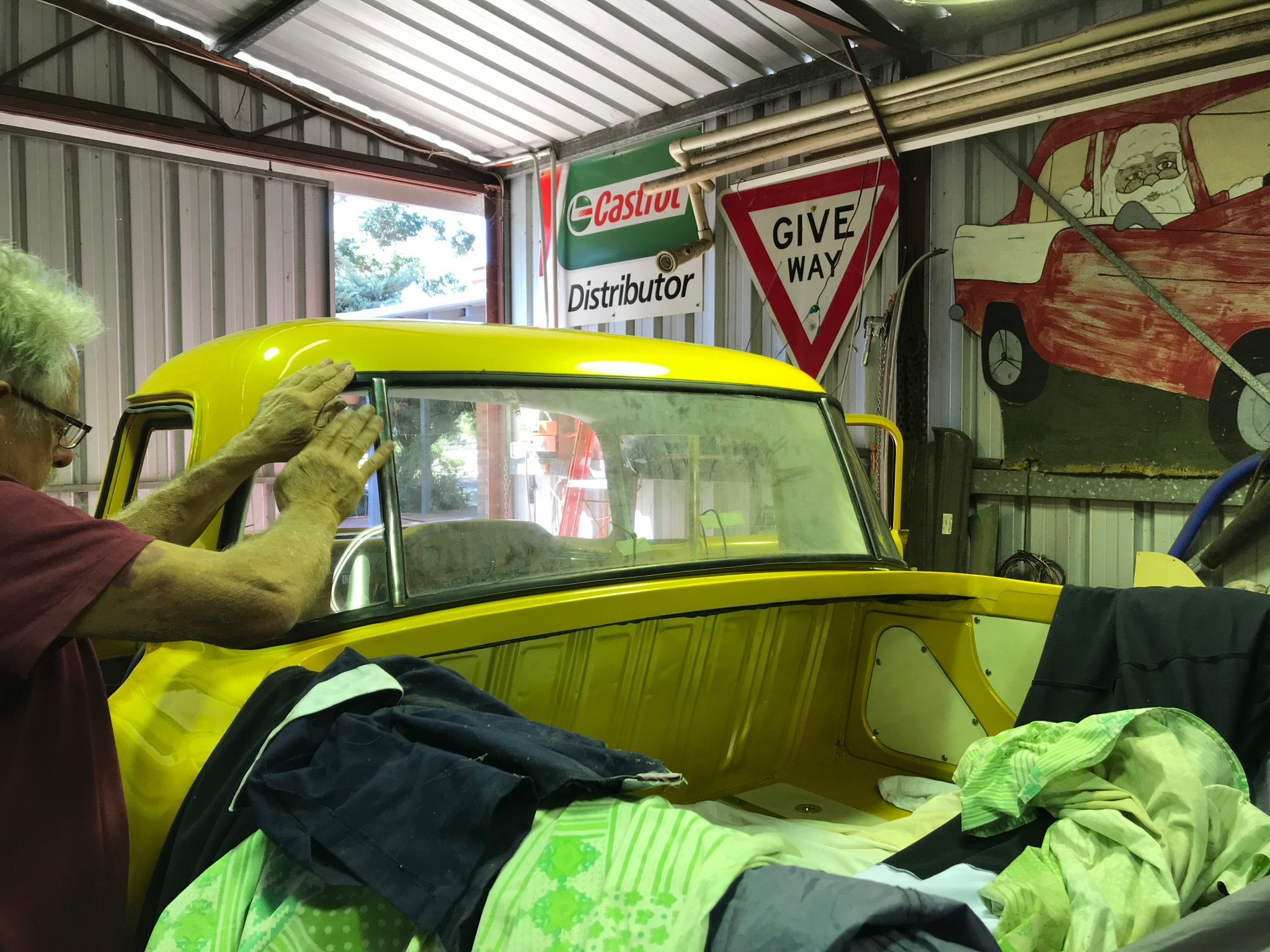

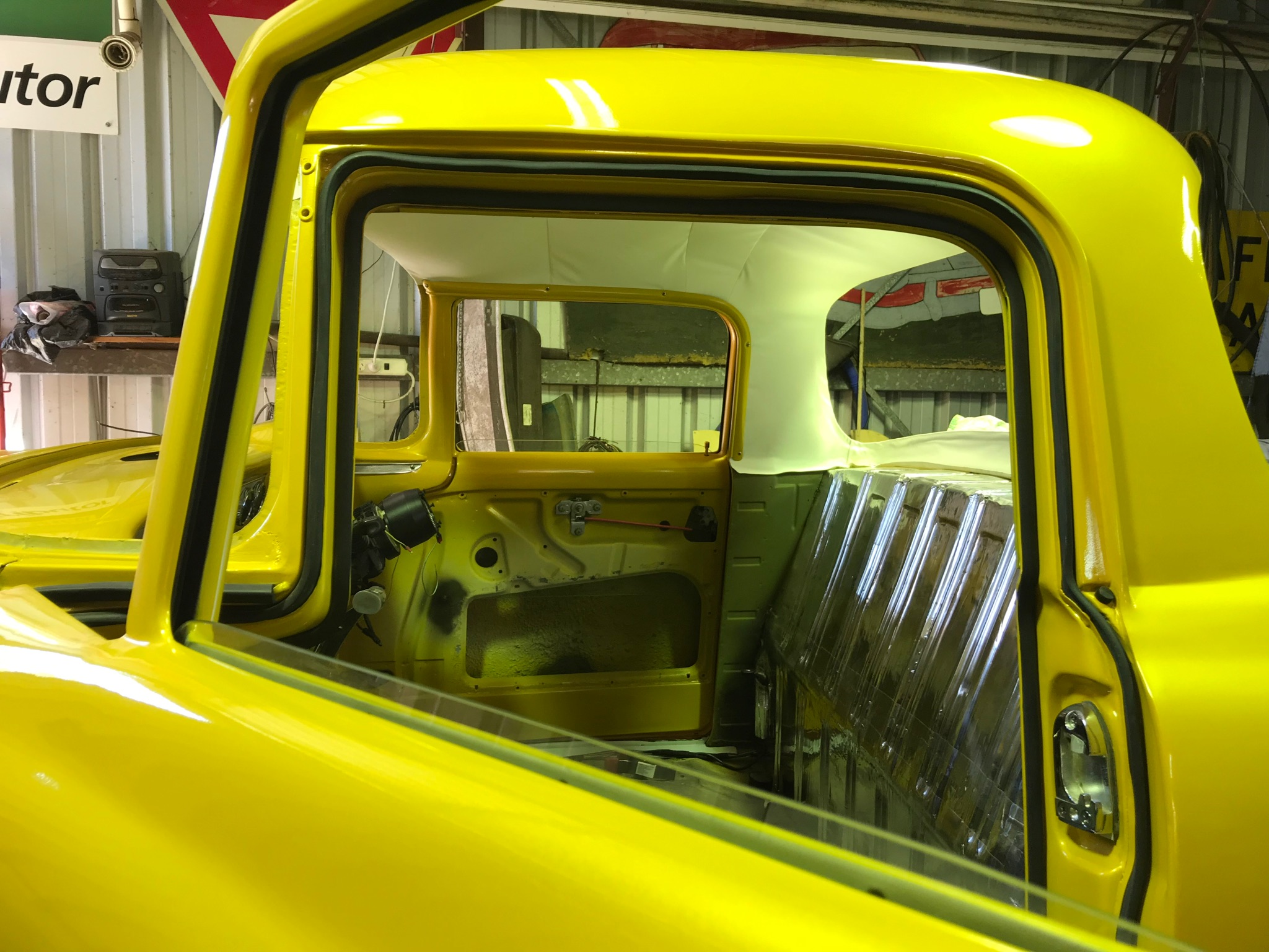

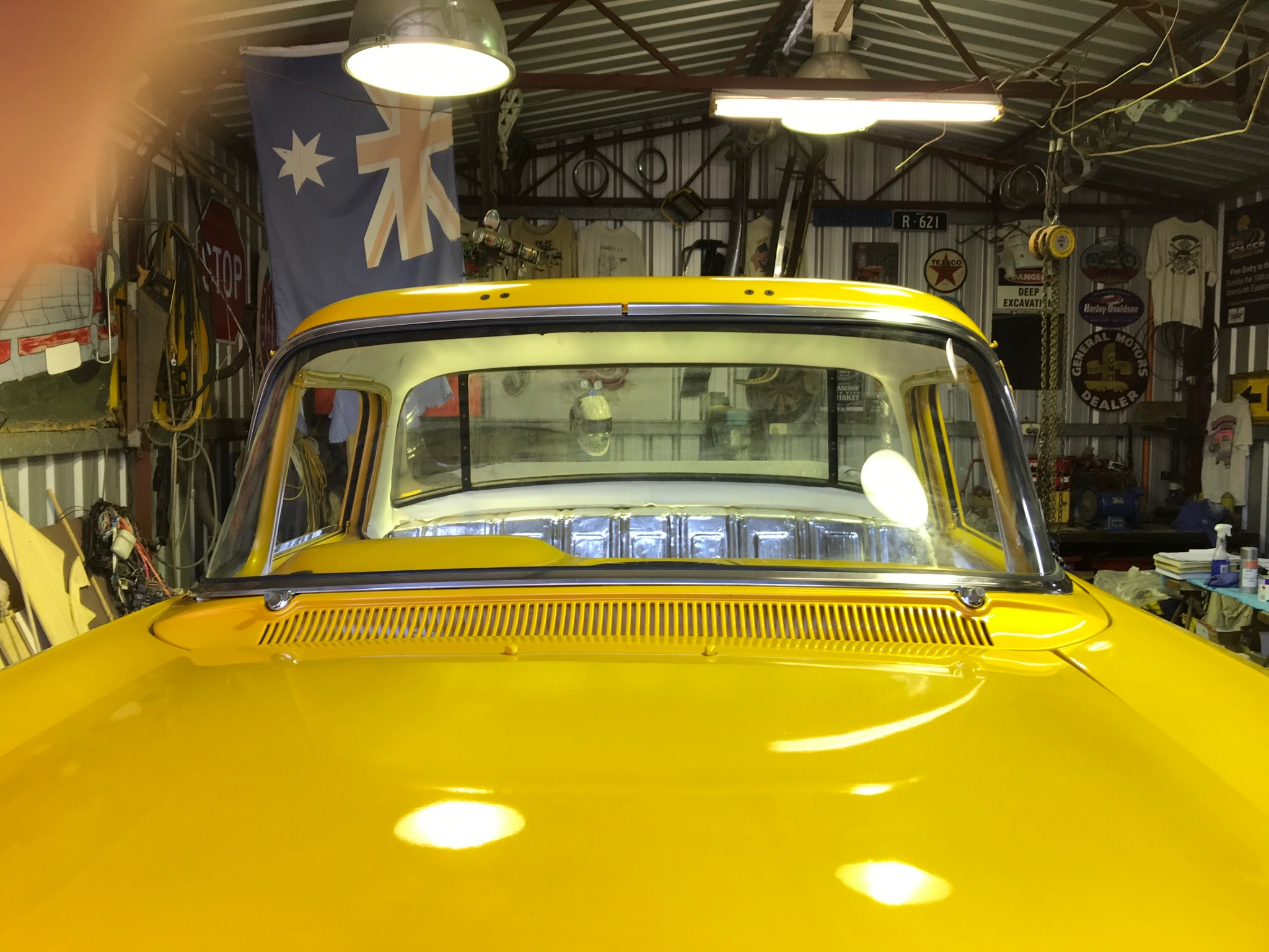

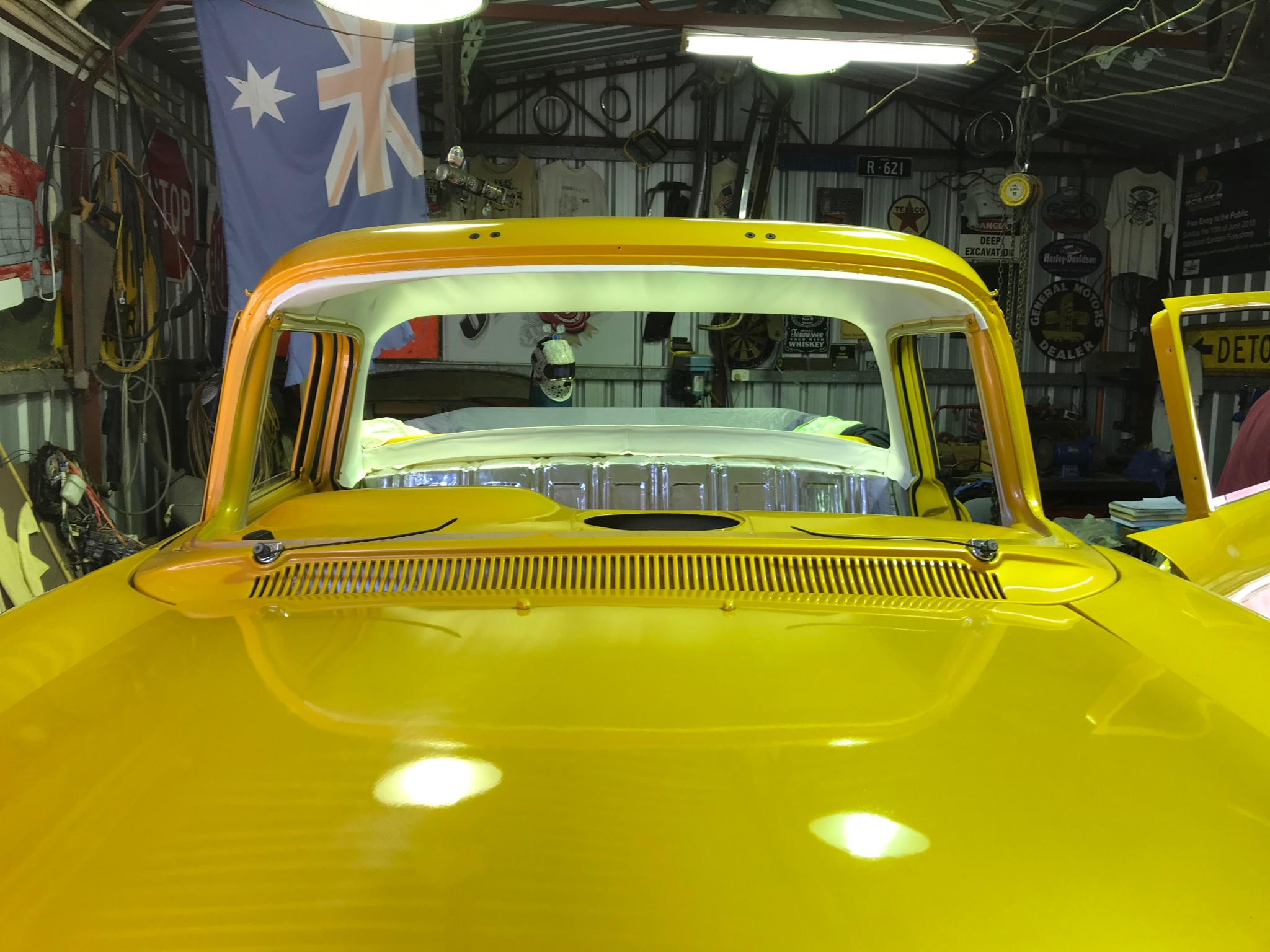

Now to yesterday and to say I'm a happy man is an understatement :ewink: Keith (retired panel shop owner) who did the body work and painted Frank and has become a good friend came down and together we installed my ebay purchased headliner and then we pulled in the front and back windscreens.
So I still have wiring to tidy up, brakes to bleed, hand brake cable to finish and interior :crazy: and I should be finished :eh: maybe 😜
Posts: 11680
Way to go Neil

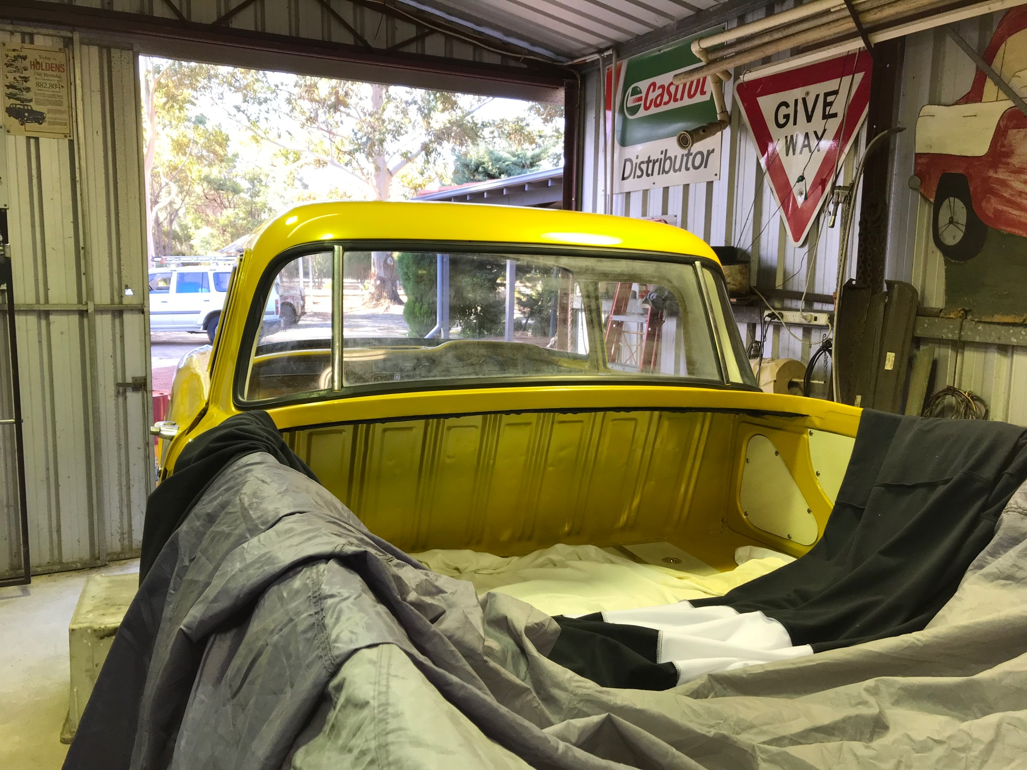

Your cargo cabin wall has me puzzled. It looks like freshly dressed steel.
Posts: 2820
Thanks Mate, cabin wall is covered in poor mans Dyna-mat l still have to finish doing the firewall and floor after tidying up the wiring.
Ok I can see it now. Great job. That’s not the underdog product? That is what I have.
