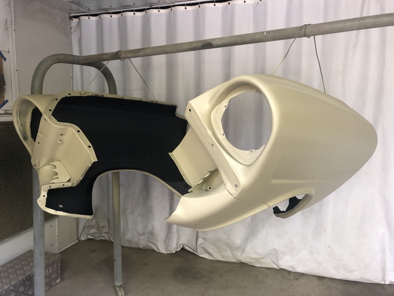

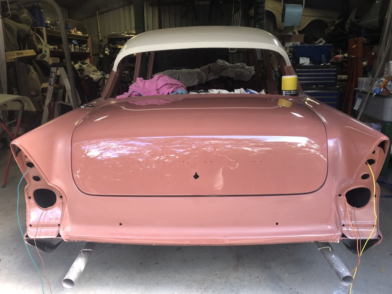

Epoxy and stone guard today
More tomorrow !!

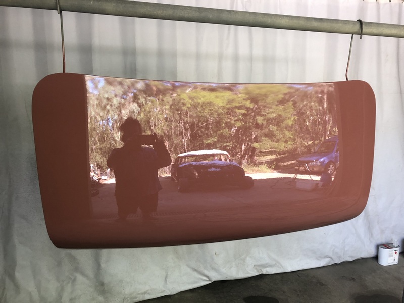

Painted the boot lid today looks better than what it is, need to sand and buff to get the slight orange peel out but I am happy with the results so far.
The owner is lurking in the back ground waiting for it to be put back on !!!

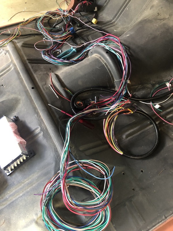

Been plugging away slowly,
Got some wiring done and want to finish that off this weekend.
A bit more paint, and honestly this has really slowed me heaps, just learning the ropes, shortcuts and technique.
I am satisfied with the way its coming out but boy its been a steep learning curve !!!!

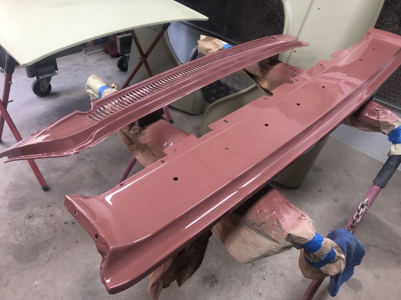

I have wet rubbed the body in prep for polishing, boot stone tray and cowl are off the gun, getting better at that as well experimenting with reducer hardener etc.
My chrome is in 2 shops at the moment and has been there since December, I keep thinking about the time this is taking and then look at the pros they seem to be snowed under as well !!!!

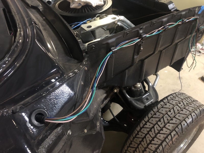

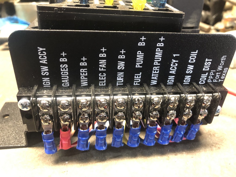

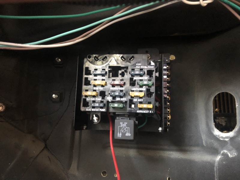

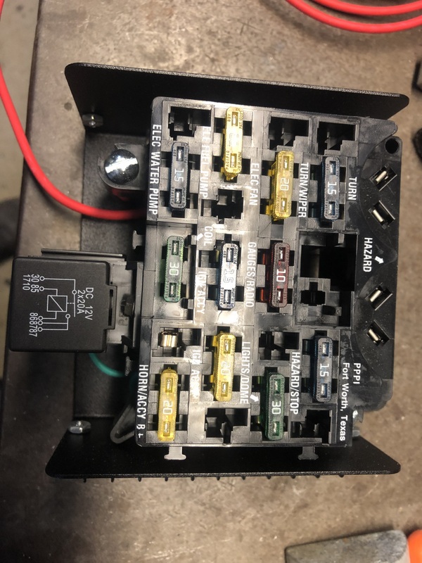

Got some more wiring done yesterday, its a bit messy at first but once you start running everything its not so bad.

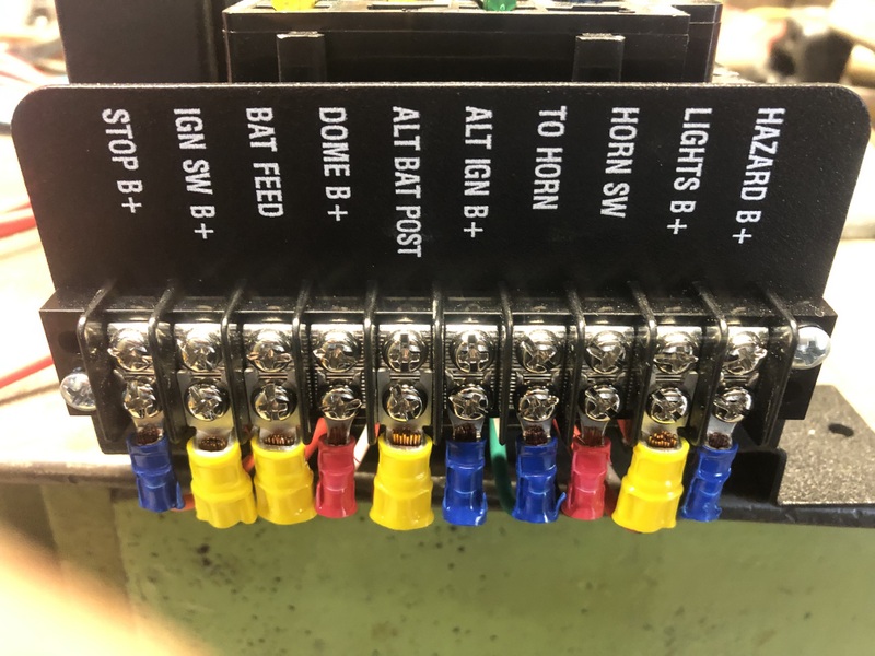

So I used a painless wiring fuse box (expensive but easy) and I bought a loom off ebay that pretty much does everything I need. Just a word of warning the non painless wiring looms are designed for left hand drive which suited my fuse location but there will be a couple of wires that end up short because of the steering column opposite location.
I also need to have the computer for the injection spliced in with a couple of triggers so I decided to mount that under the passenger seat, there is enough loom with the holley kit for that location.
