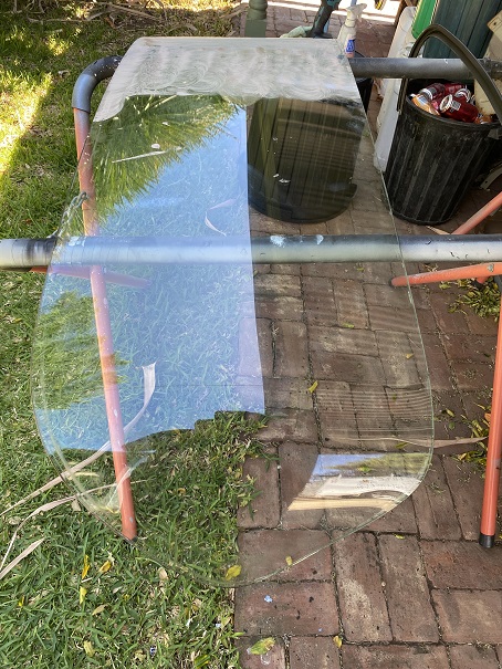

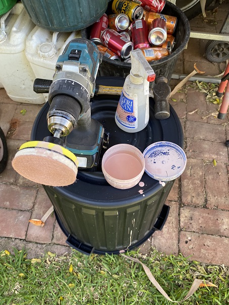

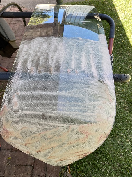

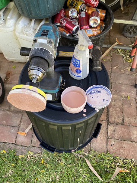

On close inspection it has wiper scratches on both sides so I decided to polish the glass, using cerium oxide and water.
polish 1.JPG (158.49 KiB) Viewed 9283 times
polish 2.JPG (172.27 KiB) Viewed 9283 times
polish 3.JPG (163.13 KiB) Viewed 9283 times
After an 30 minutes on the drill, I cleaned to glass but the scratches were still there
It did work to a degree as I have smooth glass and less scratches.

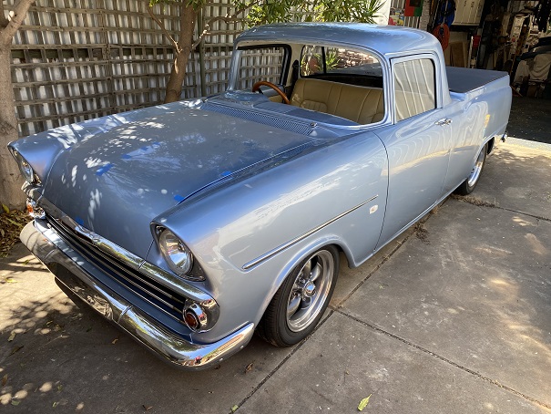

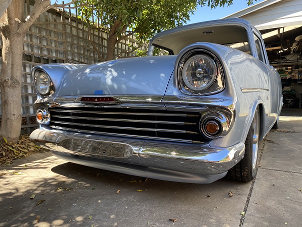

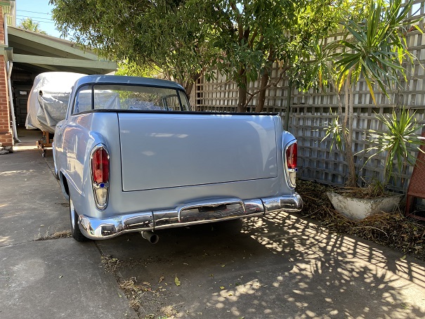

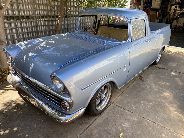

I decide to have a cleanup in the shed as I have stuff everywhere, so I push the ute outside.
First issue is the front is too low as I had little steering before the tyres rub but love the stance.
Body 3.JPG (150.85 KiB) Viewed 9227 times
Body 4.JPG (156.94 KiB) Viewed 9227 times
Body 2.JPG (172.27 KiB) Viewed 9227 times

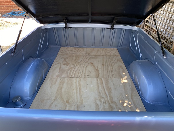

I have a blue outdoors carpet for the tub.
Body 7.JPG (99.24 KiB) Viewed 9227 times

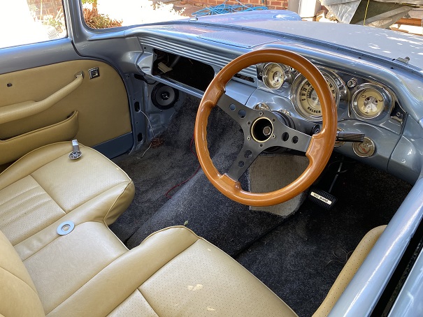

Finally got the power windows wired and the door cards installed.
Body 5.JPG (137.94 KiB) Viewed 9227 times

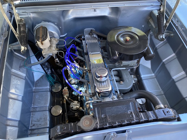

Also made a air cleaner as that is the right size.
Body 6.JPG (140.97 KiB) Viewed 9227 times

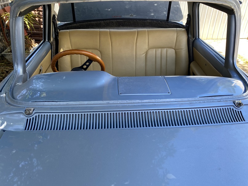

AS you can see there is no centre arm rest in the Mazda BT50 seat. The upholstery guys said I did not ask him to did so he covered it over. Not happy :evil:
Body 1.JPG (172.41 KiB) Viewed 9227 times
Ammo is happy with it so far.
Re: Ammo's Ute
Posted: Mon Feb 10, 2025 11:00 am
Looking fantastic
Re: Ammo's Ute
Posted: Mon Feb 10, 2025 11:07 am
They look so much cleaner without the tailgate hinges, great work on that Roger 8) 8)

wiper motor is up near the glove box. Fitted a Commodore, using only the low speed with the switch in the ashtray.
For those who wish to do the inner hinges on the tailgate, I used the upper hinges from a wagon, cutted and modified.
