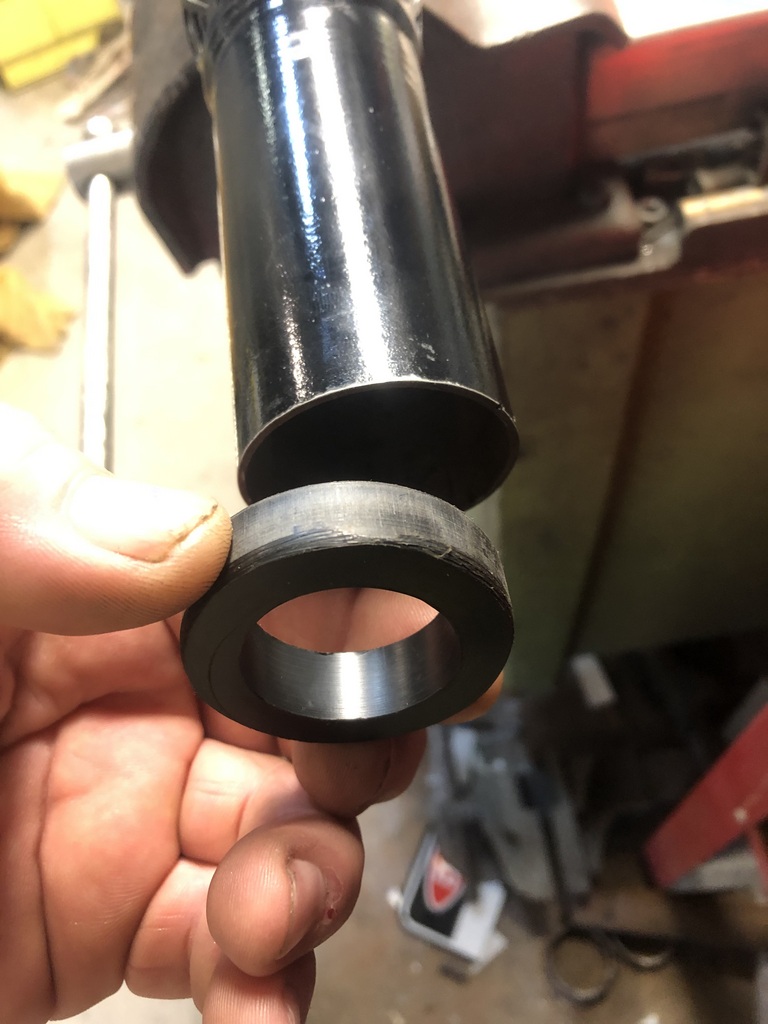

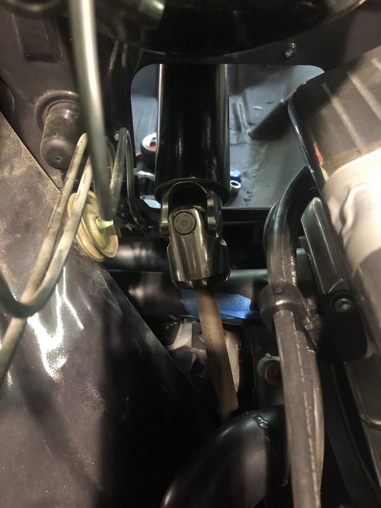

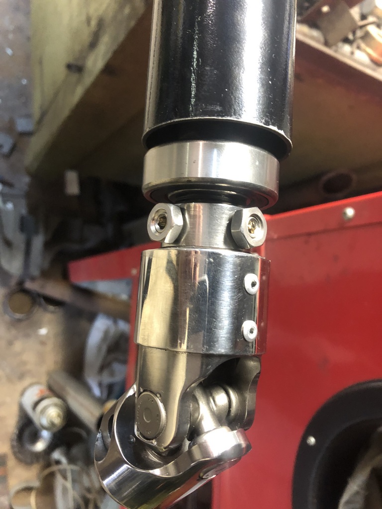

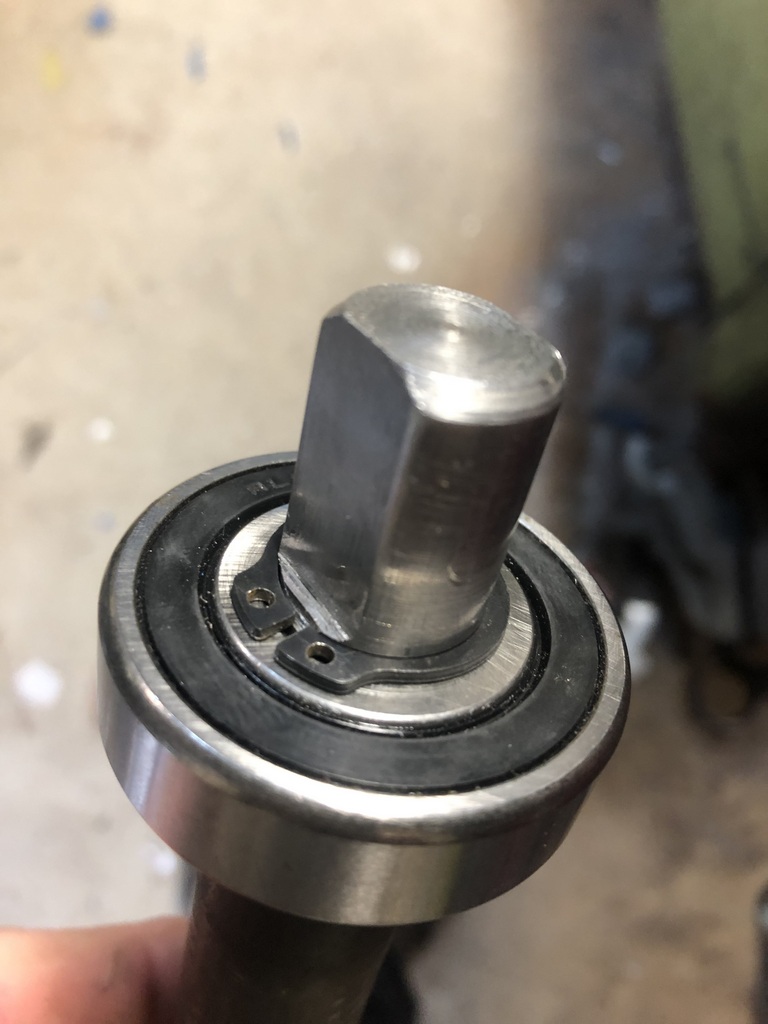

So as usual just no time for the car but I have done some things, last couple of days after work I have finished up my steering column change.
I originally used two Torana unis but have wondered about road shock considering the UC steering rack is solid mounted.
So after some research and head scratching I came up with this combo.
Borgeson Stainless vibration uni.
I machined up a bearing stopper, pressed that into the column, machined the steering shaft to suit the Double D uni and bearing, then slid that inside the shaft and locked it in position at the steering wheel end (circlip) I planned to cut the excess off the column tube but I figure this may protect the rubber part of the joint from heat.

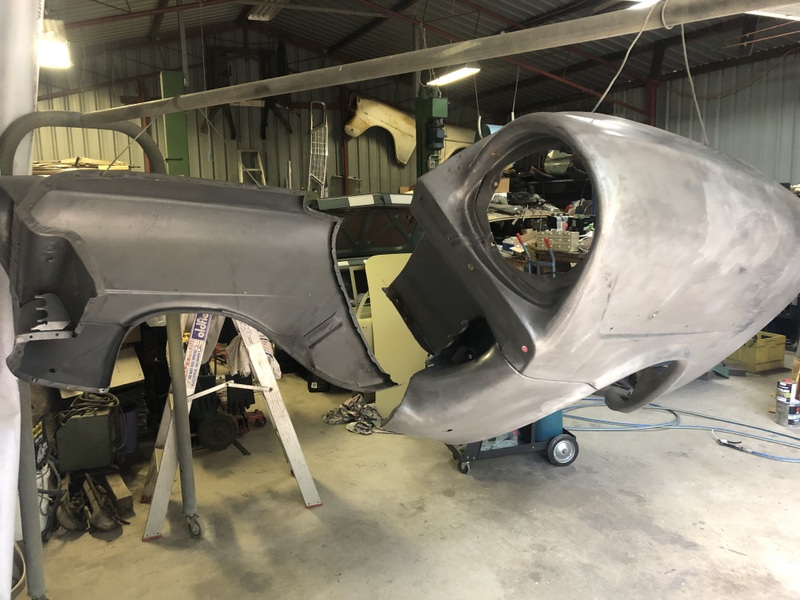

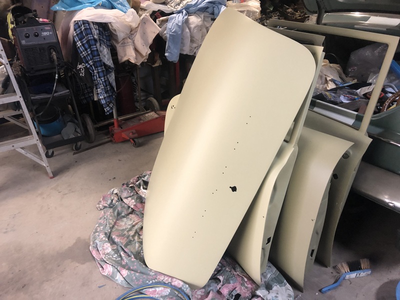

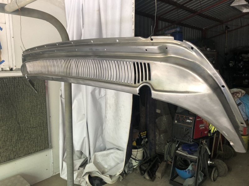

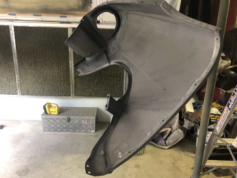

Anyway a bit more done and I have also prepped 3 doors and the boot for paint. All my chrome is being done and I should have that back soon.

That looks a lot neater than the Torrie rag joints.

With the DD uni I had to move the around a bit the clear the pugs and headers

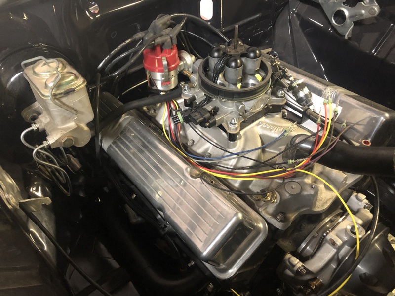

Bit of an update, acid dipped panels, completed in hifill all but one door and a bit of wiring !!!!!!!!
Also finished accelerator steering and brakes so vroom vroom soon !!!!
Will try and start this motor shortly !!!!

Posted: Thu Apr 11, 2019 11:07 pm
Those panels look very nice. Mind the duco on the Stude mate.
