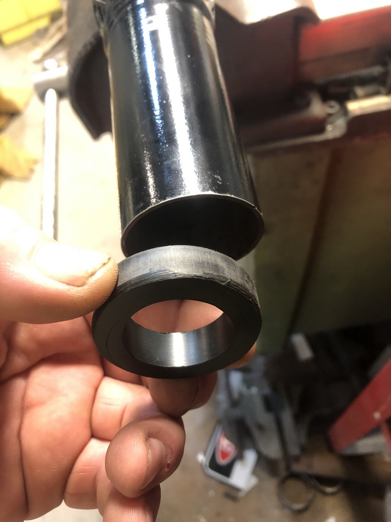

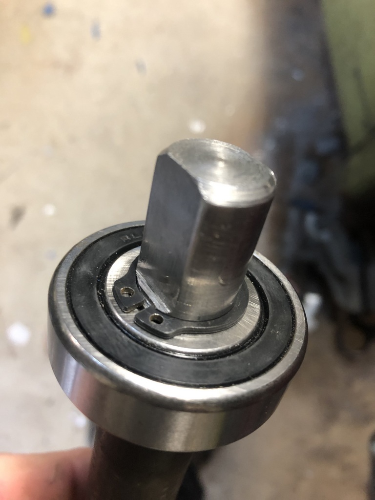

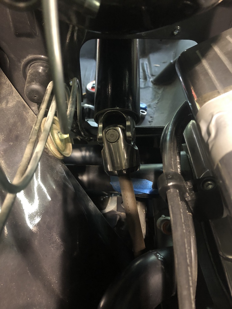

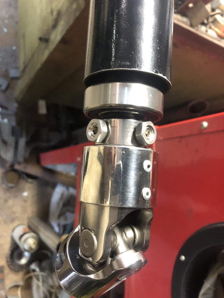

So as usual just no time for the car but I have done some things, last couple of days after work I have finished up my steering column change.
I originally used two Torana unis but have wondered about road shock considering the UC steering rack is solid mounted.
So after some research and head scratching I came up with this combo.
Borgeson Stainless vibration uni.
I machined up a bearing stopper, pressed that into the column, machined the steering shaft to suit the Double D uni and bearing, then slid that inside the shaft and locked it in position at the steering wheel end (circlip) I planned to cut the excess off the column tube but I figure this may protect the rubber part of the joint from heat.

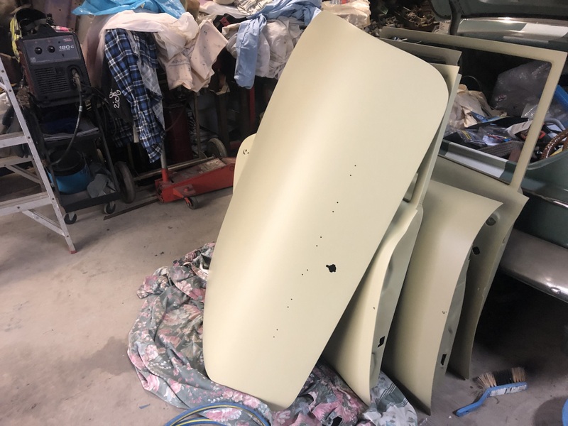

Anyway a bit more done and I have also prepped 3 doors and the boot for paint. All my chrome is being done and I should have that back soon.

Posts: 5729
Re: Chev EK
That looks a lot neater than the Torrie rag joints.

With the DD uni I had to move the around a bit the clear the pugs and headers

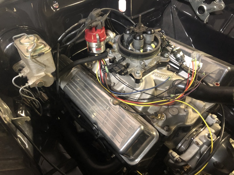

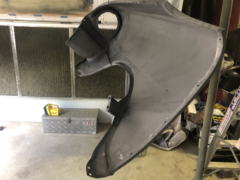

Bit of an update, acid dipped panels, completed in hifill all but one door and a bit of wiring !!!!!!!!
Also finished accelerator steering and brakes so vroom vroom soon !!!!
Will try and start this motor shortly !!!!

Those panels look very nice. Mind the duco on the Stude mate.
